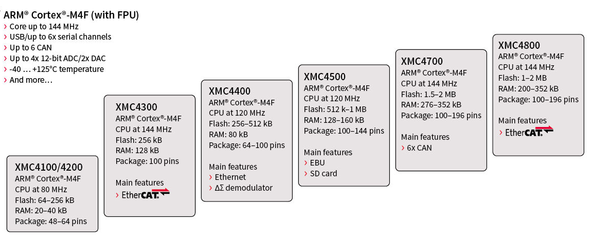

I was going to answer each point but that would keep the whole thing "Acedemic" The problem with being Acedemic" is you never actually get to the recovery part - there is always some reasoning where this or that method is better or worse than some other method.
Plus you are making the mistake of thinking flash memory storage is just like any other electronics, and engineers would do what islogical or what makes sense.
There is flash memory on probably all controllers, and I am surprised you didnt just look around for any datasheets to have a look what flash controllers are: basically a mini-pc that runs code. I would be surprised if the WASN'T flash on a controller. The many tools from dodgy parts of the net such as flashboot.ru specifically are designed to update controllers.
I know these come in many configurations, but
anyway, I will go into it a bit more..
Flash memory controllers, and flash memory itself, are/is just regular electronics. They're just (in this case at least) multicore microcontrollers with w/ a handful of SERDES, a DDR interface, a bunch NAND controllers, and some GPIOs on them. You're right, I should have looked at a few of them and I'd see that flash is present on a bunch of them. I guess for the volume they're made it, it makes sense.
Understanding the theory of operation of any of these things can only be of help to anyone trying to recover data from them.
