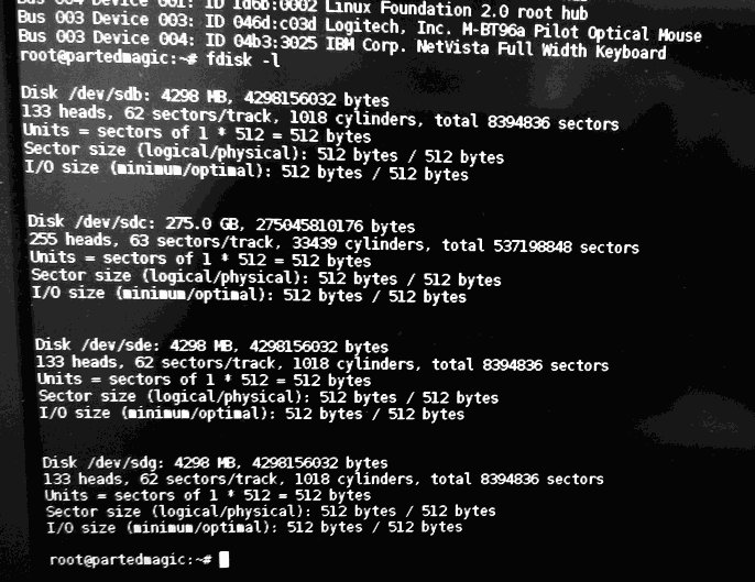

We received a "no name" monolith USB flash drive, which according to the customer is a 16 GB one.
Below are several pictures.

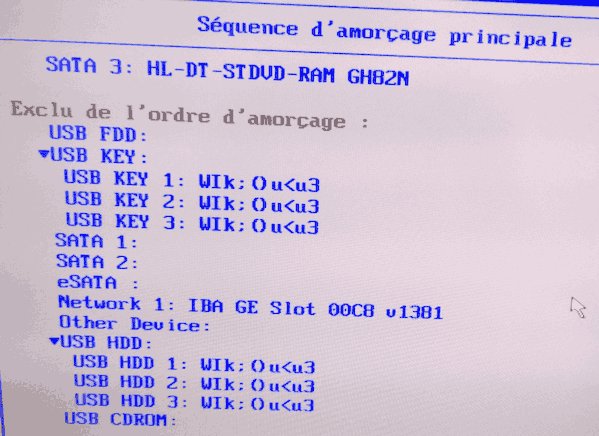

In the BIOS, it appears as three different storages.
For this flash drive, "fdisk -l" lists three 4 GB volumes for that drive : sdb, sde and sdg
as well a sdc which has an absurd capacity of 275 GB.
All /dev/sdX "partitions" can be cloned without problem and hex analysis shows non-null content in them.
However, analyzed individually, there show no files.
/dev/sda is not listed but appears as 2 TB when cloned.

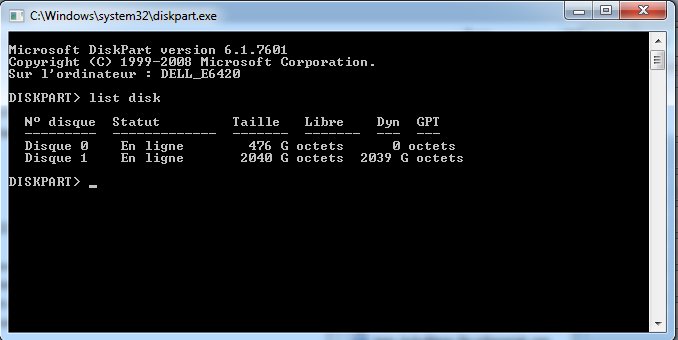

In Windows, both the disk management and diskpart show the flash drive as a 2 TB disk without any partition.

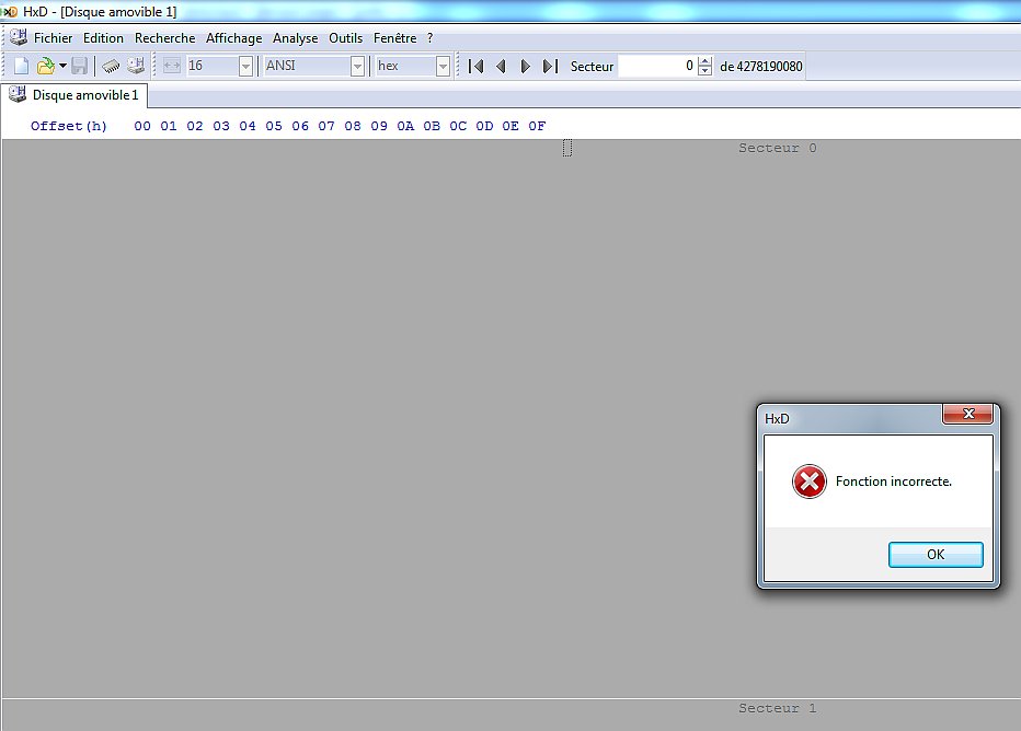

Opening the flash drive in Windows with the hexadecimal editor HxD, this one shows the first sectors as unreadable with a grey background.
Additionnally, there is an "Incorrect function" popup.

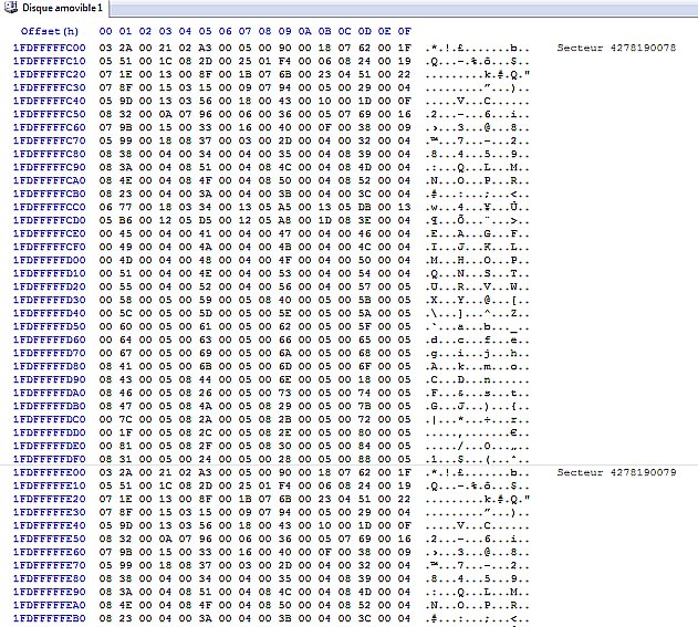

HxD also sees the flash drive with the erroneous capacity of 2 TB (4278190080 sectors).
From within HxD, it is possible to access the sectors near the impossible location of 2 TB.
The last sectors show identical content, which doesn't seem random.
Maybe is this the XOR key applied to blank sectors?

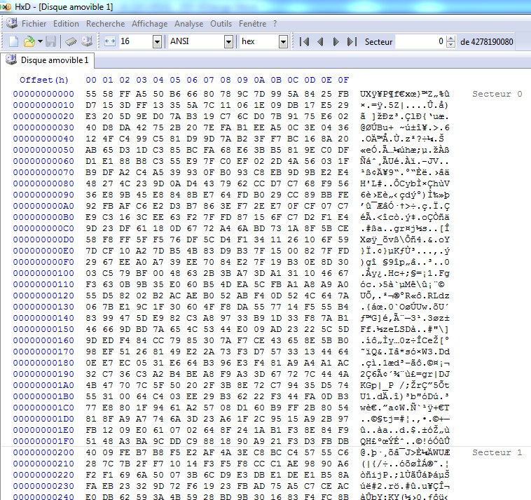

"Rewinding" the sector offset to explore content up to the first sectors shows non-null content in all the 2 TB space.
Sectors 0, 1, ... show something, contrarily to just after opening the drive.
In HxD, the "Incorrect function" popups shows appear, but sectors are still accessed.

File comment: As viewed by fdisk -l in Linux.
File comment: First sectors of the flash drive viewed in HxD.
File comment: View of the flash drive from the BIOS.
File comment: Last sectors of the 2TB storage as viewed by HxD.
File comment: Initial view of the 16 GB flash drive in HxD.
File comment: With DISKPART in Windows Terminal.

have you tried scanning with partition find and mount, or imaging the whole disk (not partitions) with DMDE and scanning with r-studio?
if the controller goes haywire, you wont get sense from it in win or *nix
 Post subject: Re: 16 GB monolith showing 2 TB capacity
PostPosted: June 16th, 2019, 13:01
Posts: 2857
@SOSdonnees , this is typical Controller (not stable) issue there is NO WAY to read it, and if you squeeze it more with reading it will not mount
you have to do it the hard way (if your client is willing to pay)
@HaQue , dump it & scan it will not do any good, you will not find anything useful/working
