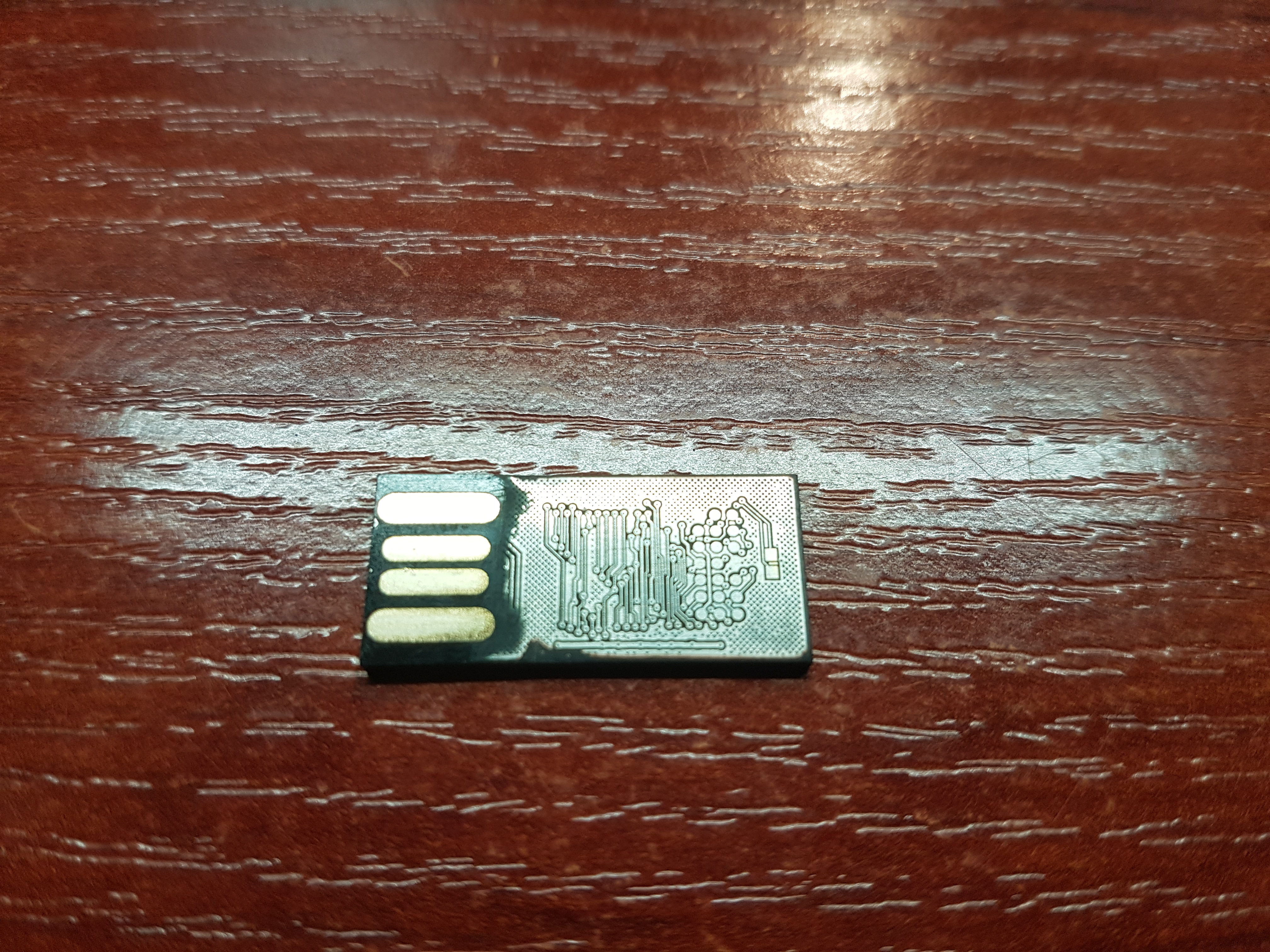

Hi everyone,
One of my colleagues brought to me 8GB Kingston DTSE9 monolith USB memory. The system did not see it. I removed the upper coating and got access to the copper layer. I have searched the net but I could not find the right pinout scheme. Maybe some of you had already same problem and could assist. Thank you in advance for your help.
Mariusz
File comment: Copper layer of 8GB Kingston DTSE9 monolith USB memory

May I ask, which flash recovery tool are you planning to use with this device?
Soft Center? PC3k Flash? VNR?
It’s a pretty common pinout and readily available from the above developers.

I was going to use PC3k Flash, but I could not find this scheme on http://www.pc3000flash.com/solbase/mono ... 8&lang=eng.
Would you be able to assist ?

A common failure on this model is the fuse blowing.. measure +5 to GND for resistance, if there is none it is a blown fuse, fix it accordingly :-)

If you know the location of the uncovered V+ pad (B), then measure its resistance to the corresponding pin (A) of the edge connector. No need for a laser.
However, before bridging the fuse (F), I would first confirm that there is no excessively low resistance between V+ and ground.
                  controller
           F      .---------.    .------.
       A  ___  B  |   .----.|    |      |
+5V o--+-|___|-+------|3.3V|---+-|      |
       |       |  |   |reg ||  | |      |
      ---      |  |   '----'|  | | NAND |
Gnd o--+       |               |
      ===     --- capacitors  ---
      GND      |               |
              GND             GND
The above diagram is for a USB flash drive, but the principle is the same.

You don't need an X-Ray, its very very easy to guess where the fuse is..
The question is how to get into the monolithic chip easily, perhaps a CNC machine???
