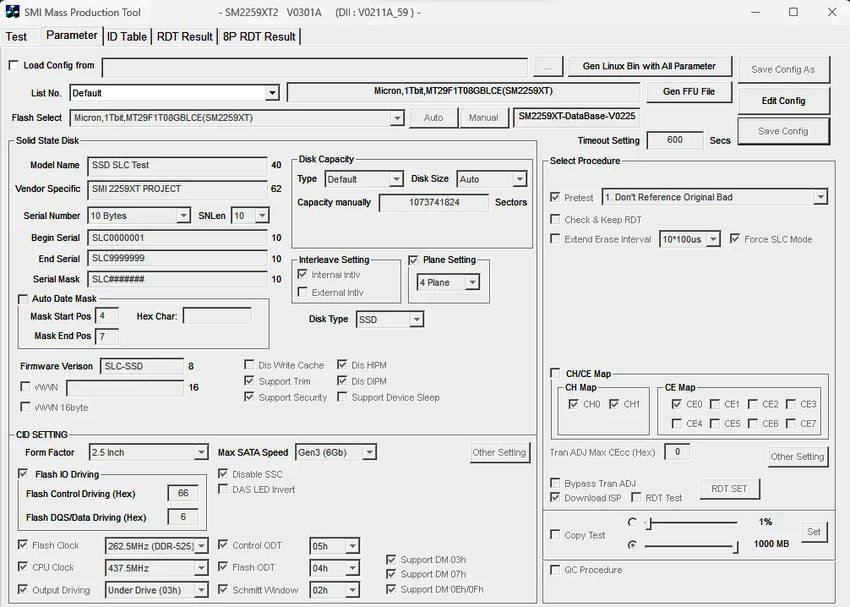

Some enthusiasts working with SSDs have found a way to change the firmware to p(SLC) Mode, which is very easy to do during production, but why isn't it being done?

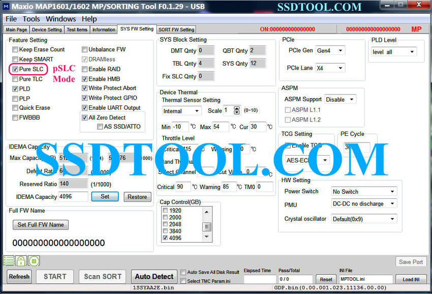

Request to the Moderator: I was unable to attach images to my post correctly so that they would be displayed in the same size. Please delete the duplicate question and add direct links to the images.
1)https://www.backblaze.com/blog/wp-content/uploads/2018/03/StorageReview-Intel-DC-S3500-SSD-Circuit-Board-Top.jpg
2)https://theoverclockingpage.com/wp-content/uploads/2024/03/image-37.png
3)https://ssdtool.com/MAP1602.jpg
Thank you.
I asked why people are not interested in p(SLC) SSDs.
They don't see the difference in reliability and only choose based on price and advertising (It's Cool, Very Cool!).
Various forums discuss a huge number of failures, data losses, and complete SSD failures during normal, non-intensive use.
Doesn't this serve as a lesson to them?
I haven't found any forums where the issue of redesigning or releasing p(SLC) SSDs is widely discussed. Why is that?
SSD (TLC) 4Tb - $350 or SSD p(SLC) 1280Gb - $350. Which would you choose if you had the choice?
