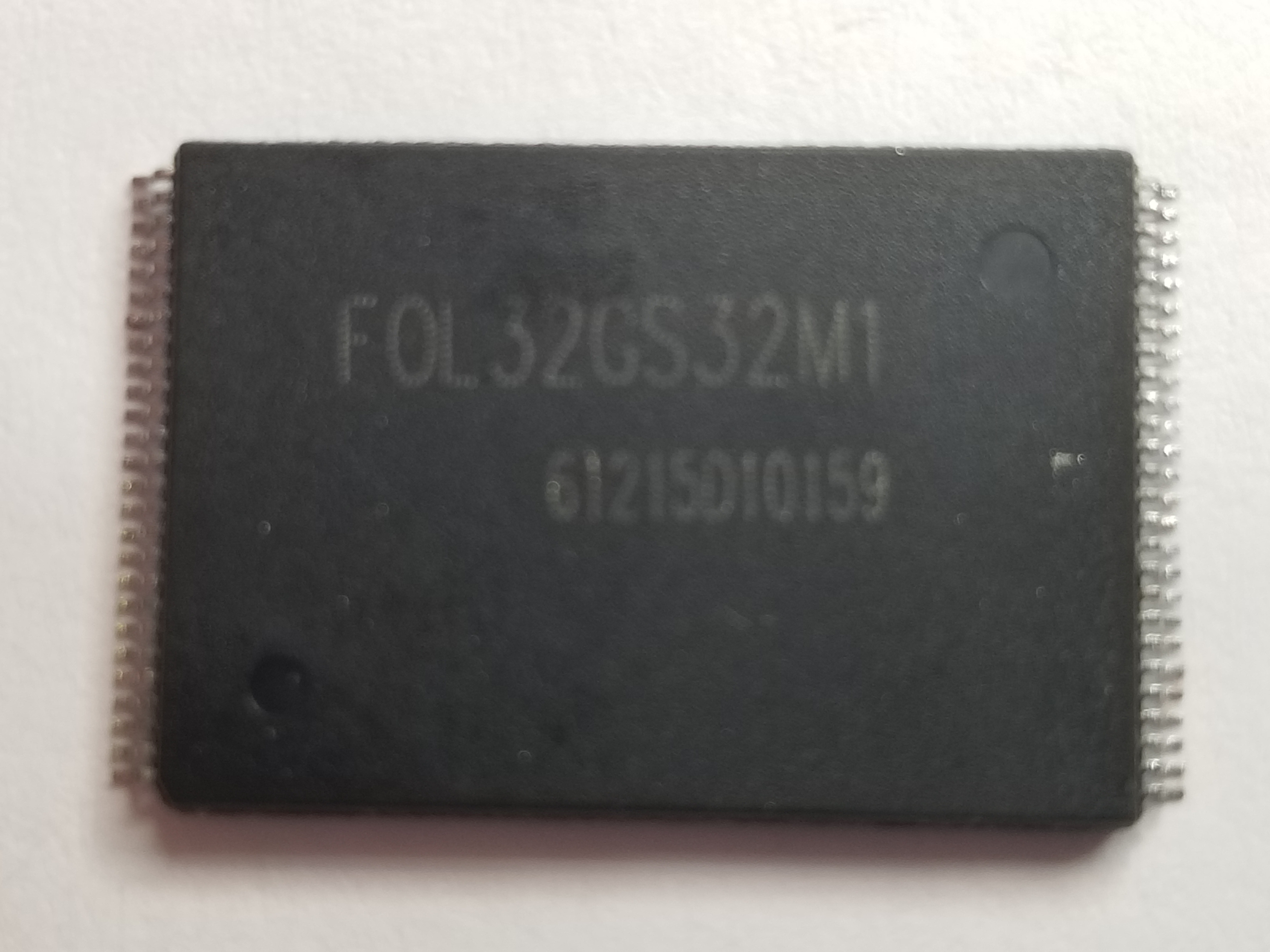

Maybe I am looking in the wrong places, but I cant find the layout for the Ultra Wide 52 pin TSOP. It's not in the ONFI specs.

I could be wrong, but I seem to remember finding out that it's just an extra unused NC pin at each corner and the rest is the same as TSOP 48.
 Post subject: Re: 52 Pin TSOP
PostPosted: February 25th, 2019, 18:53
Posts: 17230
I think the safest approach would be to examine the PCB. If the pinout for the controller is known, then it wouldn't take long to determine the NAND pinout with a little visual circuit tracing , or by buzzing the traces with a DMM in continuity mode. At the very least, determine the ground and Vcc pins. These can be identified with reference to the adjacent bypass capacitors.
PostPosted: February 25th, 2019, 21:38
Posts: 3975
Francs approach is ideal. some of these chips have a different pinout than standard, but I haven't come across any that I could find datasheets, or info on the web about to say anything concrete. Also they could be TSOP-56 with the 4 outer pins missing, or left off by design. http://www.flash-extractor.com/manual/adapter_tsop_56/
I agree with Jared, Probably tsop48 though
really not sure why vendors stray from standard.. especially when they actually make the chip bigger than it needs to be, or for no apparent reason.
possible that really cheap and nasty outfits buy bare silicon chips that did not pass QA from a major vendor and repackage them with retrofitted packages or worse "homemade" moulds.

notice the Pin1 mark is in the wrong corner. What is marked on PCB, any chance of a photo of the PCB?

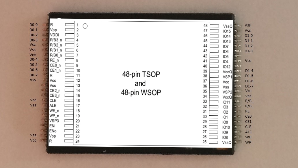

PostPosted: June 20th, 2019, 18:30
Posts: 17230
lcoughey wrote:
AIUI, you did this ...
I'm stunned that the chip survived. :shock:
