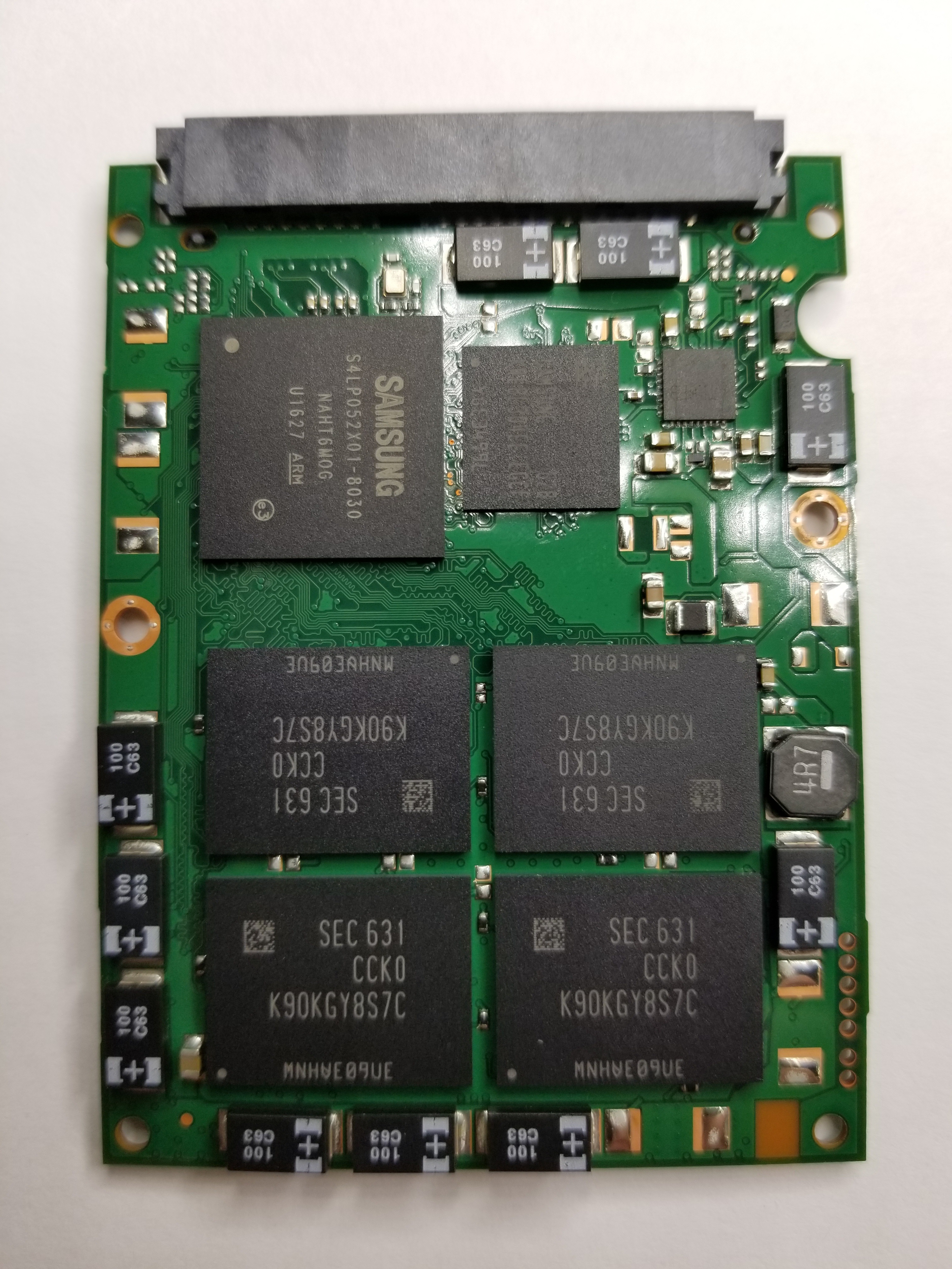

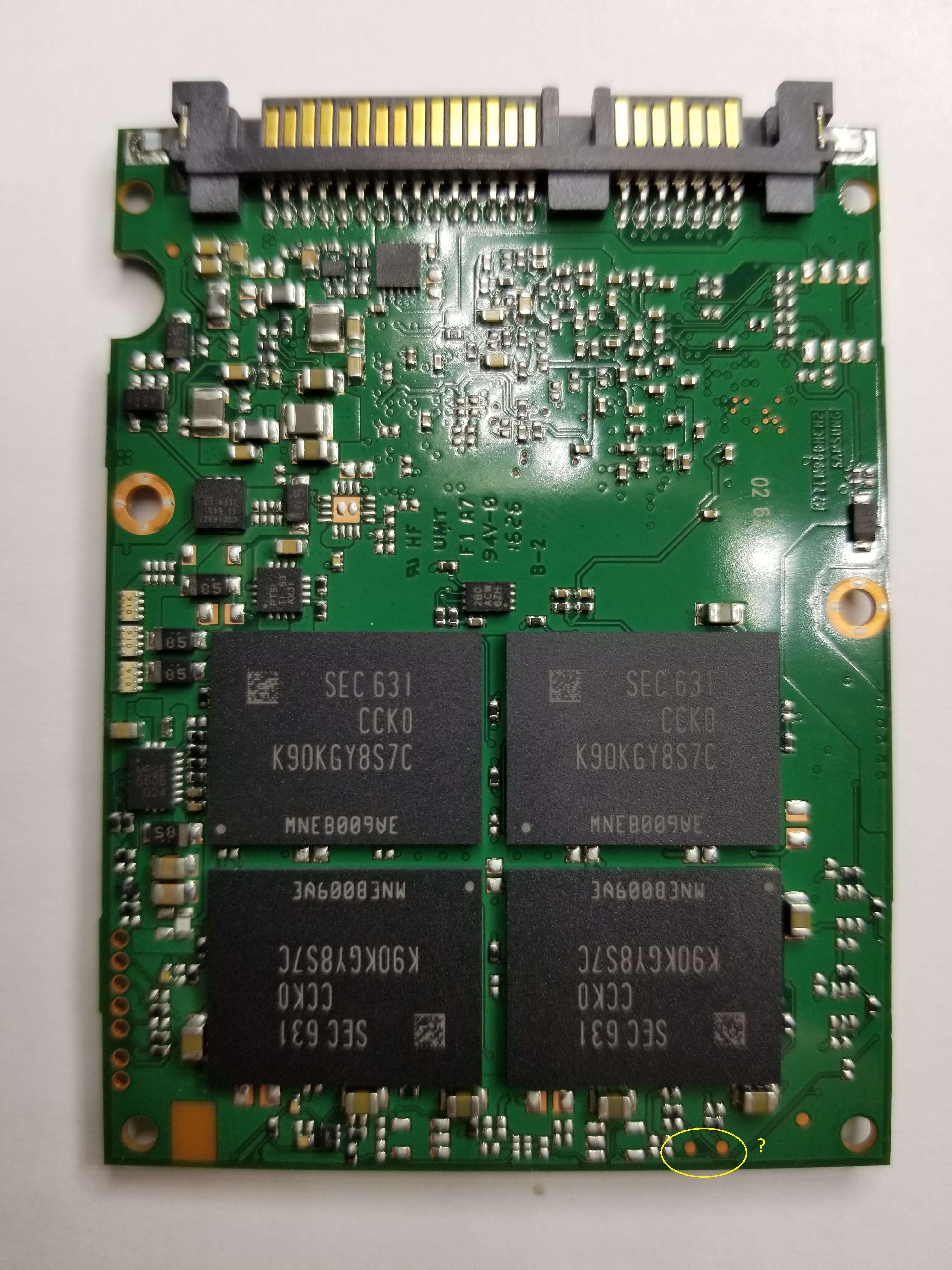

Anyone know/confirm where the terminal connections are on this Samsung EVO 840?

I can only see the JTAG pins.
The pins you have marked with a question mark look more like test pins to me than UART pins, the UART pins have always been through-hole on the Samsung SSDs I have seen but hose are just SMD points, so I think Samsung could not plug in their UART connectors into those pins. Perhaps they have given up on the UART interface completely, since it's pretty useless with most of the firmwares I have seen anyway.
Which voltages do you measure on those 2 pins?
I guess you can only use JTAG interface with this model then.

That line of 7 test points looks like it consists of two groups -- a group of 5 and a slightly offset group of 2. Can we be certain that those 2 test points are the SAFE mode shorting pins?
 Post subject: Re: Samsung EVO 840 Terminal Connections?
PostPosted: June 28th, 2019, 5:47
Posts: 205
Location: Vienna, Austria
Yes, those 5 pins are the JTAG and the other 2 next to them are the SAFE mode. Exactly the same pinout as on the EVO840

840 Evo uses the MEX controller whereas PM863 uses the Mercury controller. If the tool is reporting that it has found a MEX controller, then how can it be expected to work correctly with your SSD? Perhaps this is why no CP can be read.
AFAICS, the PM863 is not supported:
https://blog.acelaboratory.com/pc-3000-ssd-list-of-supported-ssd-drives-regularly-updated.html

Samsung 960gb pm863 SSD :
https://groups.google.com/forum/#!topic/datarecoverycertification/_u9VSi1QWzQ
Heres ace response
Hello Wayne. Sorry for bad news but even in September Update I'm doubt that new loaders and new family of Samsung will appear in support list. Samsung developers starts to protect their drives with very tough encryption, and if in Samsung 840 EVO / PM851 it was possible to work through terminal, in next generation - 850 EVO / PM861 / PM871 they remove terminal interface from SSD at all. As the result we can't communicate with drive and can't reach TechnoMode on it.
I'm afraid in nearest 2 years we will not get any solution for it.
