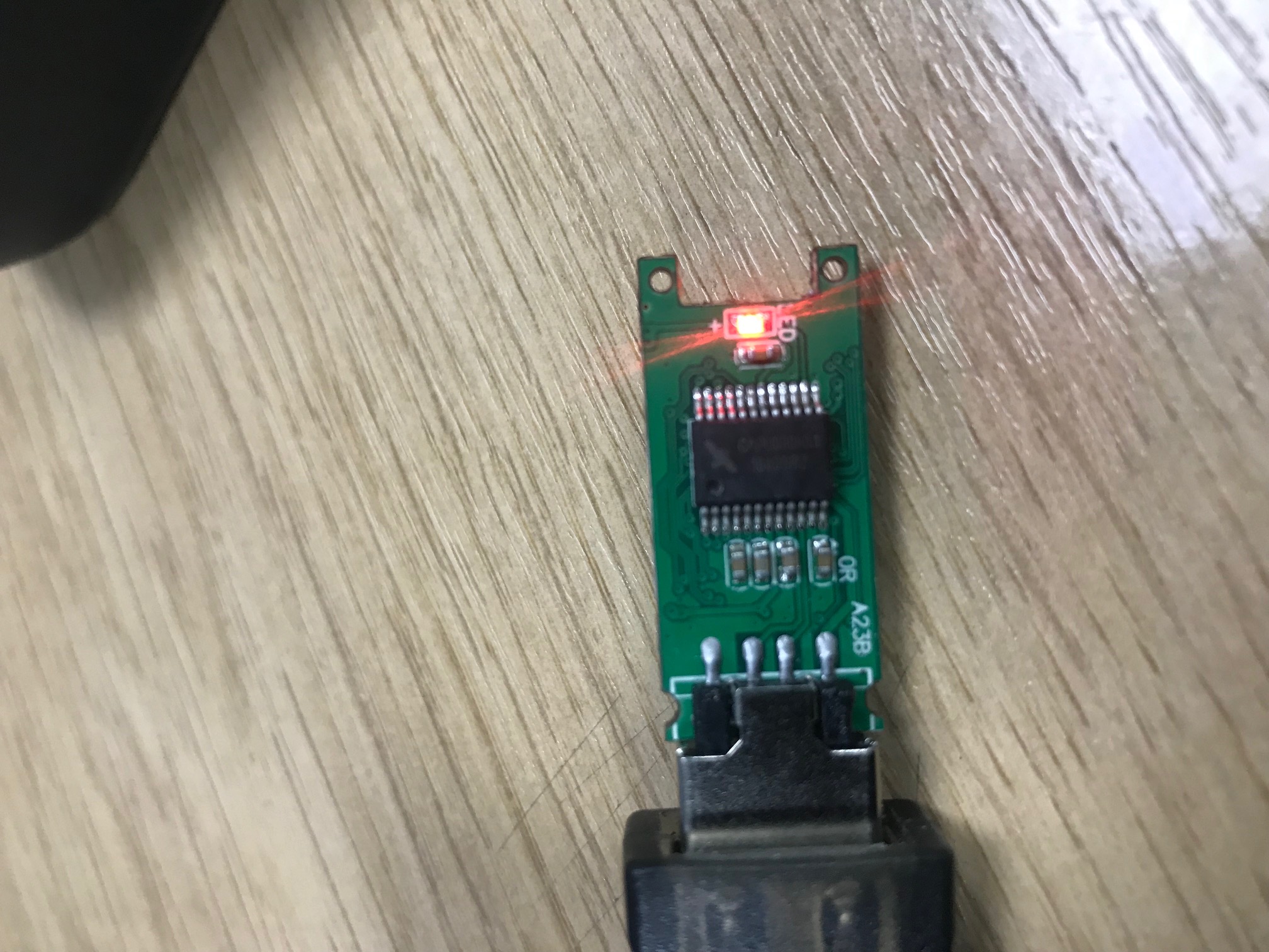

Got this THGBR2G5D1JTAI0 chip on a cheap Chinese flash.
Device just flashes the LED and does nothing.

This is the flash device...
(Sorry I should also have said, the NAND is a TSOP48 package)...

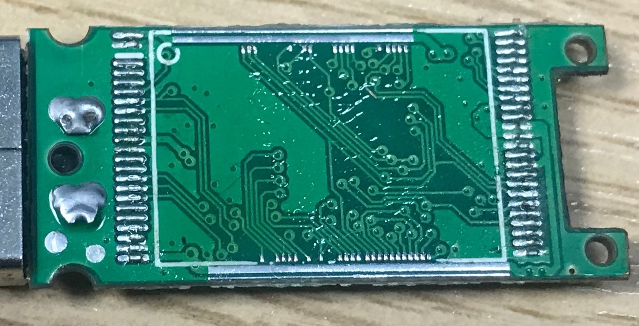

Also if you look on PCB and identify ground and VCC and find which pins are GND and VCC on nand, which are they?
If you have device there, can you do a good pic of both sides?

Look on traces/vias near TSOP48 pads. It could be completely in other place than TSOP48 NAND pinout should be.

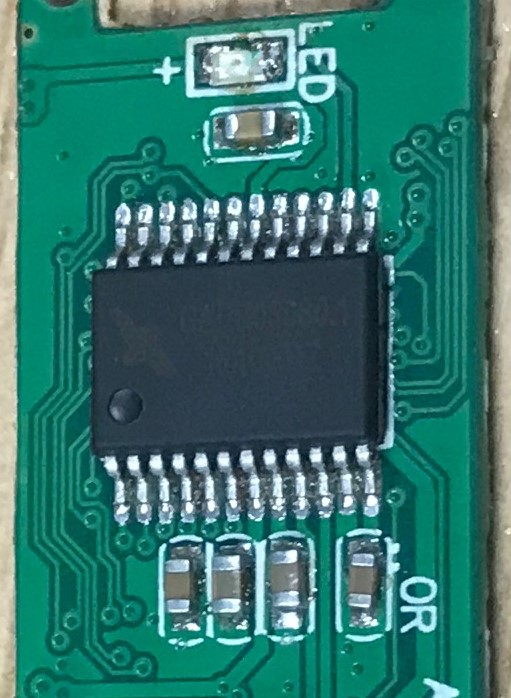

sorry to ask but any chance of a nice pic of top of controller? I don't recognise logo and cant find any reference to it or numbers, apart from generic Chinese site with like a million numbers.
this is the closest I can find, but don't think it is it

 Post subject: Re: SmartNAND recovery?
PostPosted: July 2nd, 2019, 11:55
Photos...
PostPosted: July 2nd, 2019, 23:27
Posts: 17230
AppoTech Ltd:
http://www.appotech.com/
https://www.usbdev.ru/files/appotech/
https://www.google.com/search?q=%22b-reade%22%20controller
