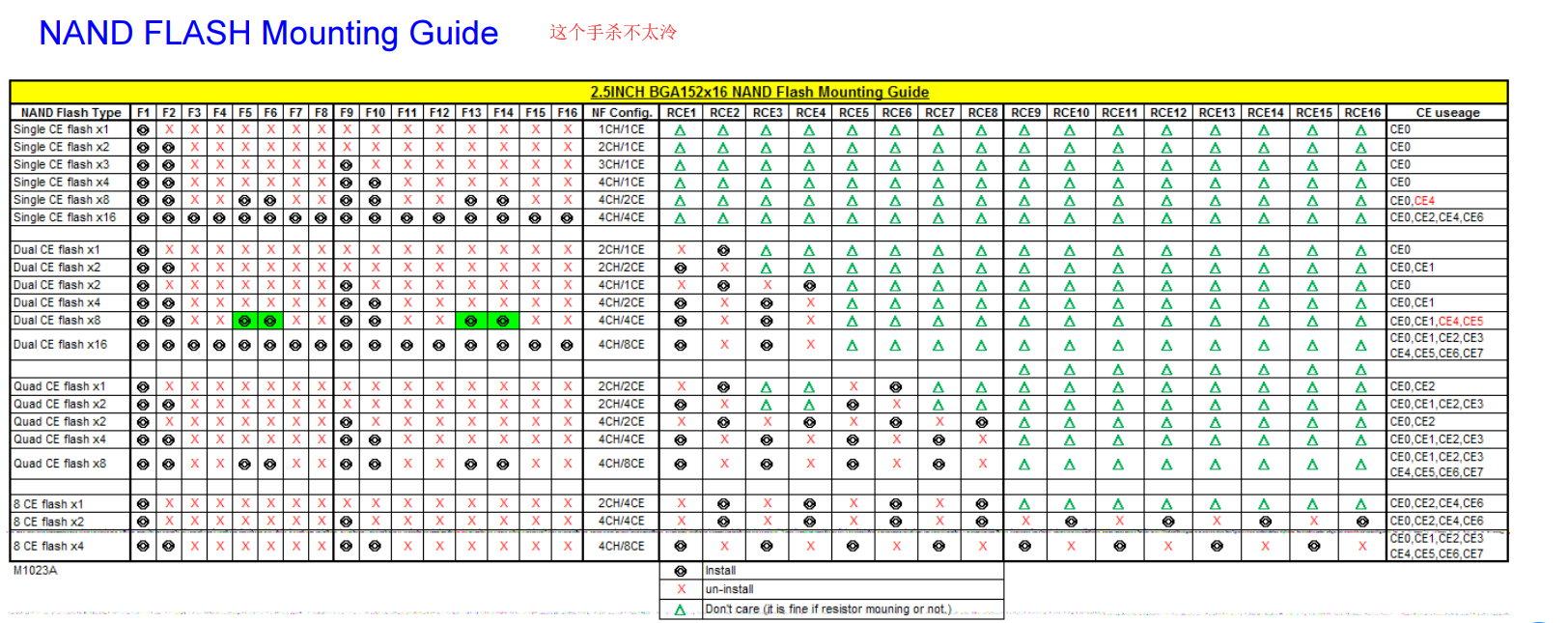

Someone wants me to give Nand flash muting guide in the second video, so I'll publish it. But my spoken English is not good, so I can't translate my video into English. If you don't know something, please leave a message in this post. I will try my best to help you.
