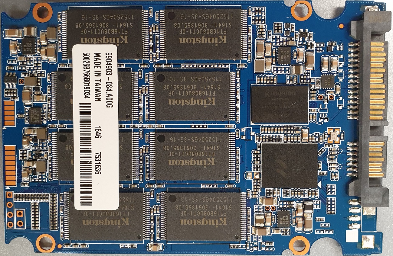

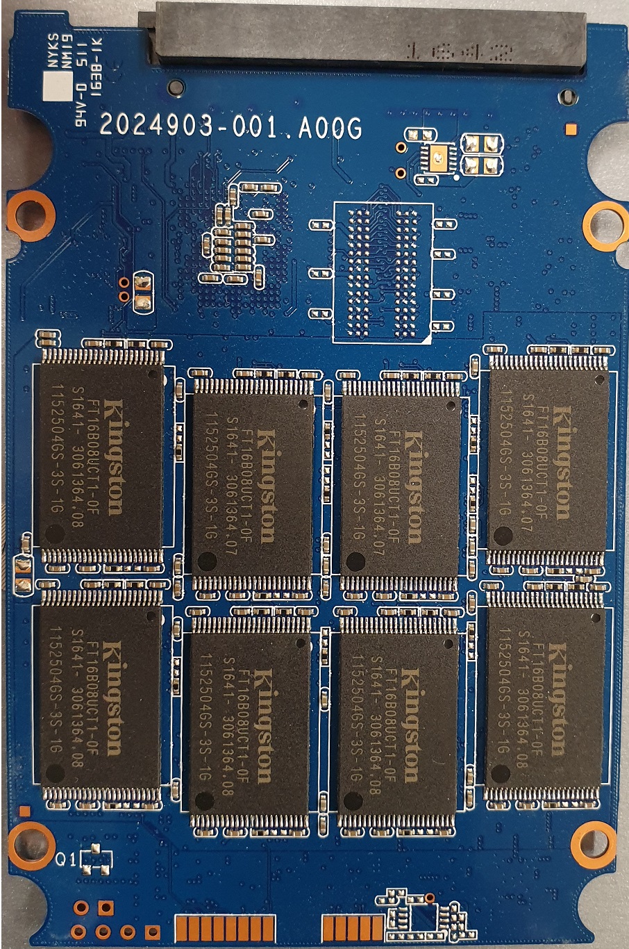

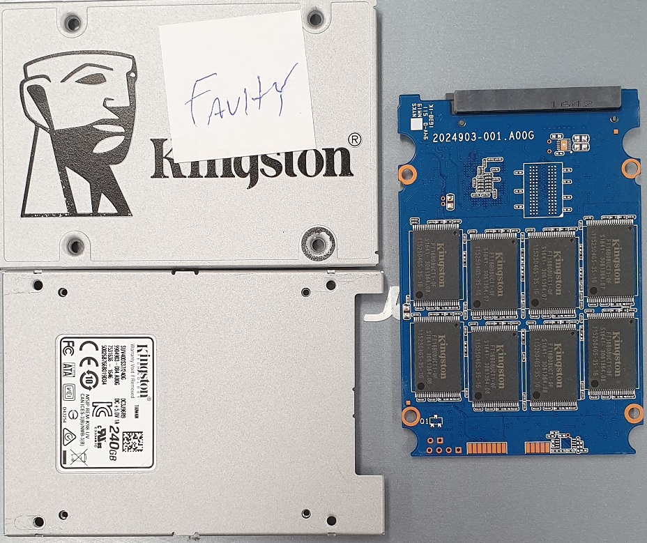

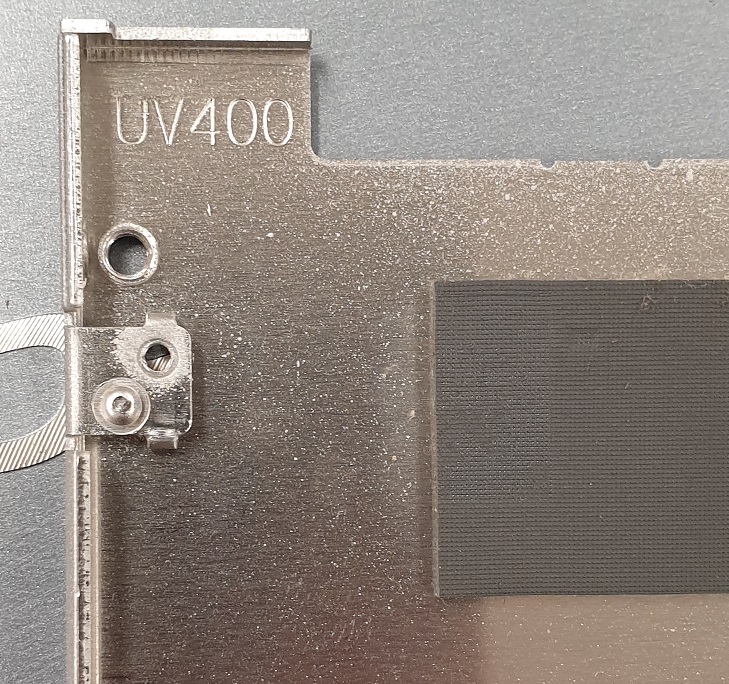

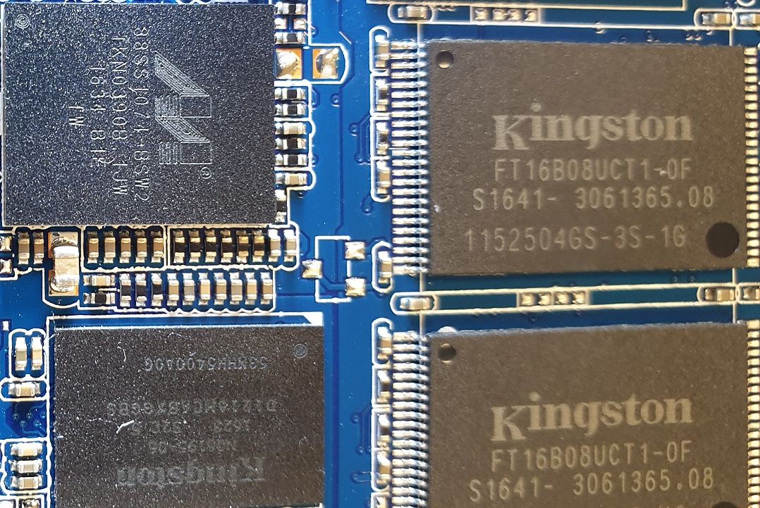

do you have pictures of the case?
This is one of my Kingston's (in the usual status as Failed!) I know it is a different capacity, but usually they are very similar between capacities of the same model.
Note the UV400 stamp on inside of cover, marvell controller and TSOP48 memory chips rebranded as Kingston.

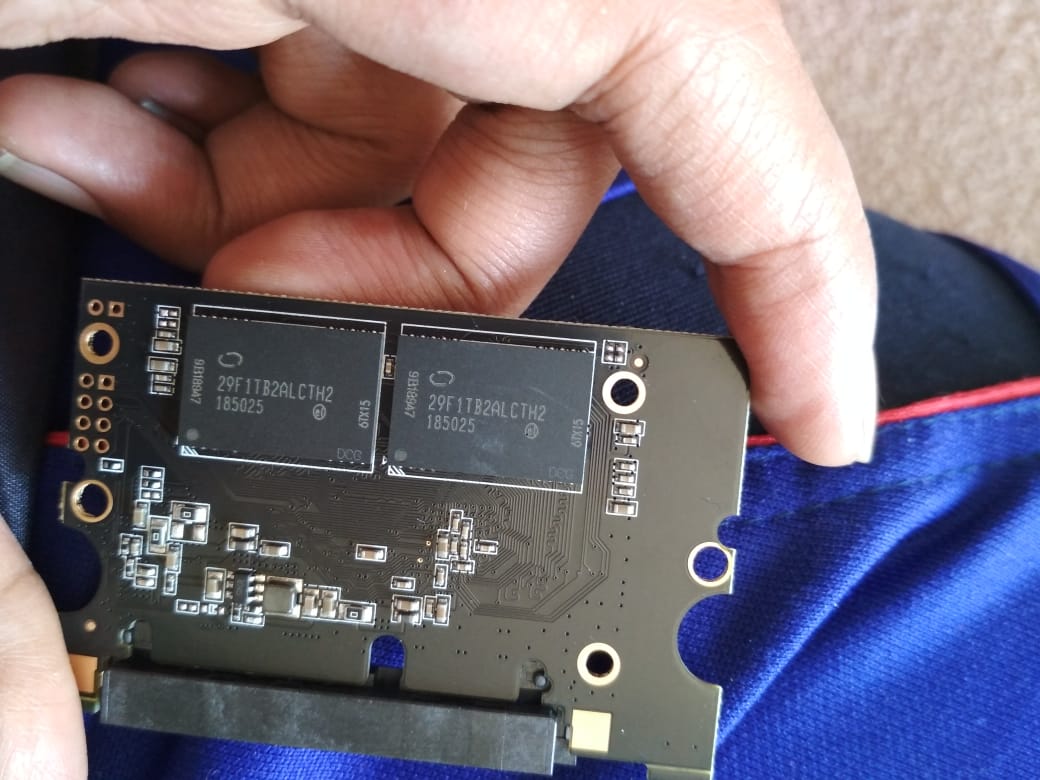

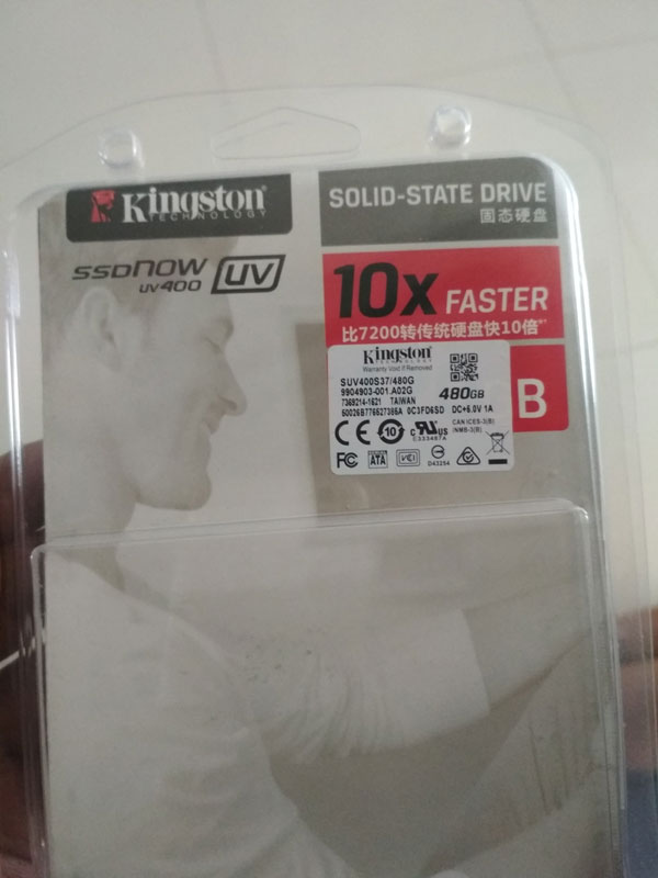

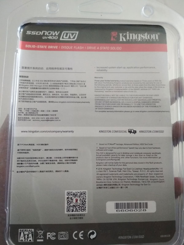

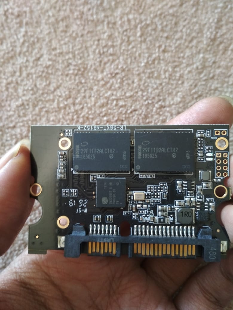

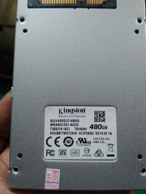

I already put it inside my old laptop and run stable so far, noticed decreased performance compared to previous SSD Kingston v300 128GB (not fake), because it has slower random IOPS.
A few pic from days ago:
The Kingston SSD Manager also can't detect it so its 100% fake. Curious how long it will last but from current performance I think it will fine for years.

I think the chips are fake as well as it looks like a poor attempt at a Micron logo, plus I think a 1 Tb chip should be numbers like 29F1T08 not 29F1TB
I would test the disk by writing it fully and testing back to make sure of no fake capacity shenanigans like storing a bit of data and getting full on the real memory capacity but simply writing over itself.
tools like H2testw can do it. some here (virus scan them first!) : https://www.raymond.cc/blog/how-to-check-and-test-usb-flash-drive/

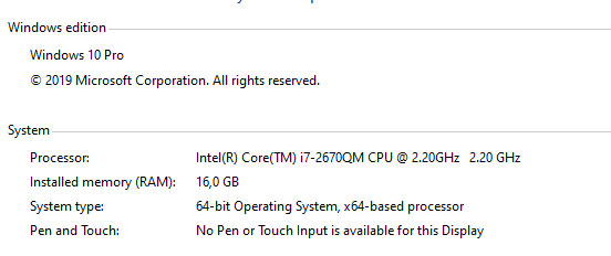

This is the most bad upgrade I have done so far. I have an ancient ASUS K43 Series. Upgrade the CPU to i7-2670qm, modding the AMI BIOS so the hidden BIOS options show up (update the Intel ME and CPU microcode to the latest as well). The official specs is max to 8GB RAM but I can put 16GB right (DDR3 1333) perhaps can up to 32GB.

But anyway my old laptop now have a new life:
https://browser.geekbench.com/v4/cpu/14237859

your ram is likely limited by the chipset of the mainboard.
