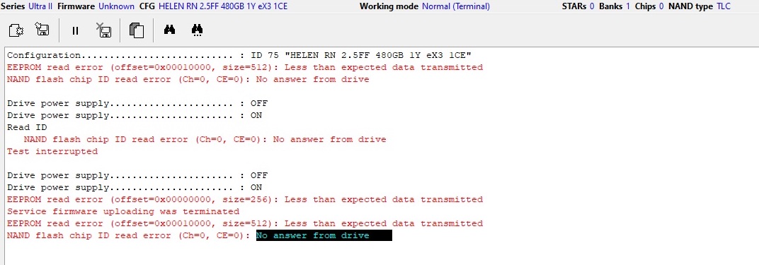

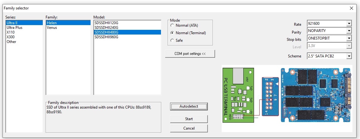

Hello, I just registered because I am at loss what to do: Sandisk Ultra II 480 GB SSD with Marvel 88ss9189-bld2 controller.
The drive has been through PC 3000 incl. direct support from Roman (ACE) and the chips warm up but no data read out at all.
Diagnosis so far: electrically dead. No answer from drive...Eprom read error...Firmware upload impossible etc...
I am looking for somebody who has dissoldered the memory and resoldered them to the same drive model and gotten the data out. Is this possible? Anybody out there? I know it means A LOT of work and am willing to spend.

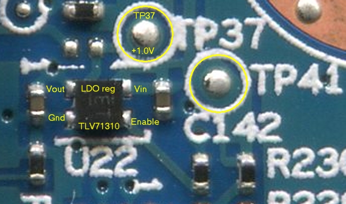

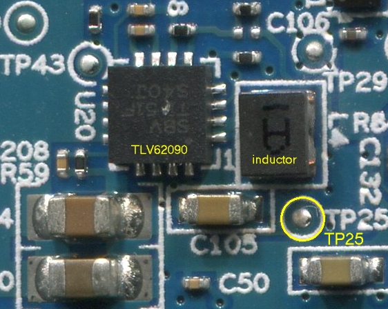

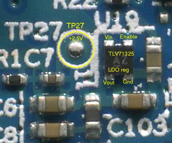

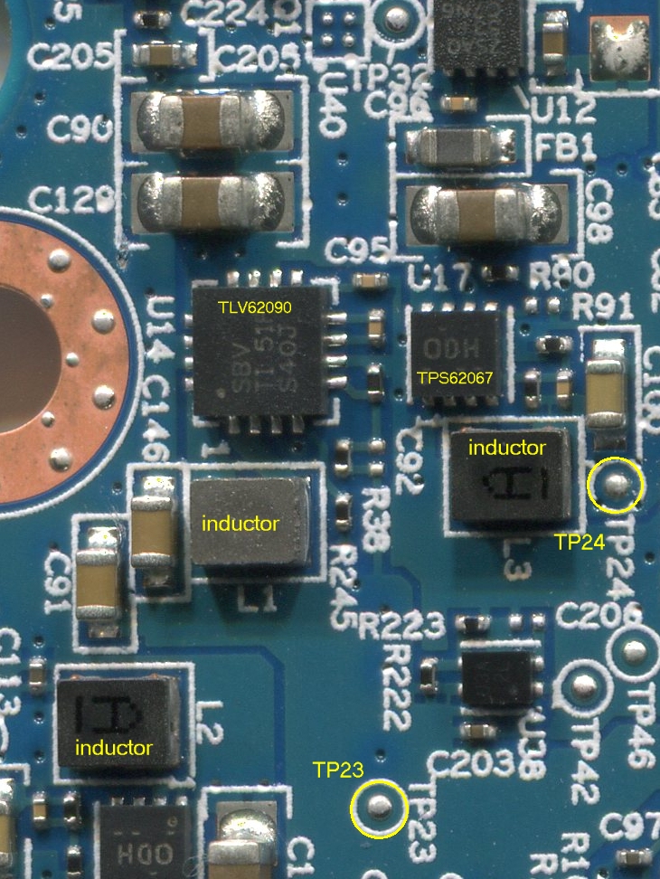

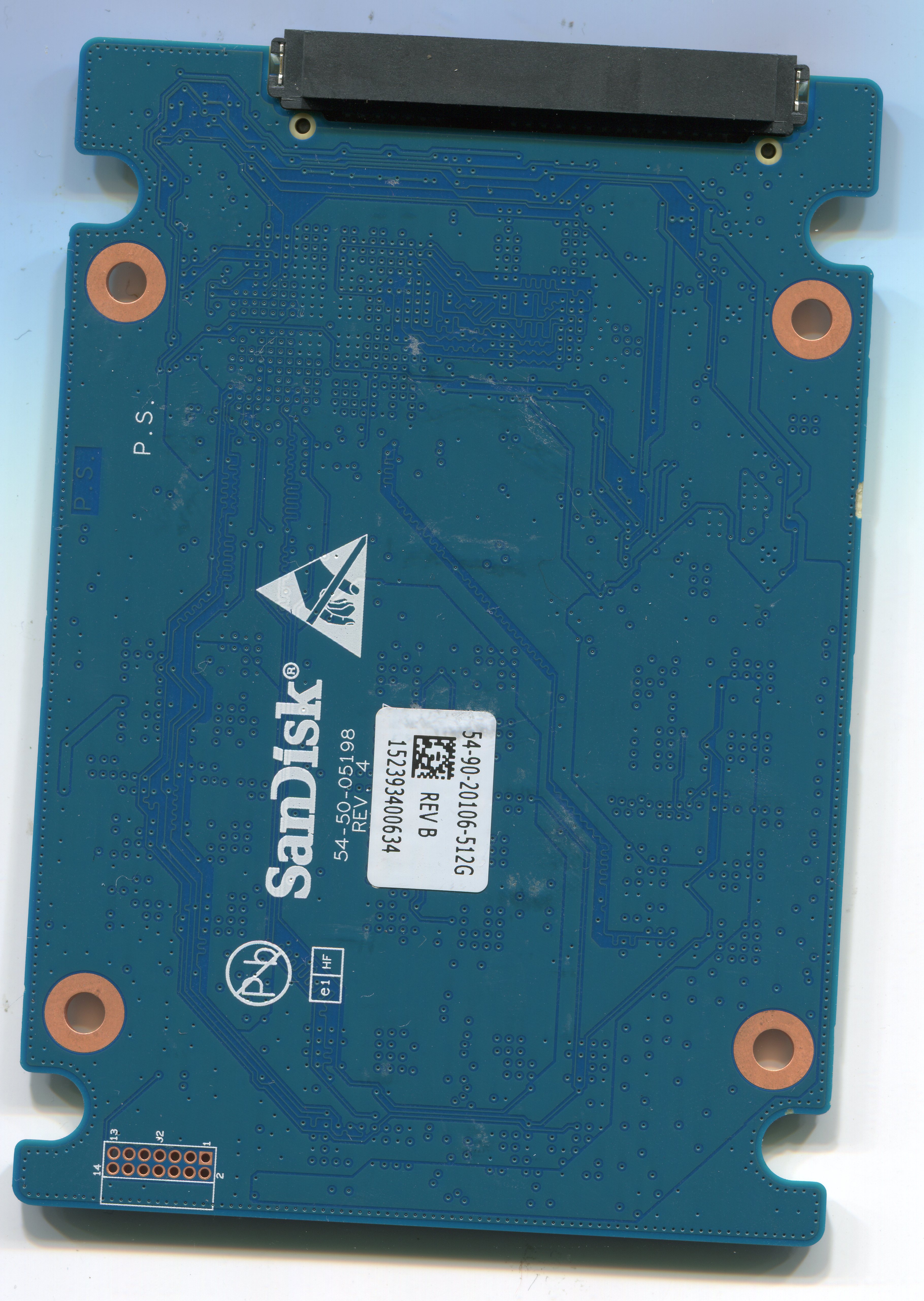

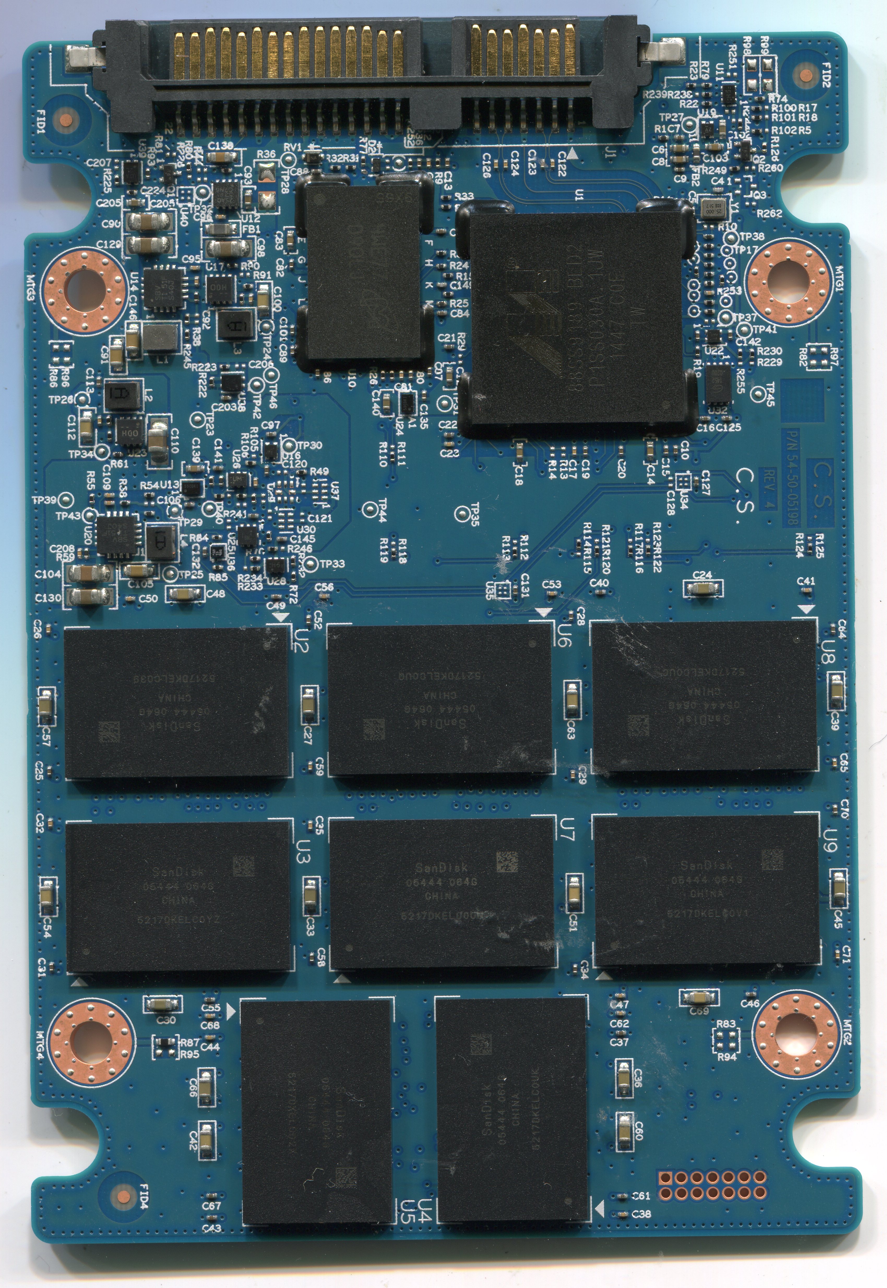

If you can upload detailed photos of each side of the PCB, I can show you the voltage test points. That will help us to narrow down the fault.
Re: News for Marvel 88ss9189-bld2
August 26th, 2020, 17:22
fzabkar wrote:If you can upload detailed photos of each side of the PCB, I can show you the voltage test points. That will help us to narrow down the fault.
I have few of these drives now in lab now. PCB scans:
August 26th, 2020, 18:08
Yes thats what mine looks like thanks, Voltage gets in, chips get warm. The drive was overfilled, meaning somebody was working with video, not knowing that the files were written to the system disk/usr/movies and it sort of ran out of memory, could that be?

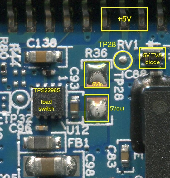

The supply voltage test points appear to be TP23 - 26.
There appears to be a load switch and TVS diode at the 5V input.

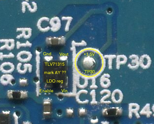

Two more linear LDO regulators.
August 27th, 2020, 4:45
I think this is a 1.5V LDO regulator (if the part marking is AY).
