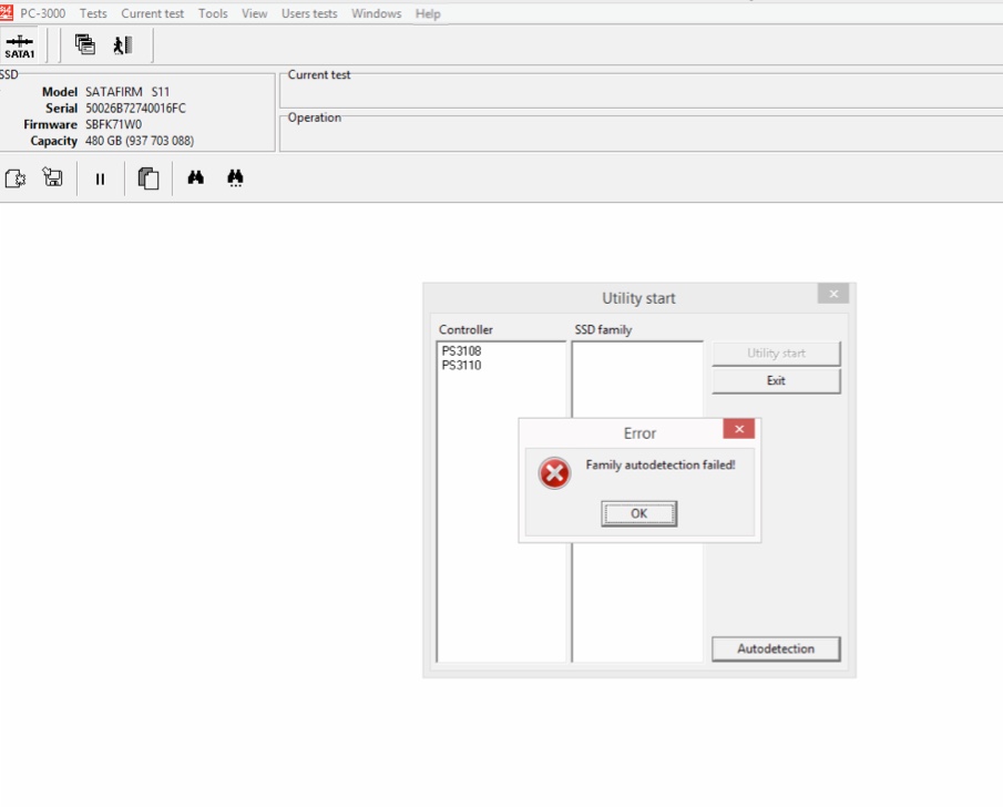

 Post subject: No access data!
PostPosted: June 25th, 2018, 9:37
Posts: 1060
Hi to all!
Please help!
Look print screen.
Attached.

 Post subject: Re: No access data!
PostPosted: June 27th, 2018, 12:53
Posts: 2857
which model is this?

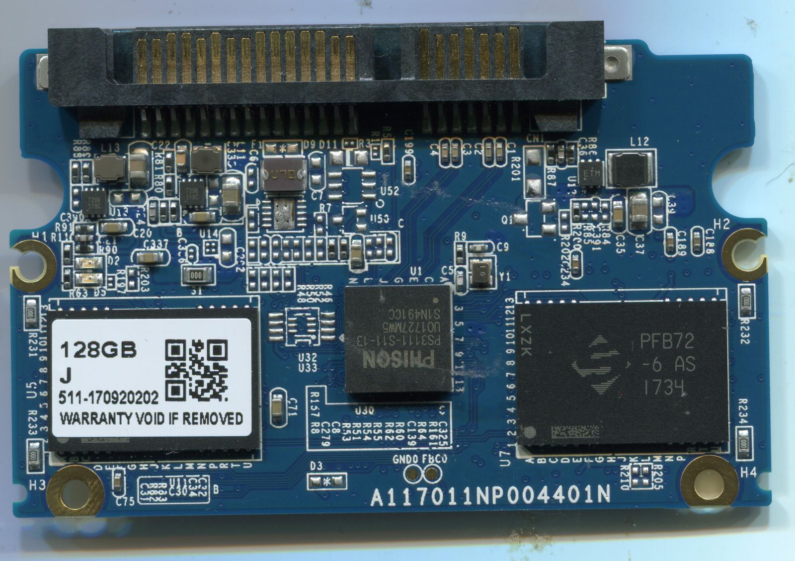

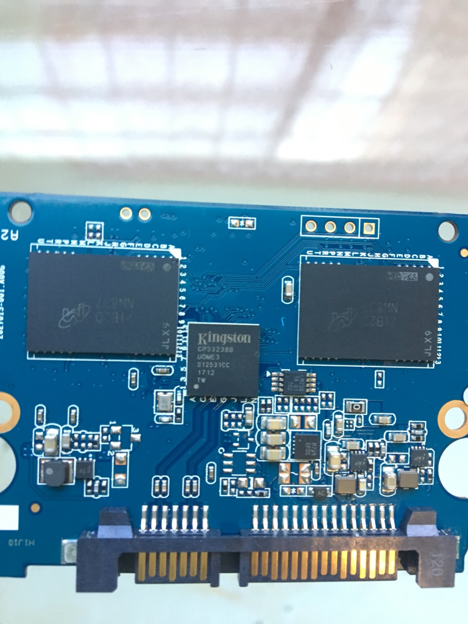

I have two equal cases here for data recovery.
the other ssd and kingston 480gb

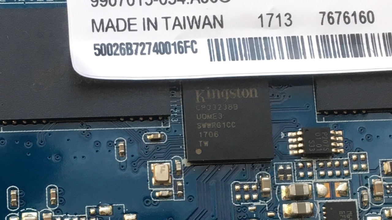

"SATAFIRM S11" --> Phison S11 Controller (PS3111-S11)
PS3111-S11 specification:
http://tophitech.com.cn/uploads/2016/12/252048579143.pdf

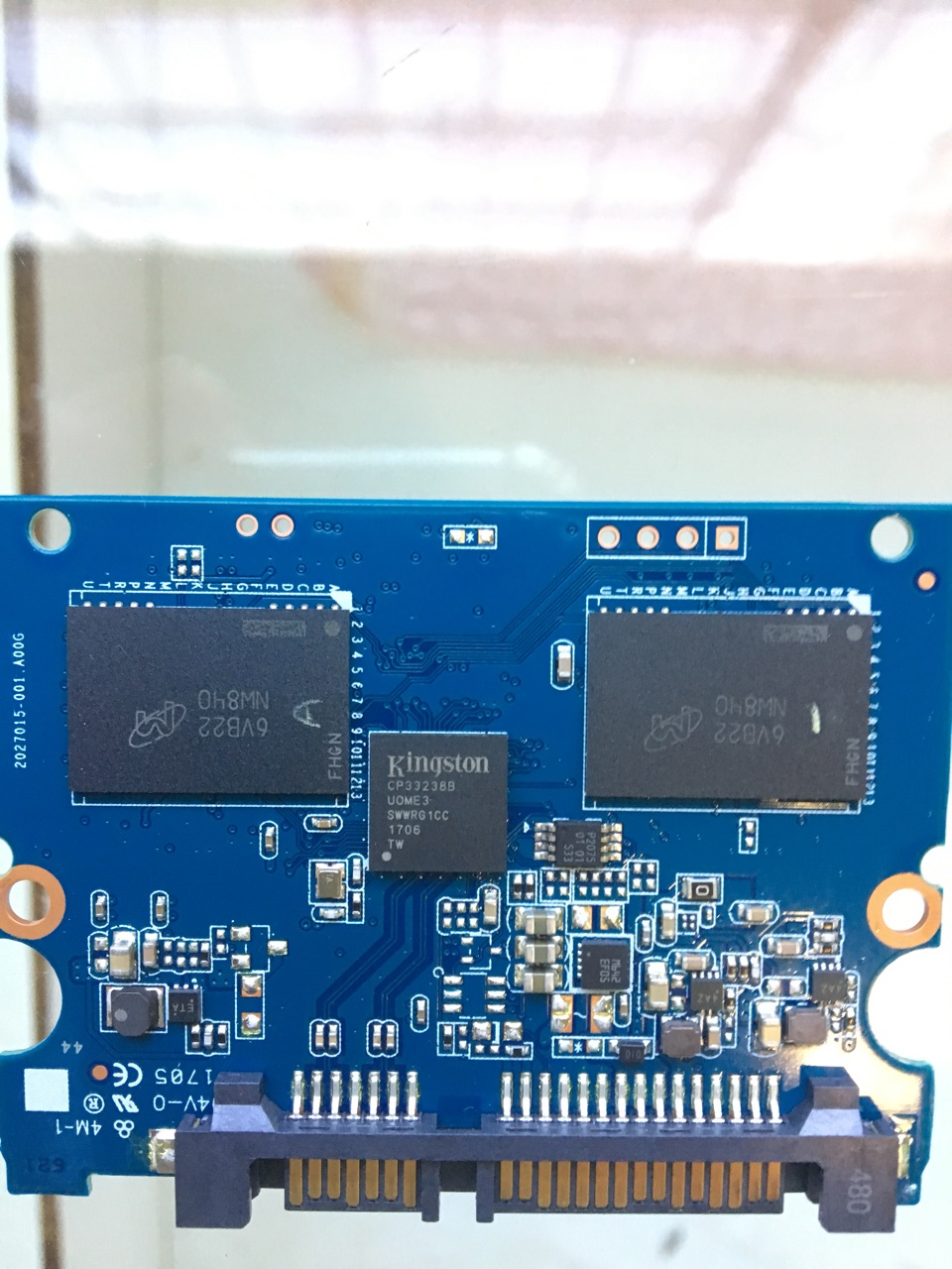

PostPosted: June 30th, 2018, 8:53
Posts: 925
I think it will be Phison PS3111-S11. Sandforce controller is bigger ;)

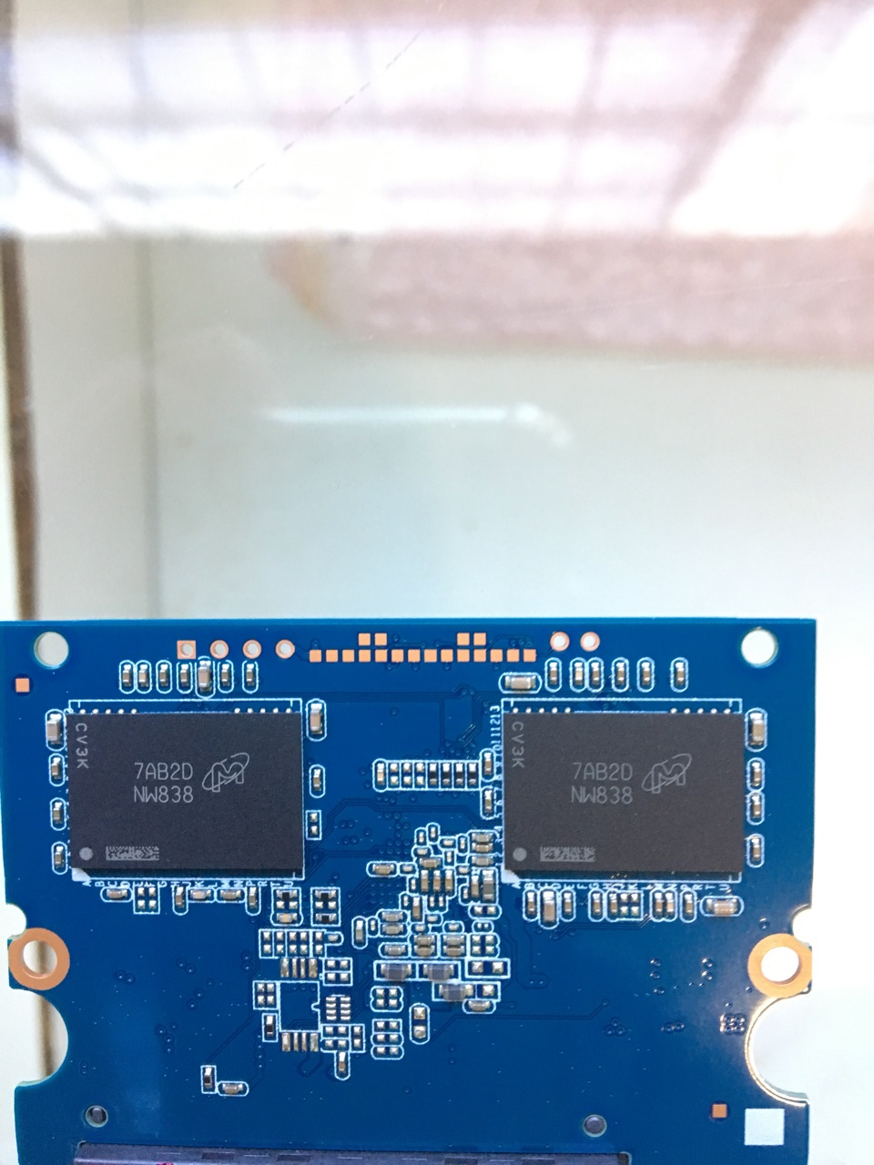

is photos ssd 120 gb

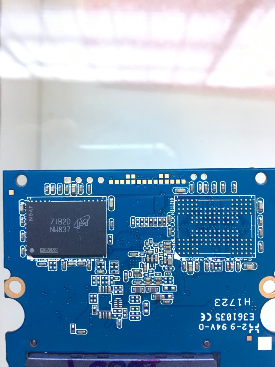

PostPosted: July 2nd, 2018, 8:23
Posts: 1060
is ssd 480 gb
PostPosted: July 2nd, 2018, 17:15
Posts: 17335
ISTM that the "480GB" SSD might actually be a 360GB model (120/240/360/480) :?
2 x NW840 + 2 x NW838 = 2 x 1Tbit + 2 x 768Gbit = 442GB
3 x NW837 = 3 x 384Gbit = 144GB
Micron FBGA & Component Marking Decoder (replace %s with FBGA code):
[url]https://www.micron.com/support/tools-and-utilities/fbga?fbga=%s[/url]
MT29F384G08EBCBBJ4-37:B, Micron, NAND flash, FBGA Code = NW837, 384Gbit, 48GB x 8, 267MHZ, TLC, VBGA-132:
MT29F768G08EECBBJ4-37:B, Micron, NAND flash, FBGA Code = NW838, 768Gbit, 96GB x 8, 3.3V, TLC, x8, 533 MT/s, VBGA-132:
[url]https://www.micron.com/parts/nand-flash/3d-nand/mt29f768g08eecbbj4-37?pc={9A0C5709-8ECA-4DE8-B2AD-12CE9FC958E3}[/url]
MT29F1HT08EMCBBJ4-37, Micron, NAND flash, FBGA Code = NW840, 1Tbit, 128GB x 8, 3.3V, 3D NAND, x8, VBGA-132:
[url]https://www.micron.com/parts/nand-flash/3d-nand/mt29f1ht08emcbbj4-37?pc={9E356F28-3F5E-4FF7-A8D5-657A26EC58BE}[/url]
Yes correct!
currently pc3k does not support this model!
No solution??
You are right Michal, its not supported in 3k yet

I think the only solution is by removing those chips (cannot repair)

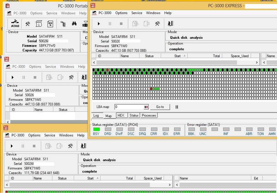

PostPosted: July 31st, 2018, 10:39
Posts: 1060
Hi!!
4 cases waiting solution!

Right now the list of supported models includes the following cpu modifications:
    Phison PS3105 (all modifications and all models);
    Phison PS3108-S8 (all modifications and all models);
    Phison PS3109-S9 (all modifications and all models);
    Phison PS3110-S10 (all modifications and all models);
    Toshiba TC58NC1000 (all modifications and all models);
    Phison PS3111-S11 (all modifications and all models);
    Kingston CP33238B (all modifications and all models)
