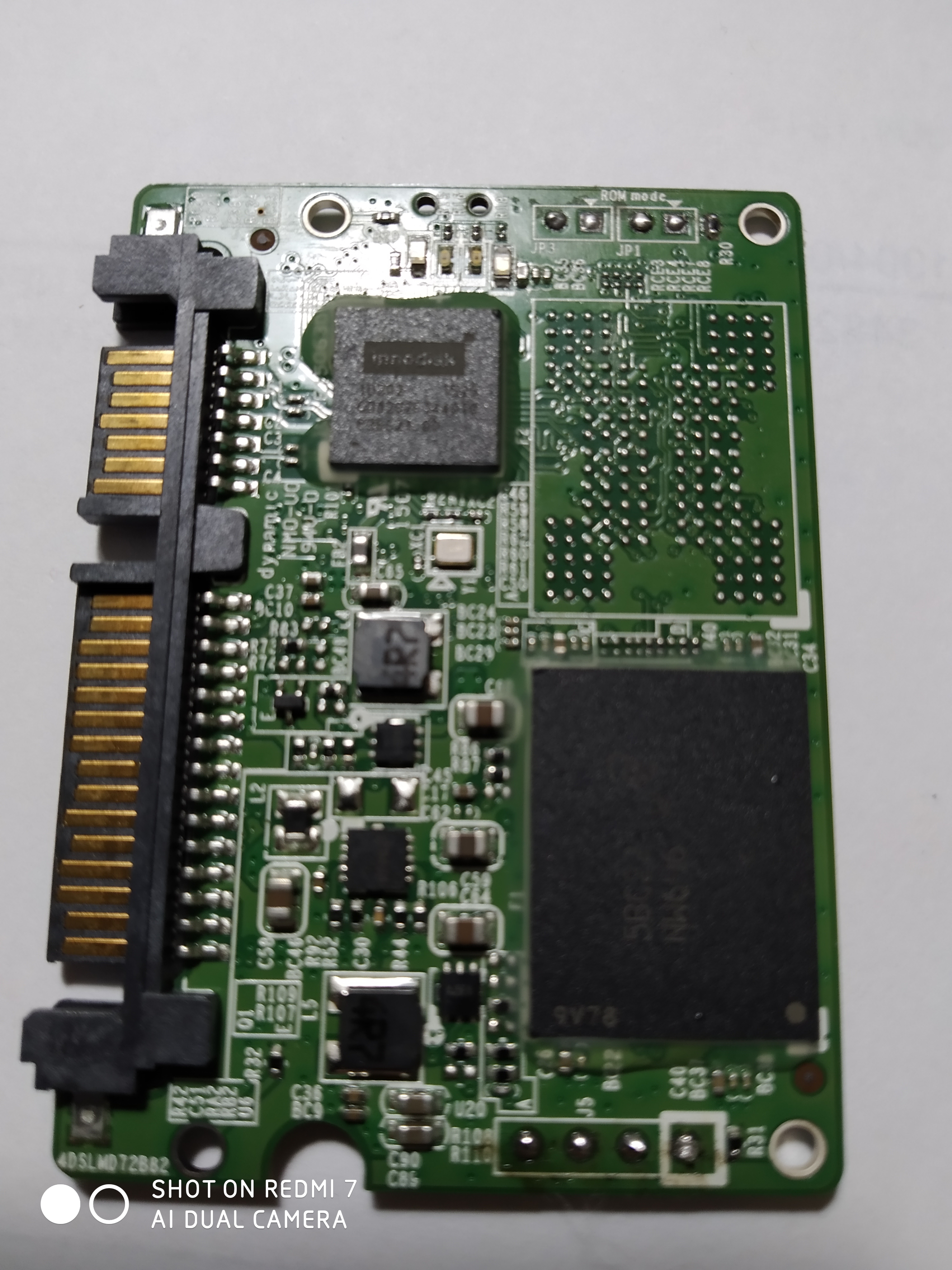

I have this HDD that stays in BSY.
It is an industrial SSD.
Can someone help me with any ideas.

The controller seems to be an SM
3556288-802802082 SM2246AAMS2264AA8.

tipical for this controller
in short
safe mode
LDR
virtual translator
image/clone

I'm trying to do those steps you indicate, but I have MRTLAB and I can't find a compatible controller to do it.

https://blog.acelaboratory.com/pc-3000-ssd-silicon-motion-sm-utility.html
AIUI, if it's DRAM-less, then then the controller is an SM2246XT, otherwise it's the SM2246EN.
If your SSD has SM2246EN – use Crucial SiliconMotion Utility;
If your SSD has SM2246XT – use Sandisk SiliconMotion Utility;
Have you checked MRT's latest updates?

Thank you very much for the information @fzabkar.
Now I have the mrtlab busy with 2 discs. I will review the information and I will inform you tomorrow.

It is indeed a sm2246xt, it does not carry ram chip.
The loader loads perfectly, but it is not possible to make the virtual translator.
