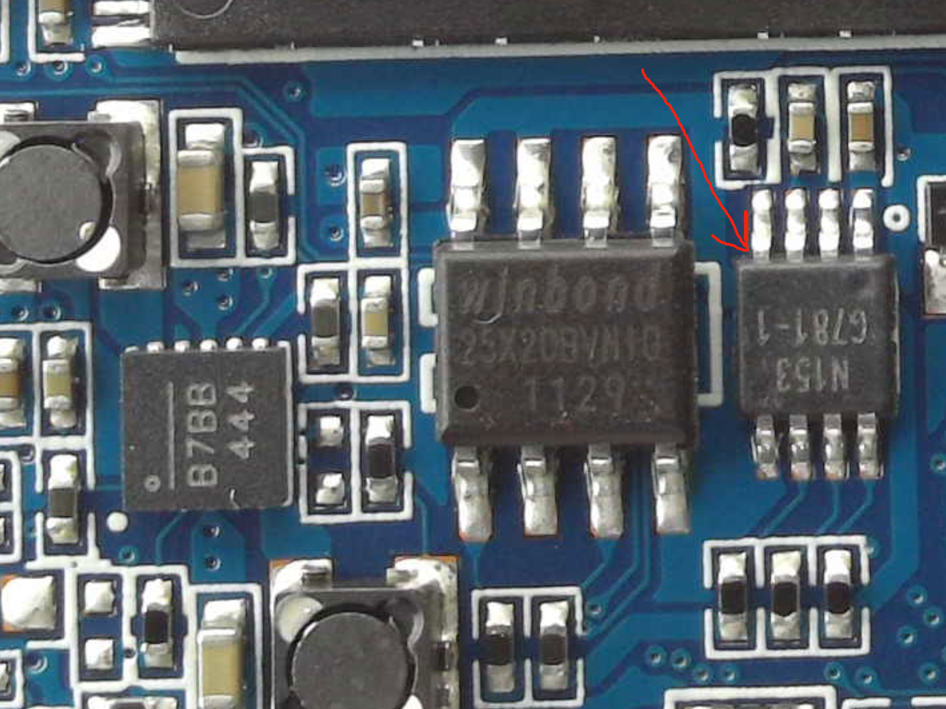

Hello guys,
Any expert here can ID this chip? or have some info. about it?
thank you

Are you sure that not WinBond ? In fact WinBond are 8Mb NOR which can be readed over SPI

Hi, am not talking about the Winbond, the other one beside it... (Red Arrow)

G781, Global Mixed-mode Technology Inc., +/-1 degC Remote and Local Temperature Sensor with SMBus Serial Interface:
http://www.gmt.com.tw/product/datasheet/EDS-781.pdf
Datasheets for SSD and Flash Drive ICs:
http://www.hddoracle.com/viewtopic.php?f=100&t=1577&p=8692&hilit=g781#p8692

Thank you... (added the page to my bookmark ref.)
