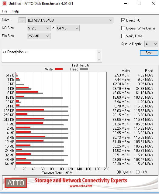

Thak you all for answers. For final test (1gb test size) I decided to set it on 16K allocation (probably won't change this, my final allocation). I expected higher 4KiB values in Crystal mark, some other cheaper stick have there around 2-3mb speed.
Why on ATTO is so many speed oscilation? Mostly benchmark I see in ATTO have normal stable scale.
And why on 50mb test I get slower speed? For now I don't care about allocation I just want to verify that usb is working correctly. For example this amazon review (50mb crystal mark test) seems to have much higher speed than mine:
