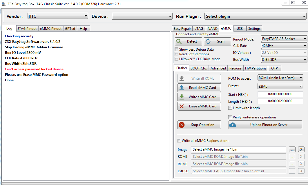

I have been struggling via various methods to access the data on the eMMC drive of my laptop.
I tried using an e-Mate by MOORC correctly using the data sheet
I then sent it to a mobile phone specialist centre for them to read it. They can see the data is there, but it has a password block. I gave them my pin over the phone for them to access the data. The trouble is the only access they currently have would delete the data, there is no point in that. They do deal with mobile phones mostly, laptop eMMC rarely, they are finding difficulty in getting through, even asking their police friends for advice with no positive results. This is the screen print url of their access programme, followed by other data
https://onedrive.live.com/?cid=9344F523FDB4C079&id=9344F523FDB4C079%212343&parId=9344F523FDB4C079%212342&o=OneUp
Compression if OFF
Z3X EasyJtag Software ver. 3.4.0.2
Loading eMMC GEN2 Firmware... IO: 2800 mV

EMMC Password Locked: Yes

Done.
 Post subject: Re: eMMC chip access
PostPosted: January 17th, 2019, 17:22
Joined: January 17th, 2019, 14:14
Posts: 14
The screen print from the company that is trying to extract the data:

Acer Aspire Windows 10 - no bootable device - tried everything to access it, so eventually took it off the board, now the chip can be seen, which is progress, but it cannot be accessed without going through the password bit, any other route deletes the data - the data is clearly what I need to see again
I am not too familiar with that model, however I am surprised its an eMMC chip.
Did you physically remove the chip from the board? ie desolder it?
Can you send a picture of the chip and the logic board.

Yes, I got a more experienced person to desolder it for obvious reasons. The chip is with a professional - usually mobile phone data extraction outfit as you can see above all the data in a small paragraph. I was too surprised, it is a thin model but I did expect a proper hard drive, I'd have my precious data easily if that were the case.
PostPosted: January 17th, 2019, 20:06
Posts: 1777
Location: Phoenix, AZ USA
With this type of set up (chip on logic board), it is always preferable to try to access the data with the chip on the board by every means possible before removing the chip. ie logic board work. A lot of chips can also be encrypted, so removing the chip can make the data unrecoverable.
I would strongly suggest you take it to a professional data recovery company rather than the cellphone store. While they may charge more for the recovery, they may well be able to tap into the data partitions on the chip which does require specialist equipment and knowledge.

I did ask a professional data recovery company first and thy could not do anything for me, after taking it to a computer repair shop. I also did try every option available with the chip on the board. I joined several forums for advice which I followed, I also contacted Acer
I have tried every possible on board option - I am fully aware this is the final option available. For it to see the chip is progress.
I tried a boot usb, EaseUS and plenty of other stuff.
Please focus on answering the question re the password access.
I keep looking at this when I get a notification of hope of a workable solution, please, if you can provide one, do - it is about passworded access.

For eMMC chip there is few method to access to data:
1. soldering to chip on board by wires from "kitchen" site.
2. Chip-off and read by adapter via working controller
3. Chip-off and read directly from nand (the most advanced method)
Never meet such situation where we can't read dump due to encryption. We read it on hardware level, not software level. (I have only one case per last 10 years, which was blocked and it was SD monolith card from special device).

Arvika. A lot of these laptops with onboarding chips are encrypted with BitLocker by default which is decrypted through the Windows password. The new Surface is like this. So you cannot decrypt it through the chip. Just saying.

The chip is being returned to me as the data could not be reached:
Do any of you have the equipment to get through and so can you help?
JOB DESCRIPTION:
Windows Laptop / Tablet eMMC Data Recovery Service
Notes for POST: Clare Kingston (38868) From Engineer:
chip arrived.
chip reballed / cleaned up by mike
chip ready for scheduled dump wednesday
chip detected ok
attempted to read eMMC, but fails due to emmc chip is password protected !!
I cannot attempt to remove password without wiping data :(
After much research, i am told the chip is ultimately encrypted, by what is unknown, there are multiple types of encryption the manufacturers can use.
the only possible solution is to re attach the chip back to the logic board and let a high level pc data recovery company try inline data recovery.
However i have been advised that this may not yield a result, even if the chip is attached successfully, which has a low success rate, they still may not get past the encryption on the chip
sorry i could not be any more help with this.
Mark

---------- eMMC Device Information ----------
eMMC CID : 45010044463430363401300EB8B234C1
eMMC CSD : D00F00328F5903FFFFFFFFEF8A404023
eMMC Manufacturer ID: 0045 , OEM ID: 0100
eMMC Date: 03/2017 Rev.0x1
eMMC NAME: DF4064 , S/N: 806271154
eMMC NAME (HEX): 444634303634
EMMC ROM1 (Main User Data) Capacity: 59640 MB
EMMC ROM2 (Boot Partition 1) Capacity: 4096 kB
EMMC ROM3 (Boot Partition 2) Capacity: 4096 kB
EMMC RPMB (Replay Protected Memory Block) Capacity: 4096 kB
EMMC Permanent Write Protection: No
EMMC Temporary Write Protection: No
EMMC Password Locked: Yes <<===============================================================
Extended CSD rev 1.8 (MMC 5.1)
Boot configuration [PARTITION_CONFIG: 0x00] No boot partition configured.
Boot bus config [177]: 0x00 , width 1bit , Partition config [179]: 0x00.
H/W reset function [RST_N_FUNCTION]: 0x00
High-capacity WP group size [HC_WP_GRP_SIZE: 0x00004000]
Partitioning Support [PARTITIONING_SUPPORT]: 0x07
Device support partitioning feature
Device can have enhanced tech.
Partitioning Setting [PARTITION_SETTING_COMPLETED]: 0x00
