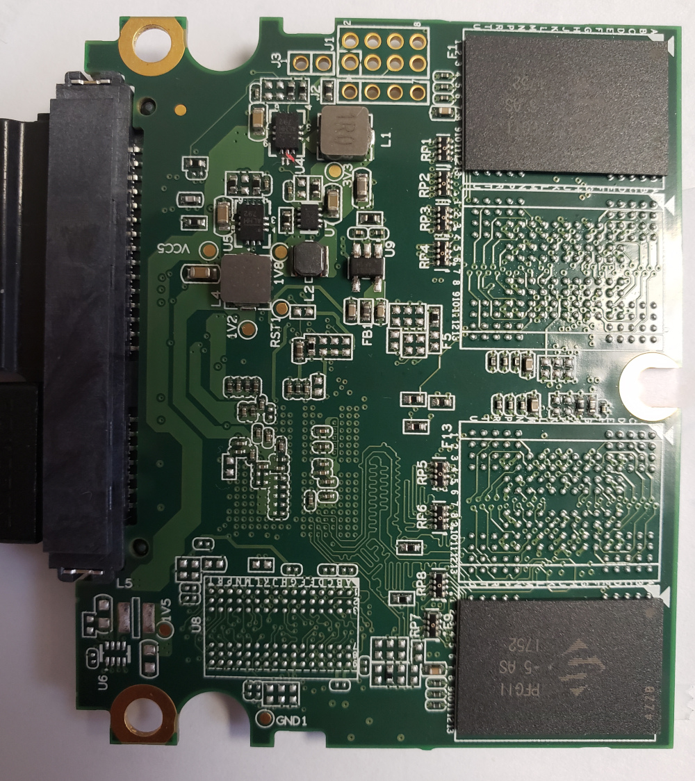

Hello, I have this SSD which stays BSY and i need to short so i can upload loader. Thank you in advance

The jumper is labelled for you. ROM??

thank you for your reply. i have already tried this shorting and i get the same result. BSY,DRD,DWF,DRQ and CRR are always on

Do you get any output from terminal (Tx/Rx)?
Have you checked the voltages at the L6, L7 and L14 inductors?

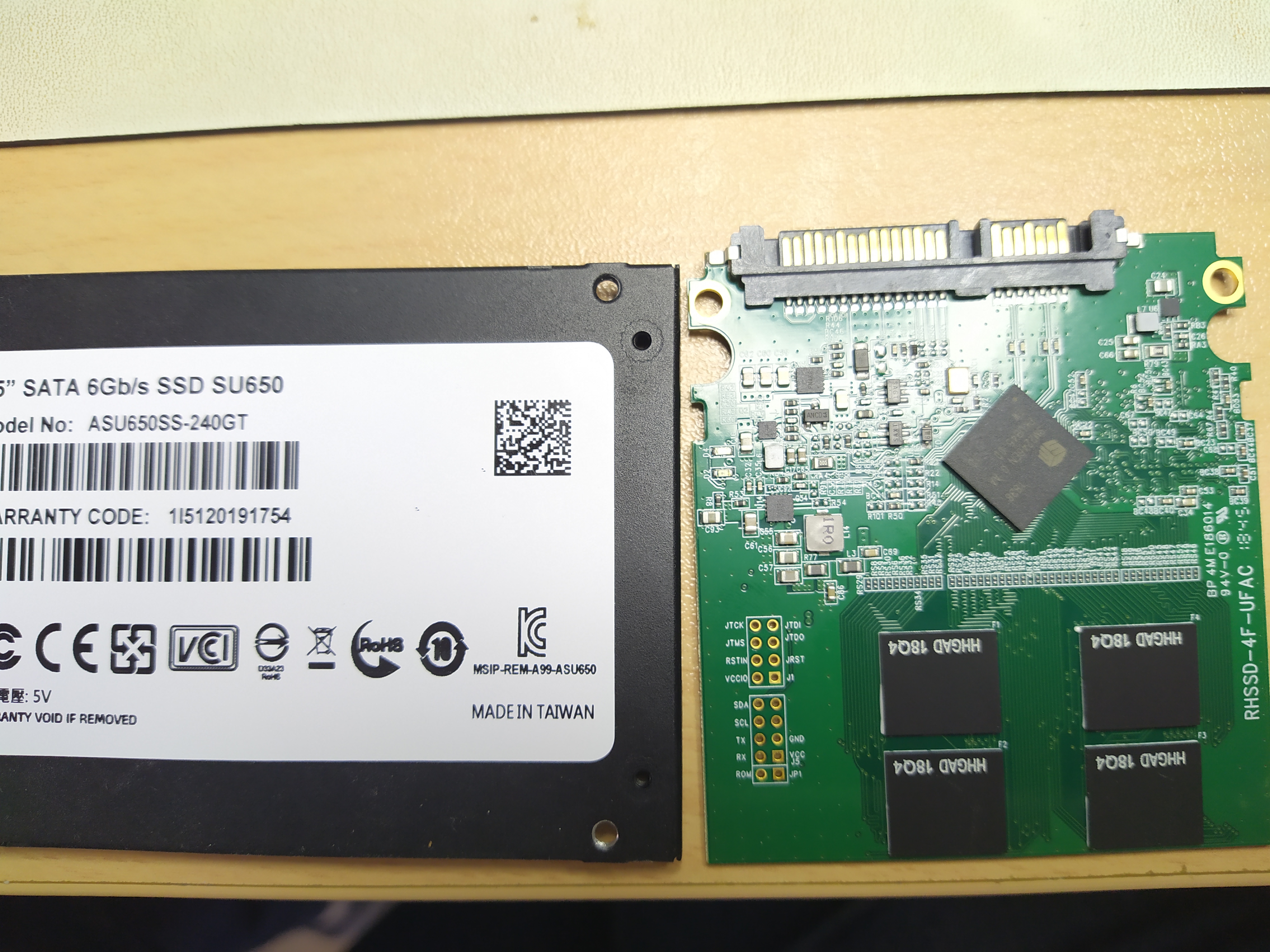

Eh, what's going on?
The controller in the following review is a Silicon Motion SM2258H.
ADATA SU650 SSD 240 GB (ASU650SS-240GT review):
http://hardwarebg.com/44440-adata-su650-ssd-240-gb/2/
The 480GB version in the following review uses a Maxio MAS09024-B2C flash controller.
Review: ADATA Ultimate SU650 480GB 3D NAND SSD (ASU650SS-480GT-R):
https://goughlui.com/2018/12/19/review-adata-ultimate-su650-480gb-3d-nand-ssd-asu650ss-480gt-r/

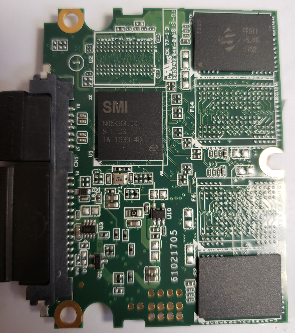

Adding to the variety of ADATA SSD Boards with the same Model.
ADATA SU650 120GB Model.
Controller Markings look like:
SMI
N05K93.00
S LLUS
TW 1639 4D

Looks like a SM2258AB controller?
The drive is in BSY Mode when powered on.
I am able to short the drive and get it RDY in safe mode.
Any help on how to proceed after that?
