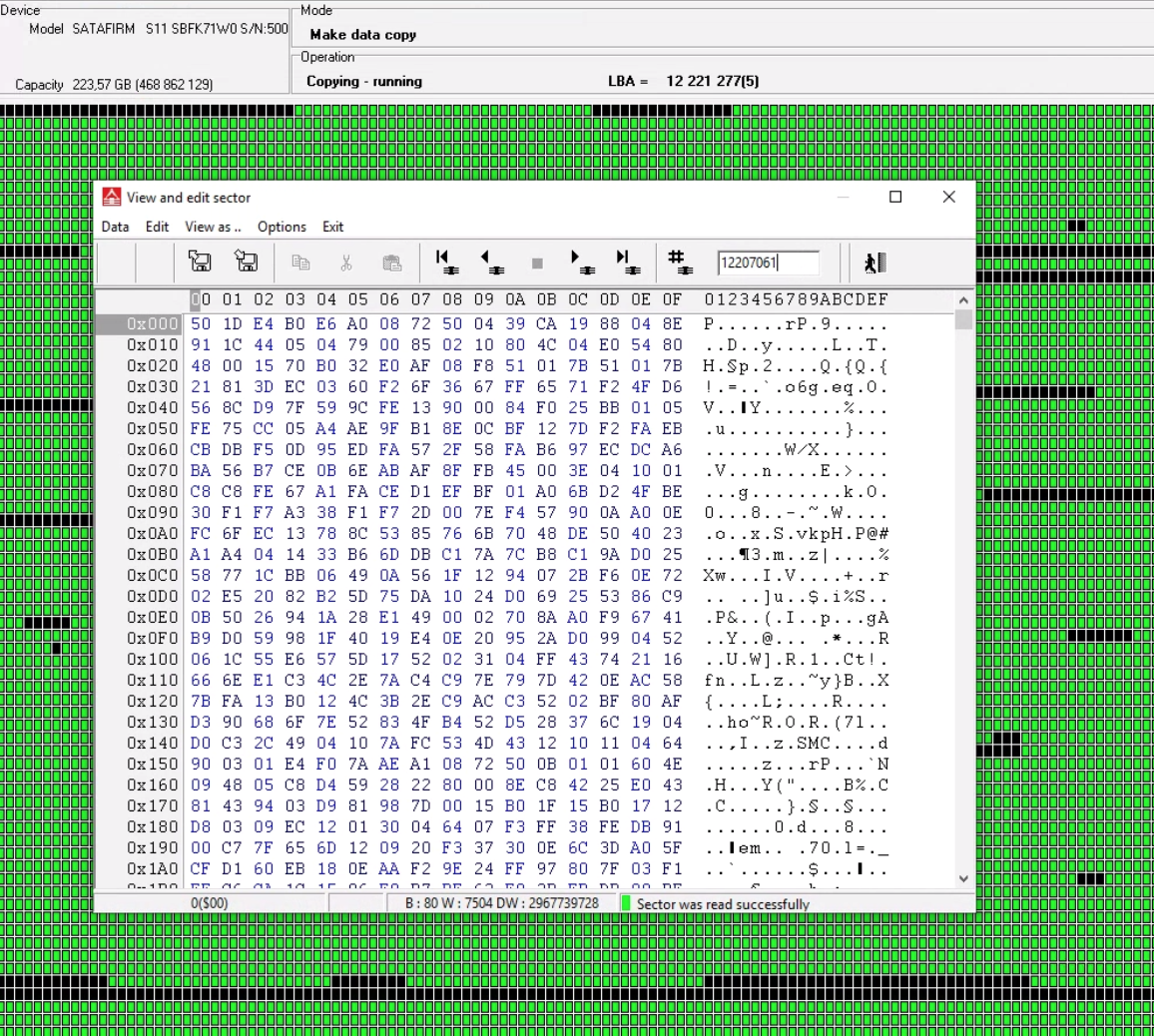

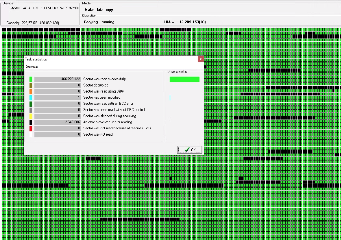

Location: Gothenburg/ Sweden
Hi Boerge, It's a firmware issue where the translator is lost (could be weak hands with bad blocks in SA as well)...so you need to re-create that translator.
I working on the exact same case right now, and almost getting all the data from the drive.
