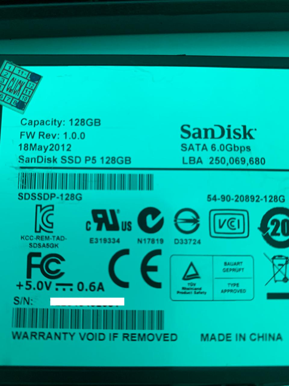

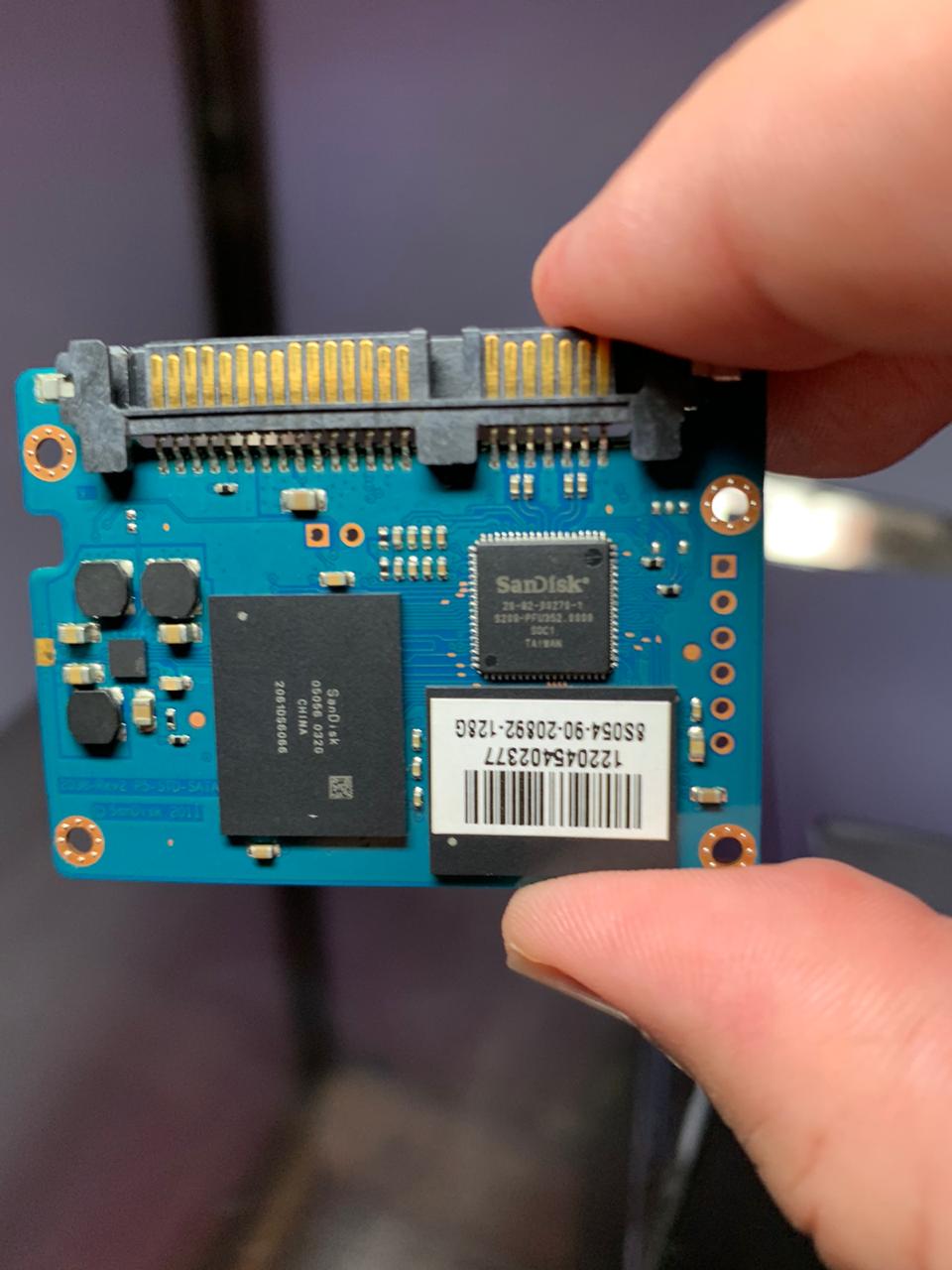

Hi to all! :mrgreen:
Not access to data....
Not utility pc...
Model : SanDisk SSD U100 128GB
Serial : 122045402531
Firmware : 1.0.0
Capacity : 128 GB (250 069 680)

Can you measure the supply voltages at the inductors and/or capacitors adjacent to the PMIC?

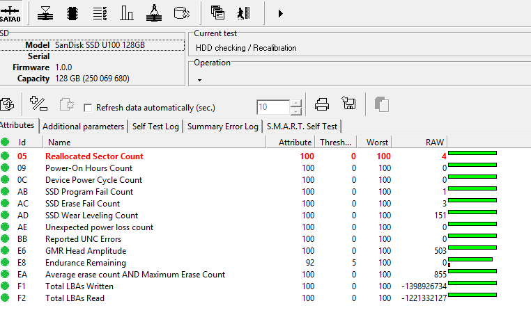

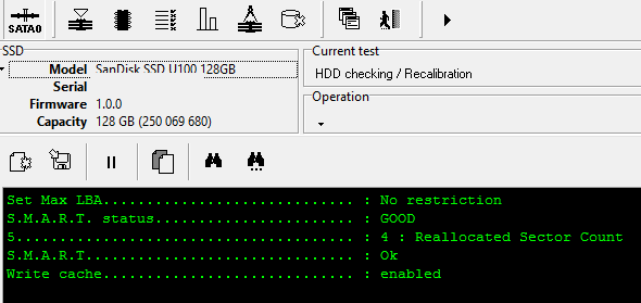

ok.
Please look !
Smart ok.
Is bad translator?
