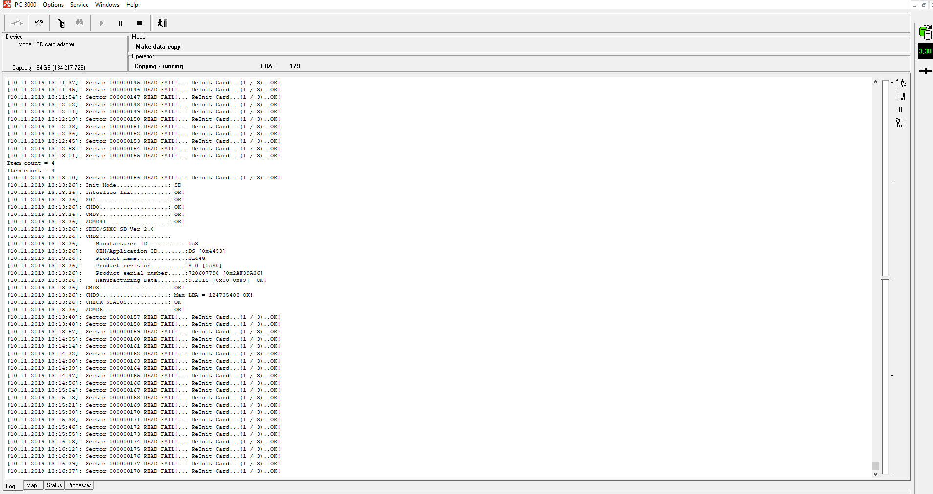

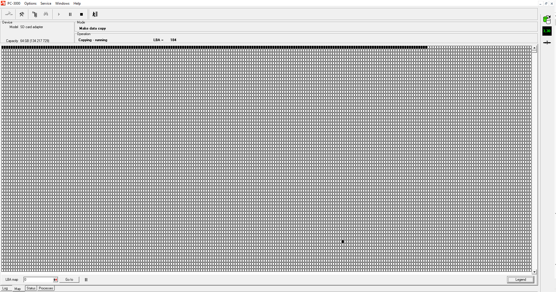

I have this card from a client. But when i startthe card, it tells me to do a quick analyze, but that shows me an error prevented from reading the sector/lba. See pics. I tried to format the card in windows, it was succed, and tried to read the disk with recuva first, then easeus. But nothing helped. I still got these errors. I tried also to randomly check LBA on the card, but same message...
When do i know when to use the circuitboard for recovery?

Chances are that the memory is degraded, so will require direct NAND memory dumping (with multiple read retries after software ECC correction), XOR application..etc..
