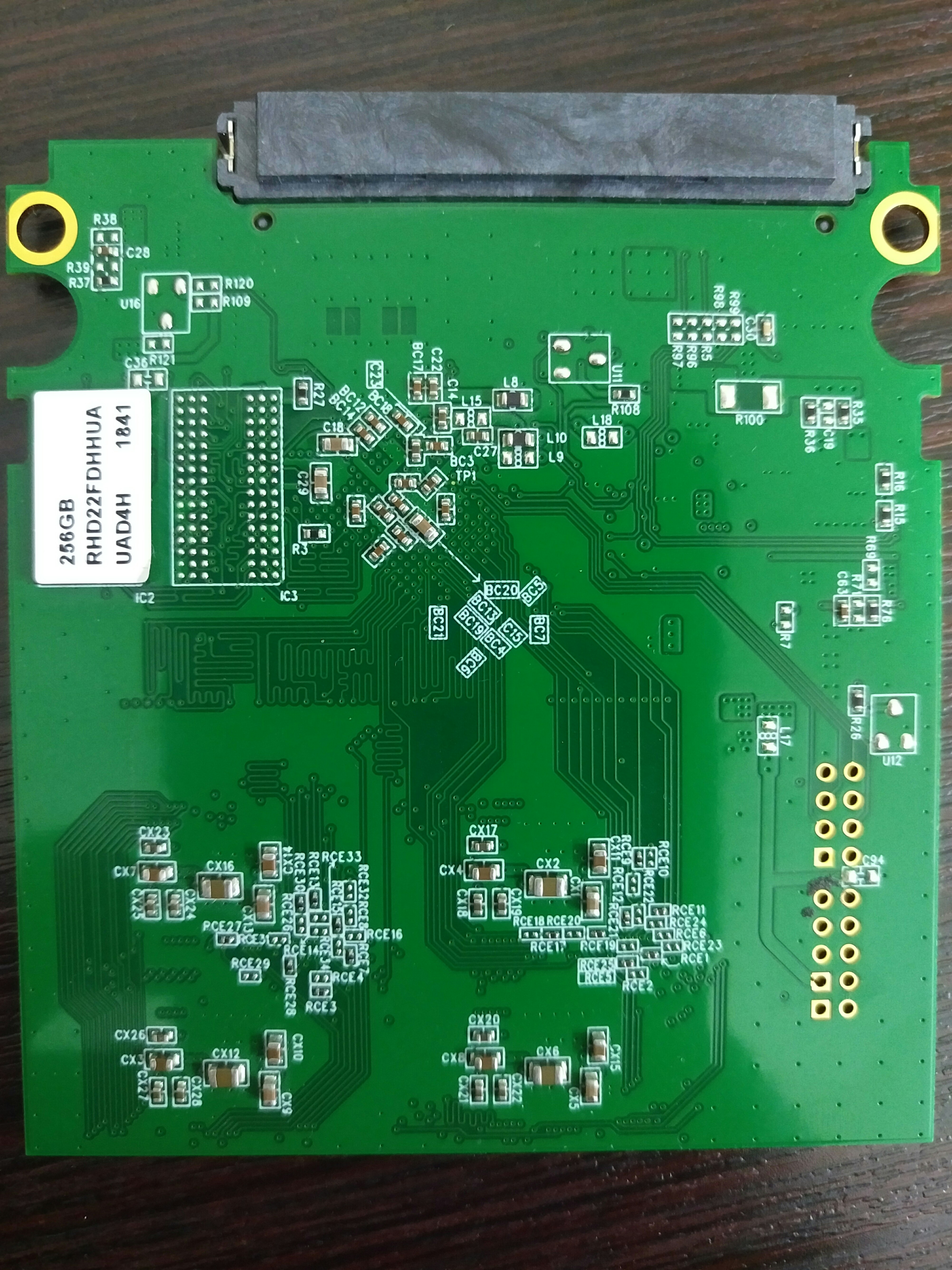

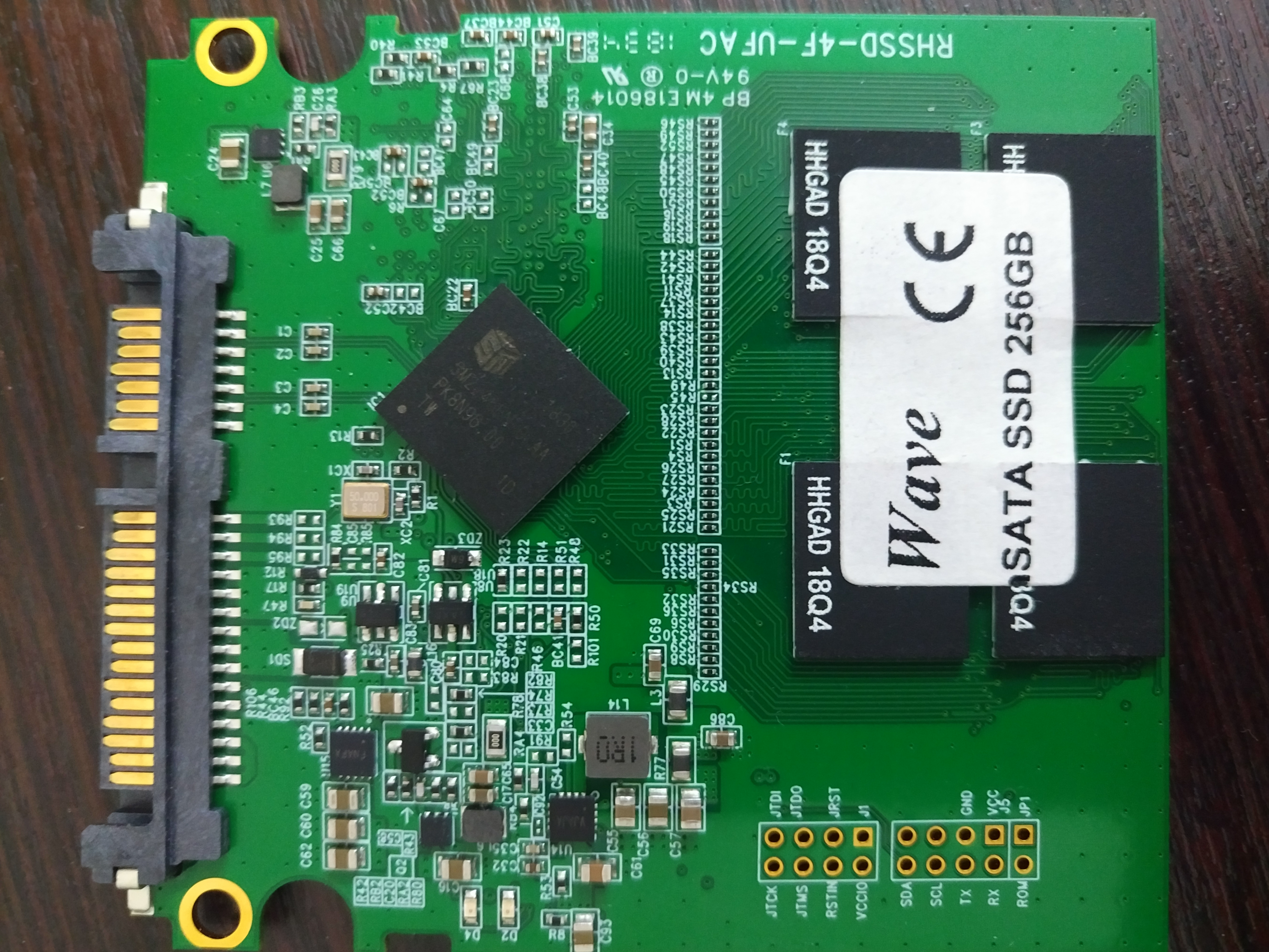

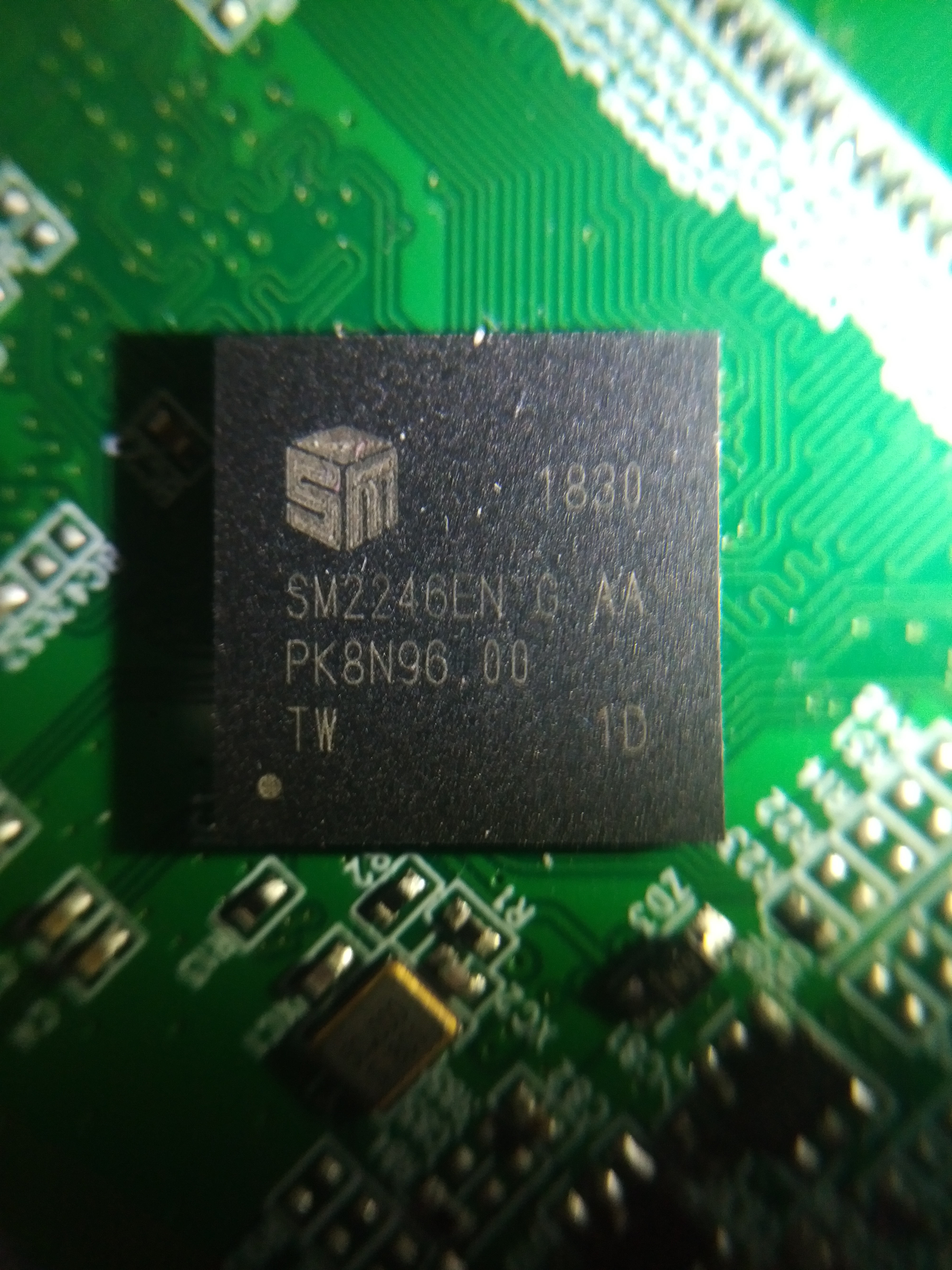

Hi all
Where is short pin?
It's BUSY

I think it's the "ROM" pins, at least that is the case for some other designs.

Yes, ROM and JP1.
Yes, ROM and JP1.
Yes, It is correct. detect as a 1Gb...
How can I repair it?
