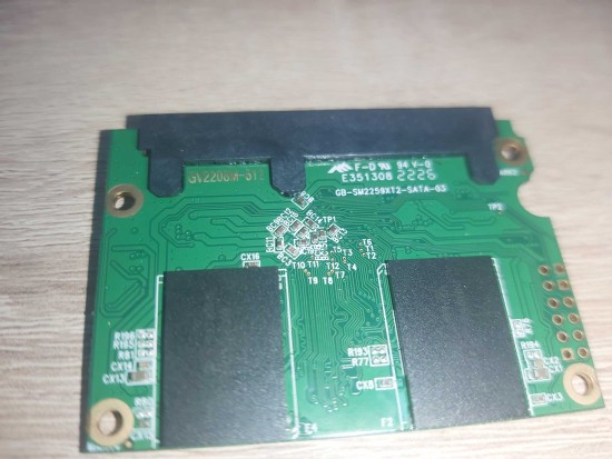

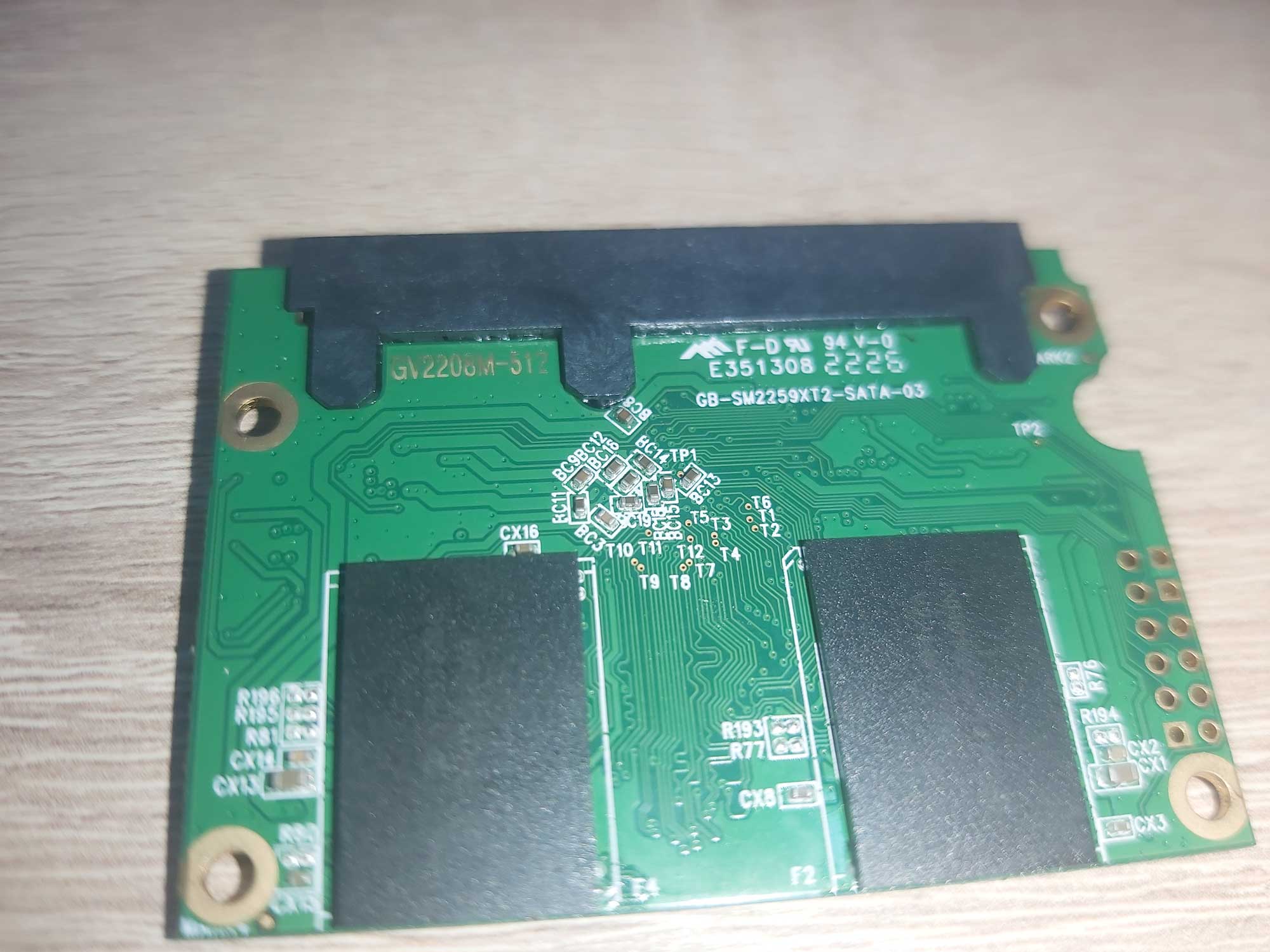

How to deal with an SSD when the PWR is OFF in PC3000 (even if you shortcut it).
Is there a way to fix it, or do you need to move the controller + chips to the same model SSD?
Than you in advance

Measure the voltages between each inductor and ground. Chip transplants are for mechanics, not electronics technicians.

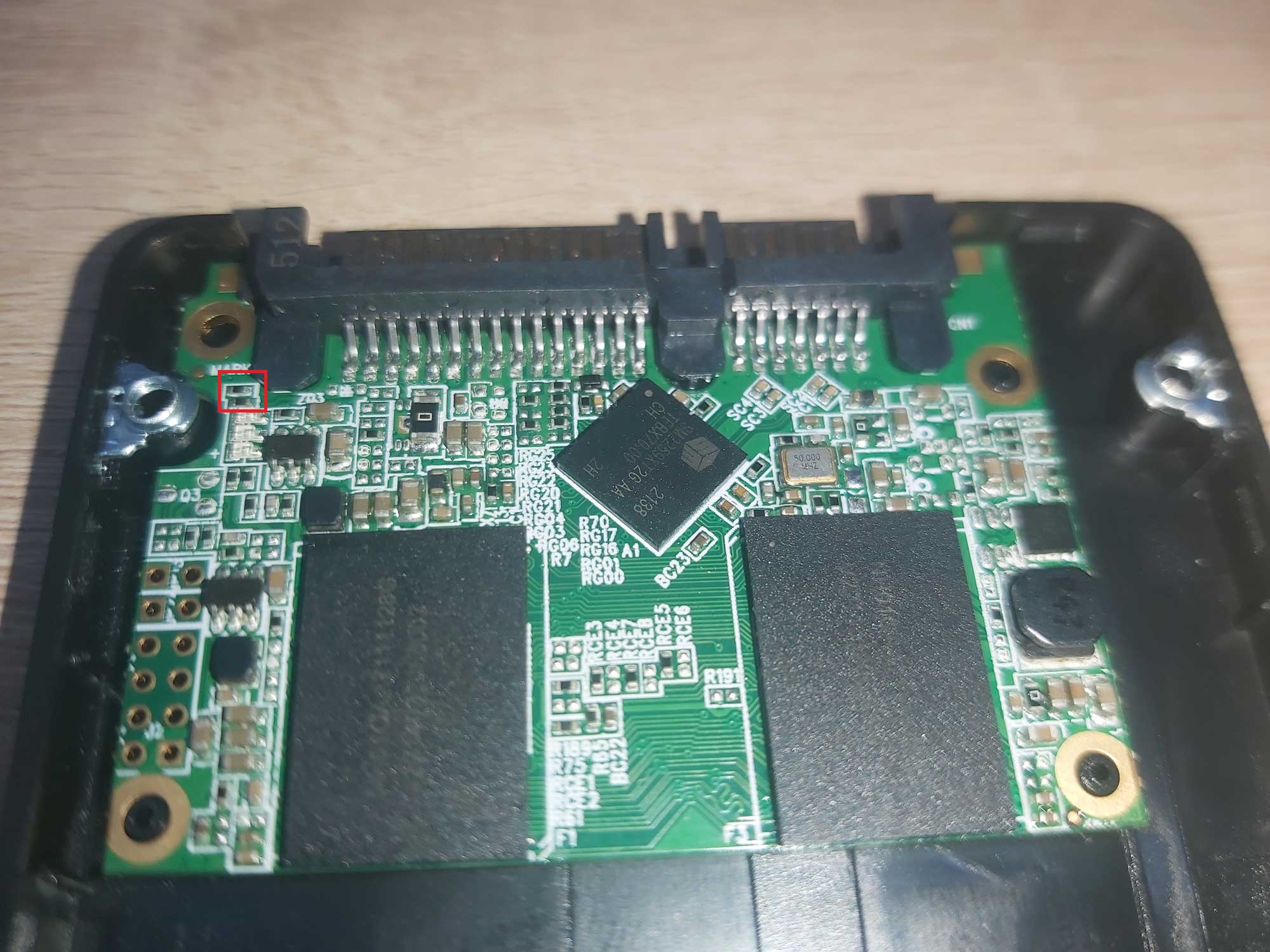

Could you please show the points on the PCB? I have limited knowledge of Electronics :roll:

Ground is any screw hole.
Inductors are those ferrite bodied components adjacent to each of the 3 DC-DC converters. The inductors are shaped like squares with chamfered edges.

Hi fzabkar,
Are you talking about those 2 components?
Thanks in advance for your help.

Posts: 16960
https://image.made-in-china.com/44f3j00yTLlFbnWkSrv/Surface-Mount-1uh-Ferrite-Core-Power-Coil-SMT-Nr8040-1r0-Power-SMD-Inductor-for-Digital-Movie-Cameras.webp
