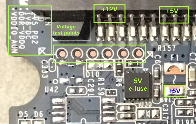

Upload detailed photos of both sides of the PCB and I'll try to identify the voltage test points for you.

Two pictures of both sides (once with direct light, once with indirect light... PCB's and their glare.. ugh): http://imgur.com/a/6aEFG
I noticed a few voltage TP's next to the SATA power connector, and two at the top of the PCB, as well as 3x GPIO pads and 1x 3v3 next to the SATA data connector. I haven't probed them yet.

Posts: 17330

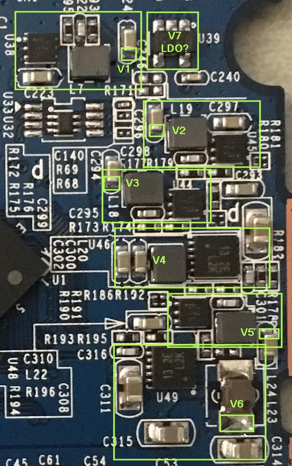

I suspect that the GPIO pins would be the serial port. The T7 pins (on the underside) might be JTAG, but I'm only guessing.
I would measure the +3.3V (3V3) test points. I would also measure the 6 test points near the SATA power connector.
U30 is an e-fuse. There should be +5V at its output.
I have identified what I believe to the voltage test points at 6 switchmode (V1-V6) and 1 possible LDO linear regulator (V7). They are my best guesses. Your feedback should help me to correct any errors.

That is a ton of good information! It does indeed look like a TRION 100, seems that is one of the first Toshiba-made OCZ's before they branded it with their own name.
Measurements so far:
Test points next to the SATA connector (in order of the photo):
5v
GND
2.5v
1.8v
1.34v (most likely 1v3 but my meter probably isn't too exact)
1v
Voltage regulators as tagged on the pictures:
V1= 3.3v
V2= 1v
V3= 1v
V4= 1v
V5= 1.8v
V6= 3.3v
V7: I measured the pins, there is 3, 3v3 and 2v5 on them. Let's say the bottom two pins are 1 and 2 and the top three are 3, 4 and 5 from left to right;
V7-2: 2.5v
V7-3: 3v
V7-5: 3.3v
With regards to the position next to the SATA connector with the four pins where you usually find a serial port/UART:
GPIO 104 = GND
3v3 = 3.3 Volt (as it should)
GPIO 103 = TX
GPIO 100 = RX
When powering on, GPIO 103 goes high for a bit.
The DMM I used is an Extech EX330. Not the worst meter in the world, but it's not a Fluke ;-)
I also checked if all chips seem to consume power, and they do, all BGA's are getting a few degrees above room temperature, so they are definitely getting power. I haven't hooked up a 3v3 serial adapter yet, but I'm not sure what to expect there. There is nothing like a boot log or anything as far as I can detect (I did simply connect a buzzer to TX and GND, it clicked once on boot), it's more like the CPU booting and enabling the GPIO/UART pin than actual data. Also not sure what baud to set if I were to try it out.

I suspect that the SMART data and the 2.06 MB capacity are probably default values which indicate a firmware related problem, but others would be better placed to advise you.
The test points near the SATA connector seem to be OK. The DDR_VDDQ voltage matches the +1.35V supply for the SDRAM.
The other test points also appear OK, although I don't understand why there are so many 1V regulators. Normally I would associate 1V supplies with MCU cores, so I'm surprised that there appear to be 3 of them.
U39 does appear to be a 2.5V LDO linear regulator, although it could also be an adjustable type.
One more thing you could do is to measure the voltages at the two zero-ohm configuration resistors, S4 and S5, on the underside of PCB. These will probably be 3.3V and 1.8V.

I could be wrong, but it seems to me like a NAND problem. High chance the soldering joints have weakened.

More test points ...

Perhaps forum member HaQue might be able to shed some light on how the SSD behaves with a missing NAND IC?
viewtopic.php?f=10&t=32747&start=0

I have a Toshiba Q300 480GB SSD that I have used for 4 weeks without any problem. 2 days ago as I started my laptop and noticed that the SSD is not detected anymore. I have tried to power cycle the SSD more times without any success. I opened it and made the measurements on the V1,V2,V3,V4,V5,V6,V7 points and found following voltages:
V1= 3.05v
V2= 0.9v
V3= 0.9v
V4= 0.93v
V5= 1.67v
V6= 3.04v
V7-2= 2.29v (lower left pin)
V7-3= 2.61v (upper left pin)
V7-5= 3.05v (upper right pin)
What I have also noticed is that the 12V is completely missing when the SSD is connected to the Laptop (0V). The Laptop is bypassing the SSD detection without hanging or any hanging. As I not an expert in SSD, I want to ask you about your opinion. Do you have any hint?
Thank you.

Posts: 20
Location: Germany
I have also measured the points next to the SATA connector (from the left to the right) and got following:
0.9v
1.25V
1.67v
2.29v
0v
4.68v
Any further suggestions? Thank you.
 Post subject: Re: Toshiba Q300 unresponsive
PostPosted: April 24th, 2016, 8:50
Joined: April 24th, 2016, 6:26
Posts: 20
Location: Germany
Hello again, I also measured the V8, S4 and S5, below the values...
V8= 1.24v
S4= 1.67v
S5= 1.67v (upper point)
S5= 3.04v (lower point)
have no idea where to look now...
