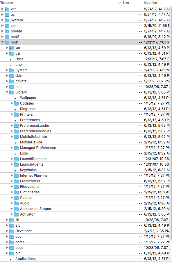

@Bolo: I have a question which is slightly related. I have an iPhone 4 GSM in for recovery. We cannot get access to the phone either through hardware or software fixes. I have been experimenting with a ramdisk technique developed by msftguy several years ago by accessing the iPhone through js and ssh. I can get access to the file system (see pic) but I cannot access user data. I am not sure if this is because the user partition is encrypted of that I cannot access mnt2 (but I can access mnt1). User appears to be just a shortcut. Work stopped on this project a while ago so I have no where else to turn. if you can offer some advice I would appreciate it. Pic of the file system and terminal output is attached.
Any help you can give would be appreciated.

-sh-4.0# ls
-sh-4.0# ls /
System   bin  dev  etc  mktar.sh  mnt1  mnt2  private  sbin  usr  var
-sh-4.0# mount
/dev/md0 on / (hfs, local, noatime)
devfs on /dev (devfs, local, nobrowse)
-sh-4.0# mount.sh
Mounting /dev/disk0s1s1 on /mnt1 ..
Mounting /dev/disk0s1s2 on /mnt2 ..
mount_hfs: Invalid argument
-sh-4.0# mount.sh
/dev/disk0s1s1 already mounted on /mnt1
-sh-4.0# ls /mnt2/
-sh-4.0# ls /mnt1/
Applications  Library  User  boot   dev  lib  private  tmp  var
Developer     System   bin   cores  etc  mnt  sbin     usr
-sh-4.0# ls /mnt2/Users/
ls: cannot access /mnt2/Users/: No such file or directory
-sh-4.0# ls /mnt1/Users/
ls: cannot access /mnt1/Users/: No such file or directory
-sh-4.0# ls /mnt1/Librarty/
ls: cannot access /mnt1/Librarty/: No such file or directory
-sh-4.0# ls /mnt1/Library/
Activator        Frameworks      Managed Preferences  Printers
Application Support  Internet Plug-Ins   MobileDevice        Ringtones
Audio           Keychains      MobileSubstrate      Updates
Caches           LaunchAgents   PreferenceBundles    Wallpaper
Dictionaries        LaunchDaemons   PreferenceLoader
Filesystems        Logs      Preferences
-sh-4.0# ls /mnt1/MobileDevice/
ls: cannot access /mnt1/MobileDevice/: No such file or directory
-sh-4.0# ls /mnt1/Library/MobileDevice
-sh-4.0# ls /mnt1/Library/MobileDevice/Media
ls: cannot access /mnt1/Library/MobileDevice/Media: No such file or directory
-sh-4.0#

FWIW, you keep trying to access Users instead of User ...
    ls /mnt1/User
Could we see the contents of mount.sh? That file/script appears to be the source of the "invalid argument".
    cat mount.sh

mnt2 is not mounted ( mount.sh throws an error about this ) . So, the ls commands to paths initiated in /mnt2 will not work.
Along with the Users think @fzakbar mentioned, you also tried a lot of paths that are not present in the /mnt1 filesystem. The first ls ( ls /mnt1 ) showed the dirs it found.
Were those other ls commands just following some tutorial ?
Maybe some part of path is missing ? From your picture, I guess the thing called MobileDevice would be in a path /mnt1/Library/MobileSubstrate/MobileDevice ( note the /Library/MobileSubstrate/ in the middle )
