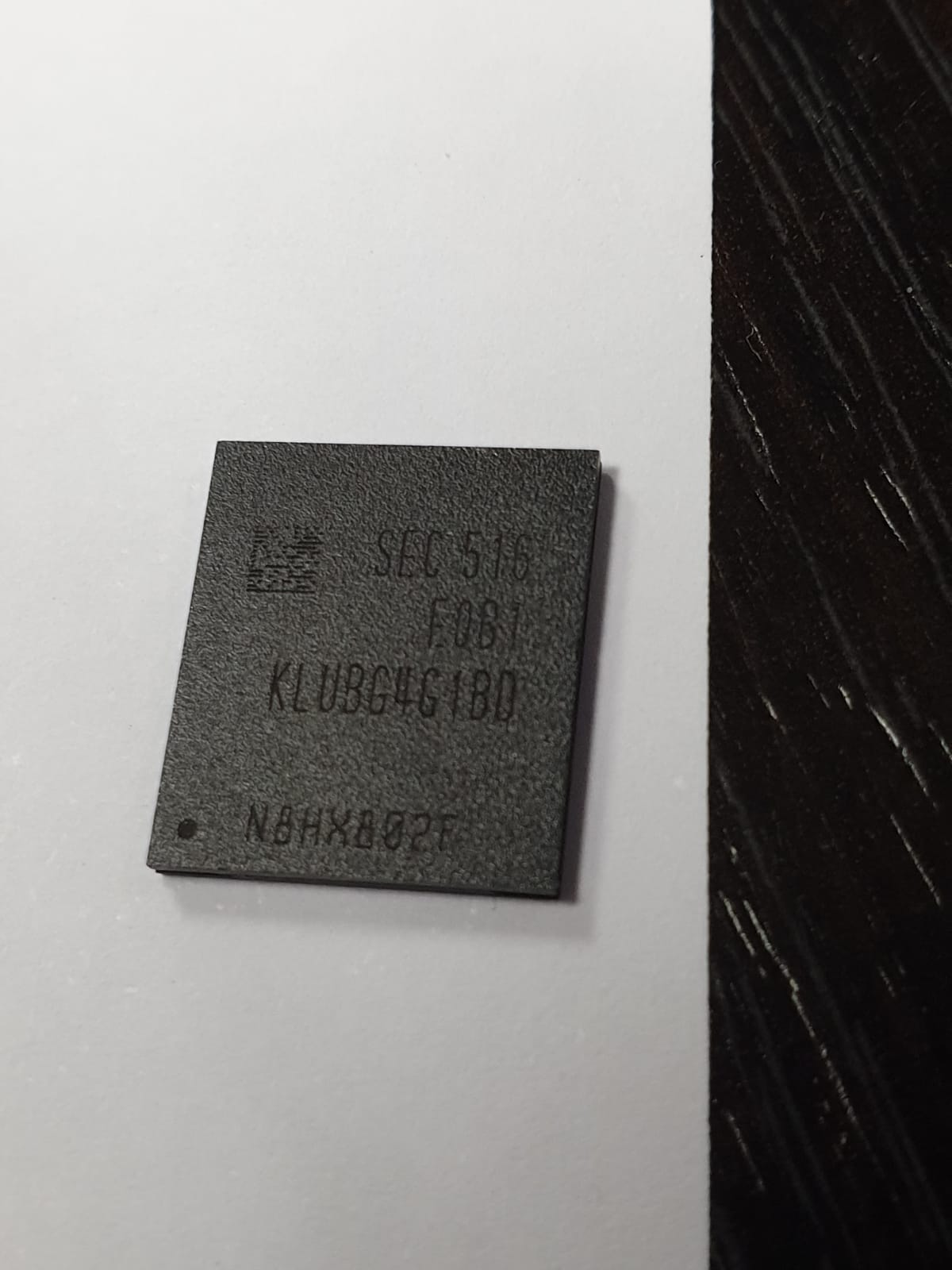

Hi guys!
We've extracted a chip from a Samsung Galagy S6, but it is one we've never seen before. I'm uploading some pictures to see if you could give me hint as to what to do with this thing. We think it combines NAND and RAM in a single chip, but we have no idea what this pinout is called, or what reader should be used.
File comment: Top of the chip

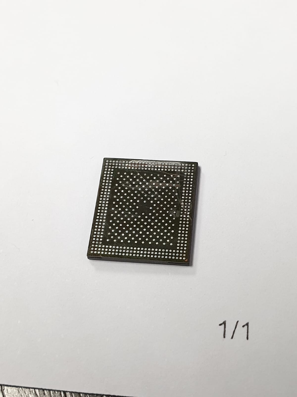

File comment: Bottom of the chip

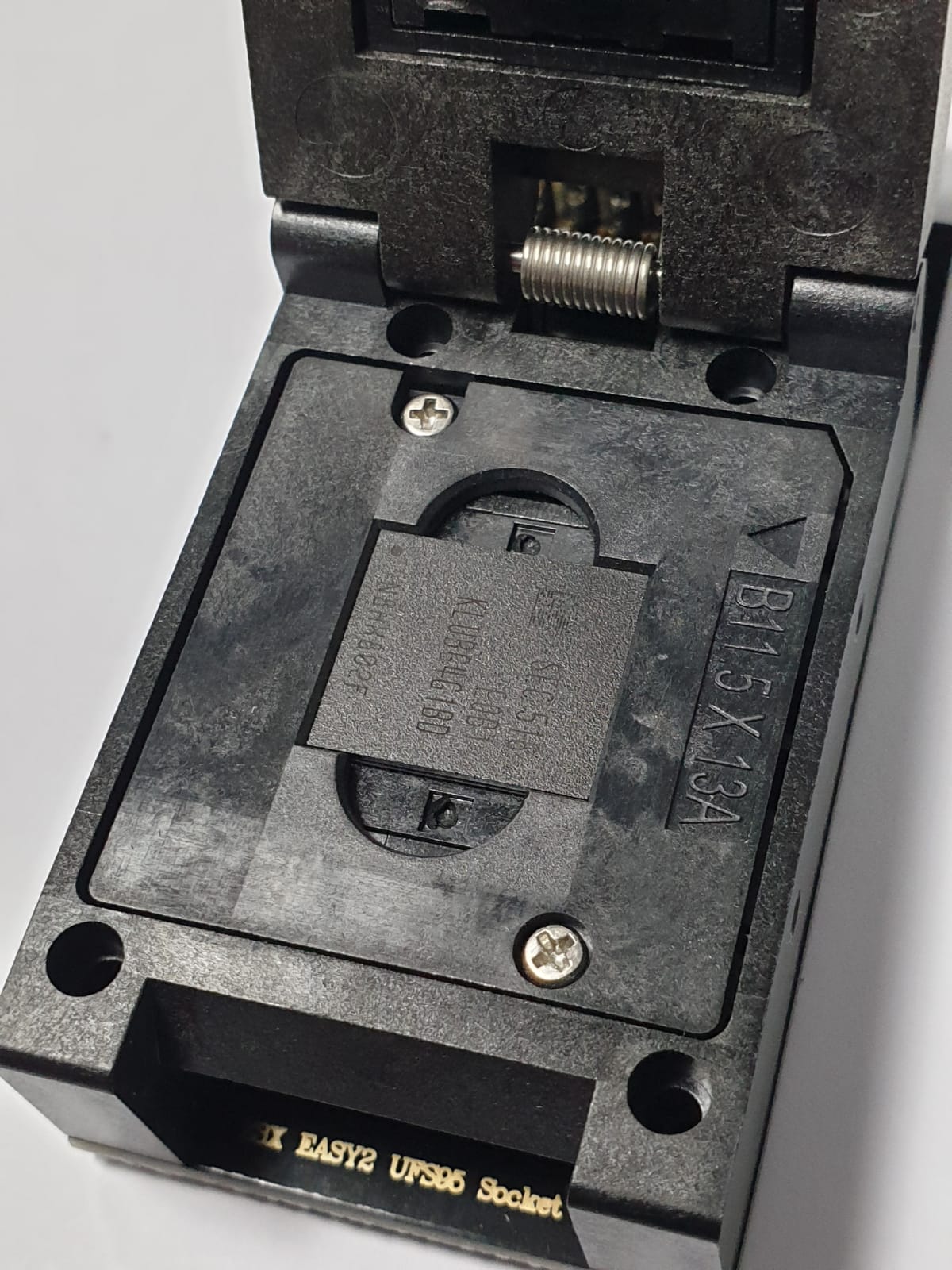

File comment: Chip in reader
The chip kind of fits in the reader, but it doesn't align properly.

Probably a UFS chip
this is one way to do it. NOT easy

and maybe something like this
https://www.ebay.com.au/itm/ICFriend-3-in-1-UFS-Chip-Reader-For-Z3X-Easy-JTAG-Plus-Box-/183800823670

You have removed both controller and the UFS NAND chip. If you look closely you will see the NAND sits on top of the controller and needs to be separated. Not so easy now they are both off the board, but it can be done. So what you are seeing is the top of the NAND and the bottom of the controller.
Much easier to do when first removing from the board.
Wow! You're totally right. The chip already seemed so thin to us that it didn't even occur to us. Thank you very much for your insight! We've managed to remove the chips, though it did require three hands.
