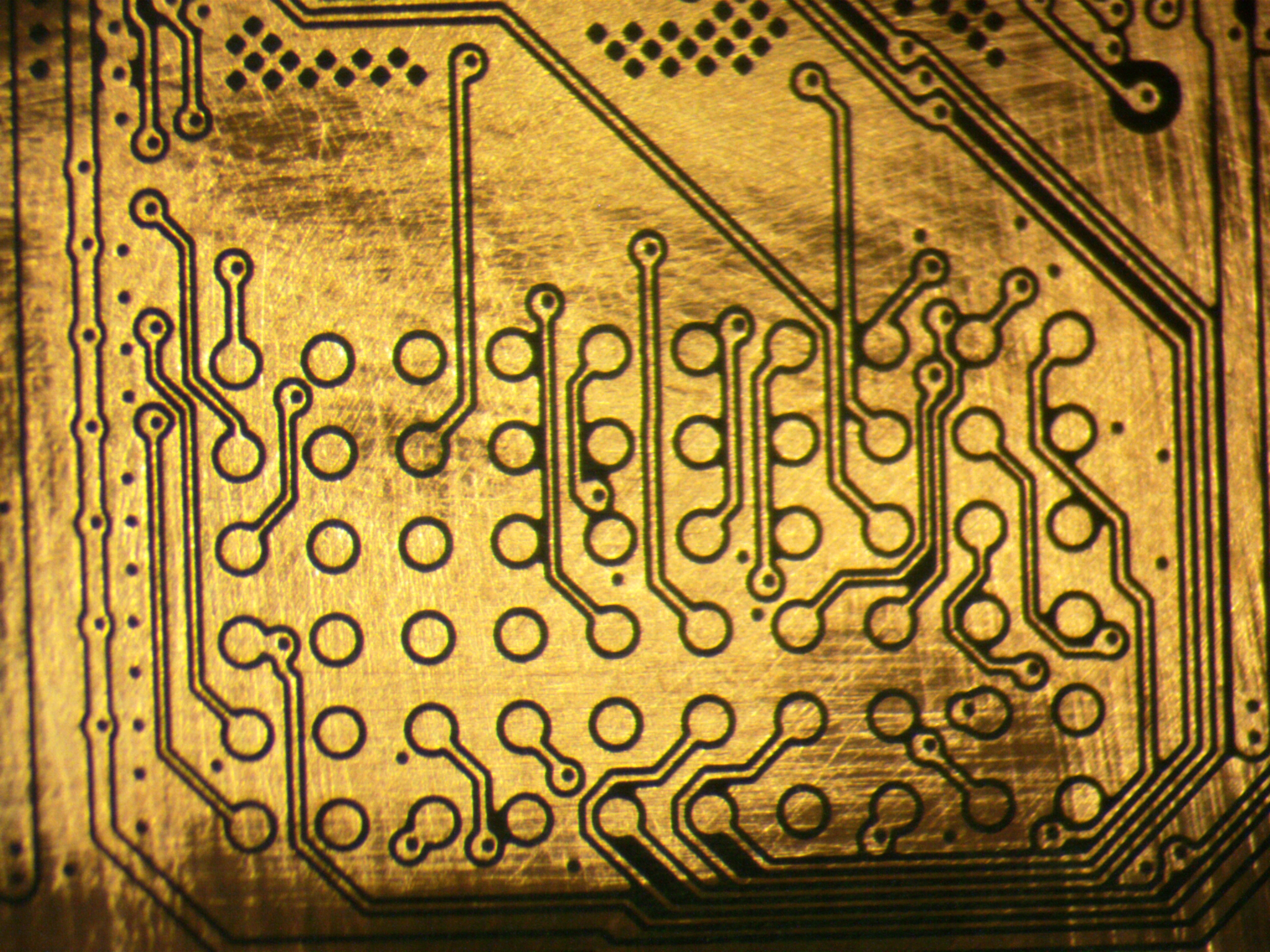

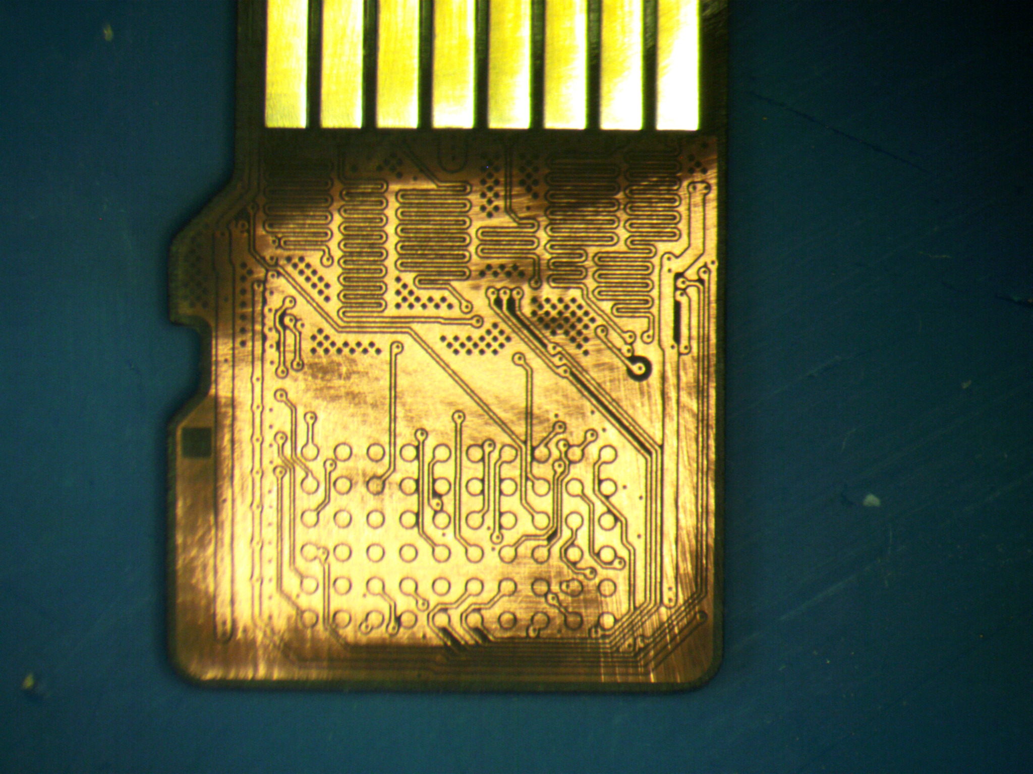

I am not asking for the pinout for this monolith (been around too long for that), but does anyone know if a pinout is available for this Patriot MSD Card? Just wondered whether it worth hanging onto to it if it might become available soon.

There is few models of MicroSD cards with 6x10 pads.
http://odzyskiwanie-danych.com.pl/image ... arvika.jpg
Pinout is done for this cards. Your can be same or could have different, because for 6x10 cards there is 2 or 3 different pinouts. But pinout is not a problem.
This cards use LDPC alghoritm for ECC correction. Nobody crack it so far, so without it case will be unrecoverable.

Thanks great information. Thank you.
