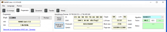

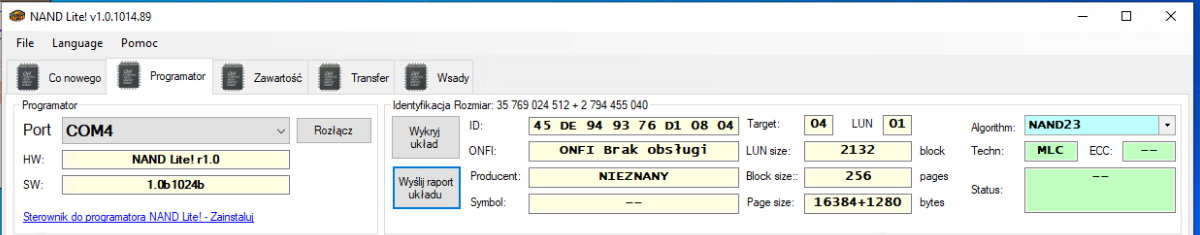

Hi all,
I'm doing some experiment to trying a data recovery on a CF with a broken controller.
So, after chiped-off the NAND, I dumped it with a NANDLite reader.
Now I have to descrable and re-mix it to reconstruct a "clean" image.
NAND ID: 45 DE 94 93 76 D1 08 04
Flash Extractor has an entry for it, but I don't have flash-extractor: http://flash-extractor.com/library/SanD ... 94_93__2x4
If you have flash-extracotr, it would be nice to have some information about XOR file: 7718_256 v2.
Any help would be appreciated,
thanks
File comment: My NANDLite configuration
