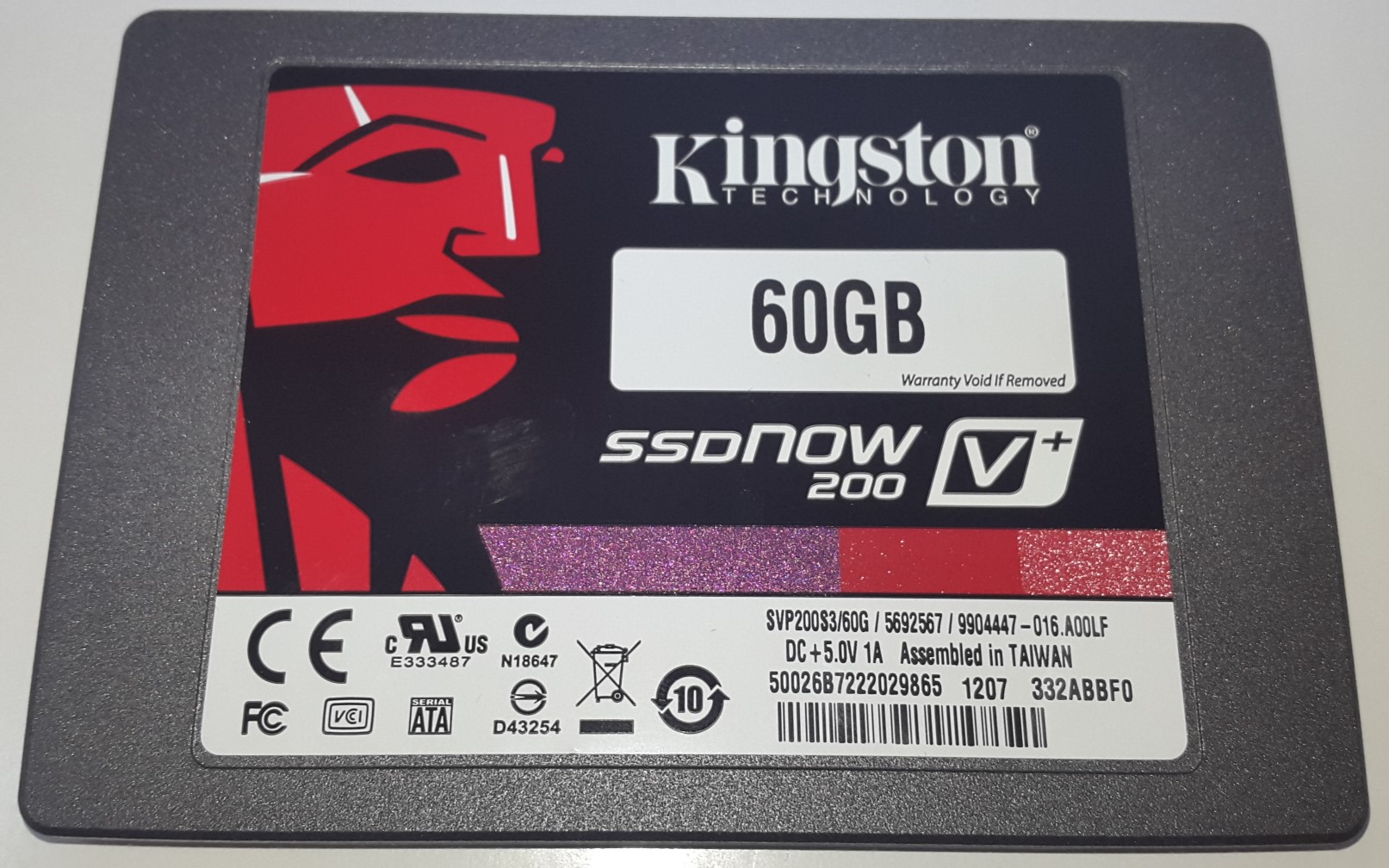

We've got in an SSD for recovery. Kingston SSDnow 200 V+ SandForce SF2281.

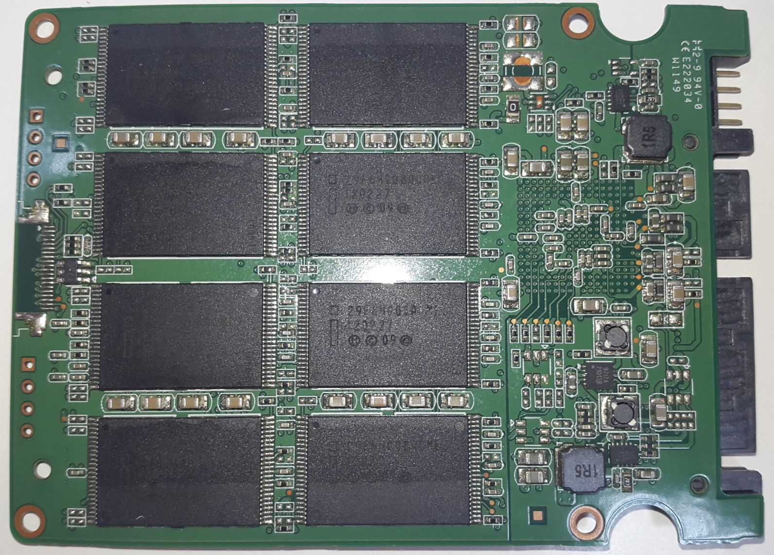

After making some measurements i got to the conclusion that all voltages seems to be ok. All rails are ok.
Also no bad shorted to ground capacitors. No visible burnt resistors under the microscope.

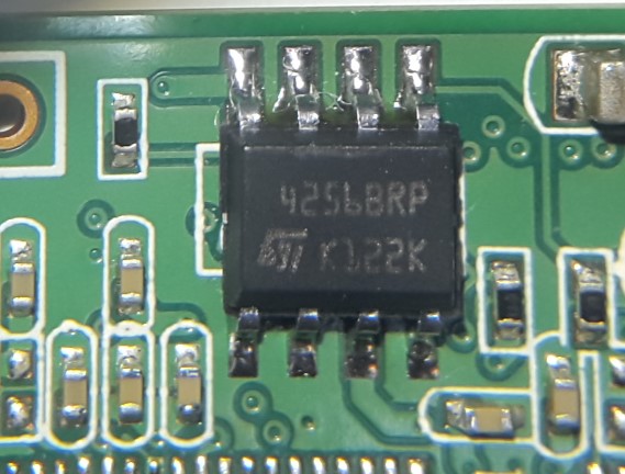

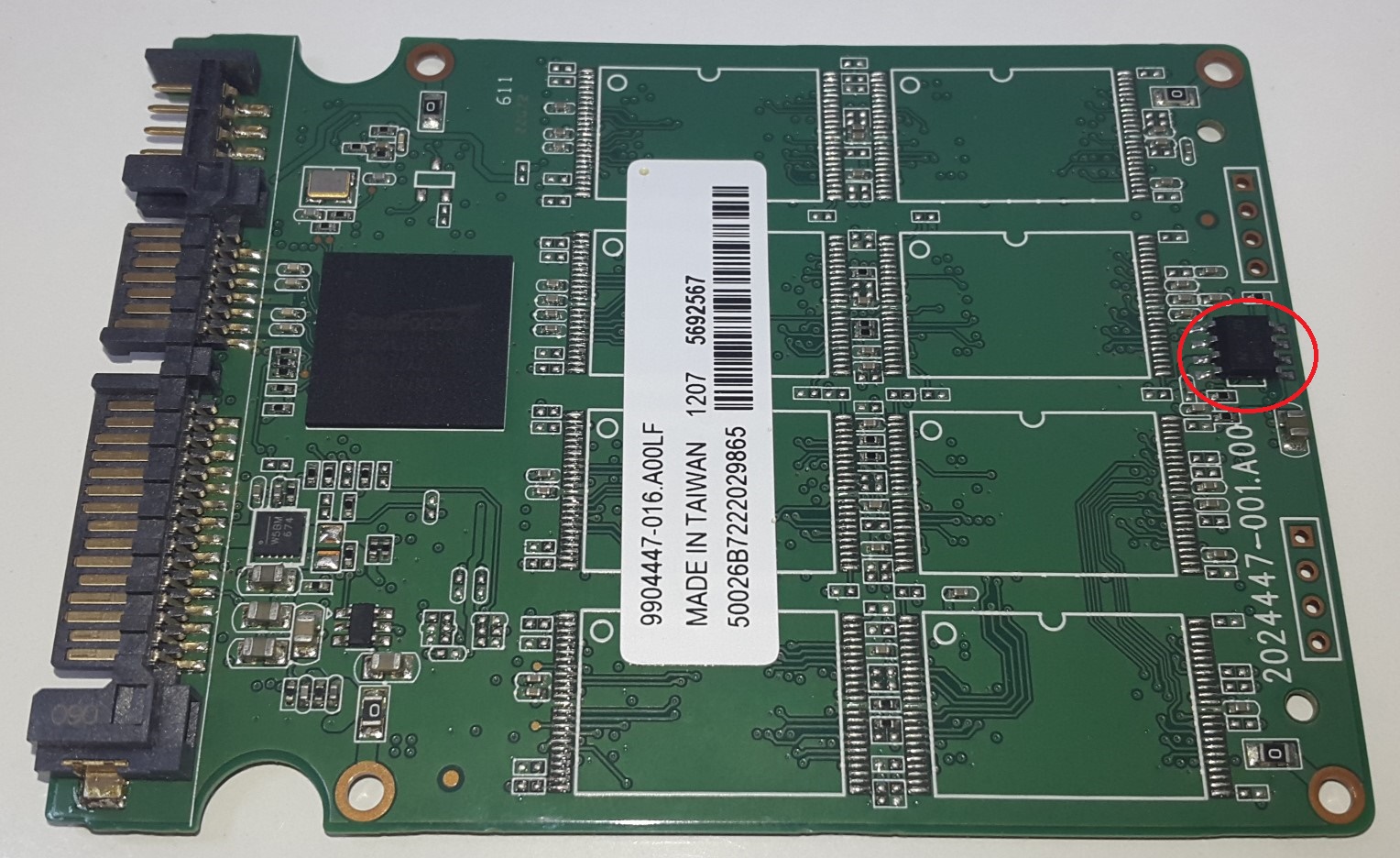

I noticed this one has an eprom on board
Which in other cases is missing from the board:
https://forum.hddguru.com/viewtopic.php ... ngston+200
https://forum.hddguru.com/viewtopic.php?f=10&t=36313
https://forum.hddguru.com/viewtopic.php?f=10&t=35783
It is an I2C EEPROM of 256 Kbit (32Kbyte) from ST M24256BR. Datasheet here: https://www.st.com/resource/en/datasheet/m24256-br.pdf
I tried to read with external programmer, and it seems pretty dead, as it reads only ff ff ff ff.
Judging by it's size (32k) i guess it can be some boot code inside. I think it might be the cause of the problem.

I tried with Willem and TNM5000. I can read chip on both but all is FF FF.
After that i tried to fill with random values, write, read and compare values.
Chip seems to be ok, but somehow it got empty.

As I said it's an I2C EEPROM, it uses AT24Cxx Algorithm, it has nothing to do with microwire 93cxx series.
It's supported by both programmers as 24c256, i can read / write and it works fine.
The problem might not be at all in this eprom, maybe it's not even used. A conclusion can be made only if compared with a working one of the same model.

FF in EEPROM , for Sandforce SF2281 it is ok. They should be empty this way, moreover, if you remove ROM from working good SF SSD , it will work.
For SF1222 , things are different of course.
Search for issue with your SSD elsewhere.
Regarding update file VIC , it is encrypted and contains many things including microcode, many overlays and a lot of listings. If you want you can decrypt it and can see all that staff.
