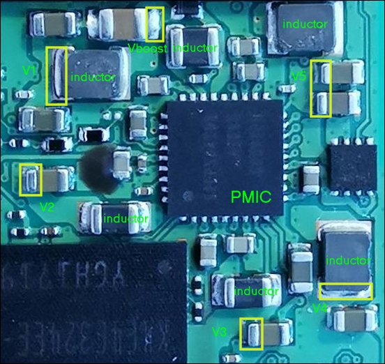

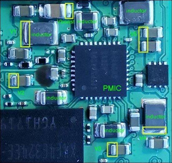

The adapter does have an NVMe bridge (JMS583).
I would measure the following voltages on the SSD:

 Post subject: Re: Samsung NVMe PM591 (MZ-VLW5120)
PostPosted: March 29th, 2020, 6:46
Joined: March 26th, 2020, 10:43
Posts: 6
Test are made on NVMe -> USB adapter
v1 (inductor) - 1.835 V
V2 - 1.084V
V3 - 1.79V
v4 (inductor) - 1.084 V
V5 - 1.249 V
vboost - 12.02V, after some seconds it start going down to 0.3 v and then gets down to 0.20v
PostPosted: April 23rd, 2020, 3:18
Posts: 17368
ISTM that the supply voltages are probably OK. It may be that the SSD has a "firmware fault".

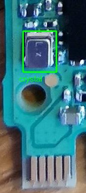

PostPosted: May 9th, 2020, 17:18
Posts: 17368
This looks like the crystal:
The crystal is cut from quartz which can be shattered by a sharp impact. Often you can hear the shards rattling inside the metal case.
AFAIK, there is currently only one [very expensive] professional tool that can deal with NVMe SSDs at the firmware level. In any case I believe recent Samsung SSDs have not yet been reverse engineered (due to encryption).
