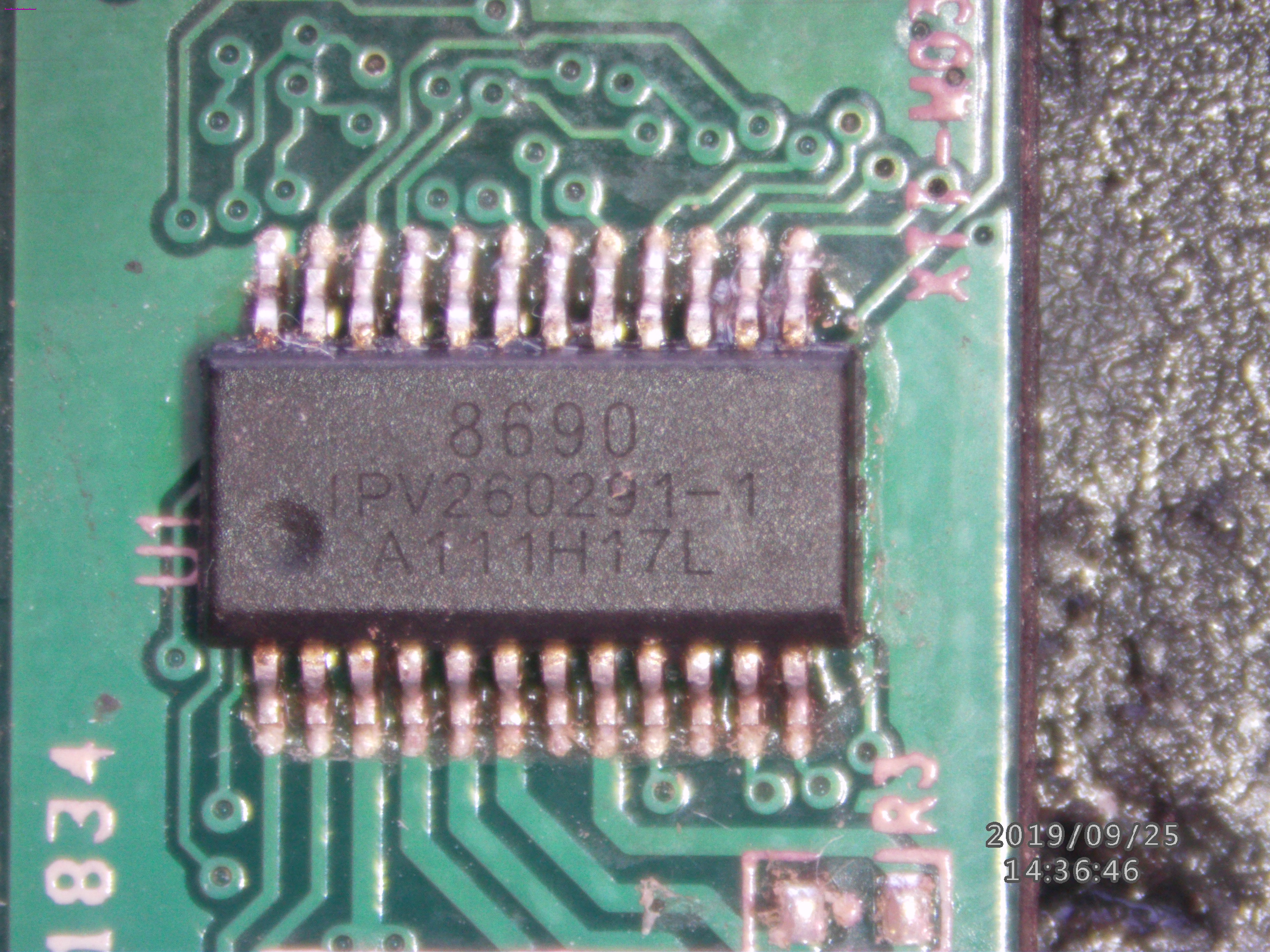

Does anyone have any information on this blob NAND controller?
I can't seem to find any info on it. Most importantly the pinout since chip "off" isn't really going to work for this blob.

so the nand is a blob?
I would think this is probably something like an Alcor controller, common for them to be used on blobs.
Cant say Ive seen one of these though.
might be a case of finding pinout using same method as monolith discovery... or look on some of the flashboot, usbdev sites for any pinouts of SOIC-24 and compare.

My internet research, and suggestions from others, is making me think this might be a rebranded ChipsBank CBM2099E controller.
Does anyone have the pinout for that one? I hear it's in FE database but I'm not a flash extractor owner as of yet, so hoping to do this in PC-3000.

is it possible to see full pics of both sides?
sometime there are similar PCBs and can give hints as well.
if you can end up dumping it, there probably won't be much of a mix, and likely easy recovery.
somewhat similar
http://flash-extractor.com/library/CBM/CBM2099/CBM2099E__ad_de_14_a7__1x1
http://www.flash-extractor.com/library/AU/AU9386/AU9386__c1_76_c1_76__1x1
http://www.flash-extractor.com/library/AU/AU9386/AU9386__ad_f1_80_15__1x1__v2
http://flash-extractor.com/library/CBM/CBM2099/CBM2099EA__89_84_64_3c__1x1
http://flash-extractor.com/library/ITE/GST1176/GST1176E-28B__45_de_84_93__1x1
If you can dump it and wanted to share dump, I would be happy to do it for you no charge

Okay, so it seems it's not a CBM chip at all but rather is a Micov Technology MW8690
Anyone have a spec sheet or pinout for this thing? They don't even seem to have a functional website, so contacting them for a spec sheet is probably a dead end.

Reverse Engineer the pinout, not complicated :-)
PC3K can probably solve the rest..

doesn't reversing the pinout rely on device being operational?
 Post subject: Re: Anyone Recognize this Controller?
PostPosted: October 1st, 2019, 11:11
Joined: December 29th, 2016, 18:13
Posts: 158
@HaQue: no, you can find pinout in 99% cases even on dead device. You need operational "donor" drive only in case you require XOR, LBA or ECC patterns.
Yes and No..
In most cases the controller will boot up and issue a few commands before deciding its dead, as long as those commands are successful I can usually solve a pinout.
If the controller is dead (rarely the case, maybe a fuse, or someone overheated the chip w/ hot air) its a little harder but its still possible to get a general idea of the pinout from the NAND chip without a logic analyzer or XRAY.
Generally speaking donors are last ditch efforts, I typically only use them to reverse engineer manufacture commands or layouts where working media is necessary.

Assuming we're talking about an identical drive. data-medics sent me a donor to solve the pin-out, it's a regular 8bit controller, I solved the pinout but technically in the deal we worked out they "own" the pinout as they wanted to do the work on the clients drive themselves so I can't really share it but if you want to work out something with them feel free. :-)

I don't mind you sharing it on a limited basis. I was only asking that I get the pinout provided to me because I couldn't send the client drive out and wanted to have it for future reference.
Unfortunately in my case, the NAND seemed to be completely dead. Never got the tiniest response at all.
