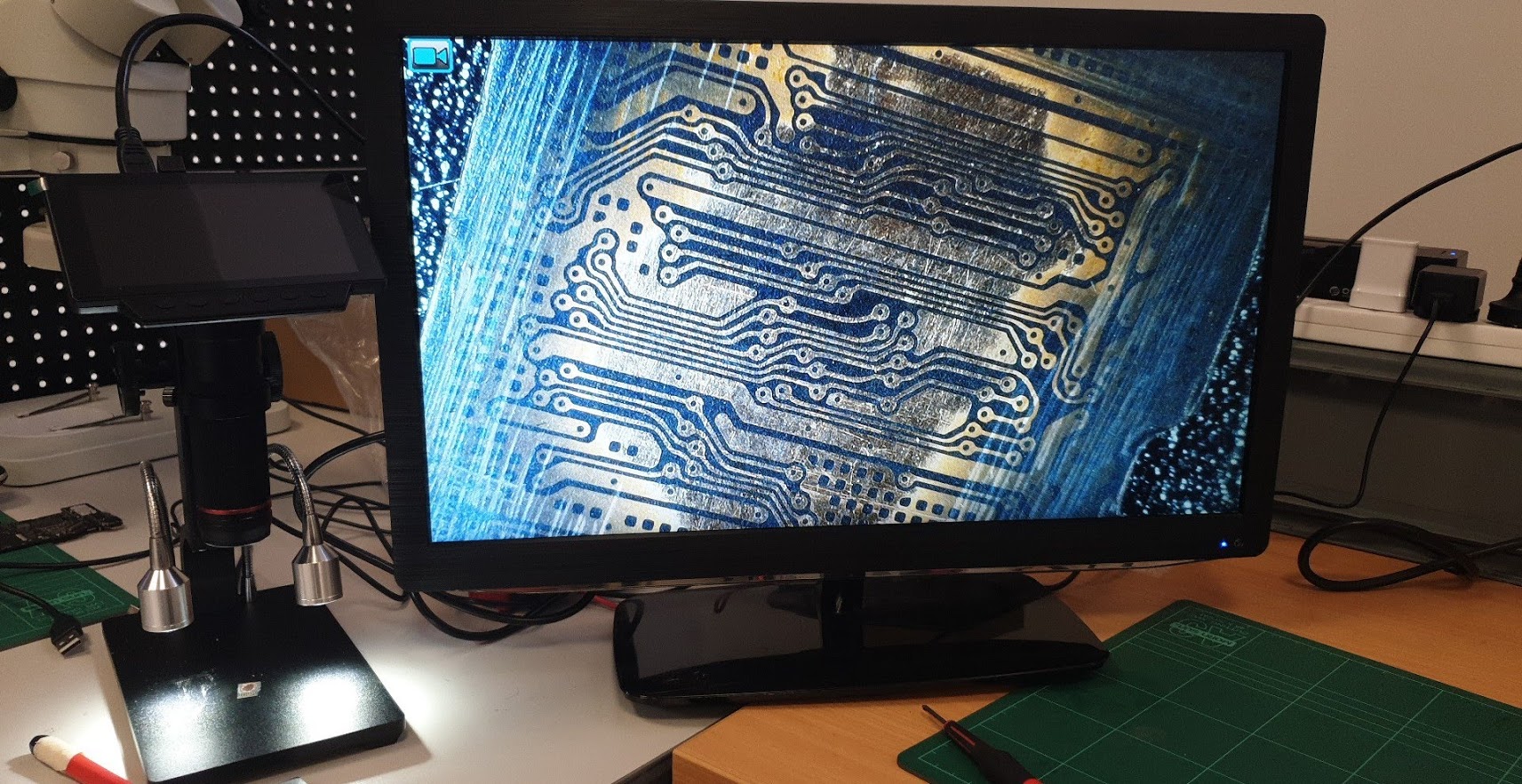

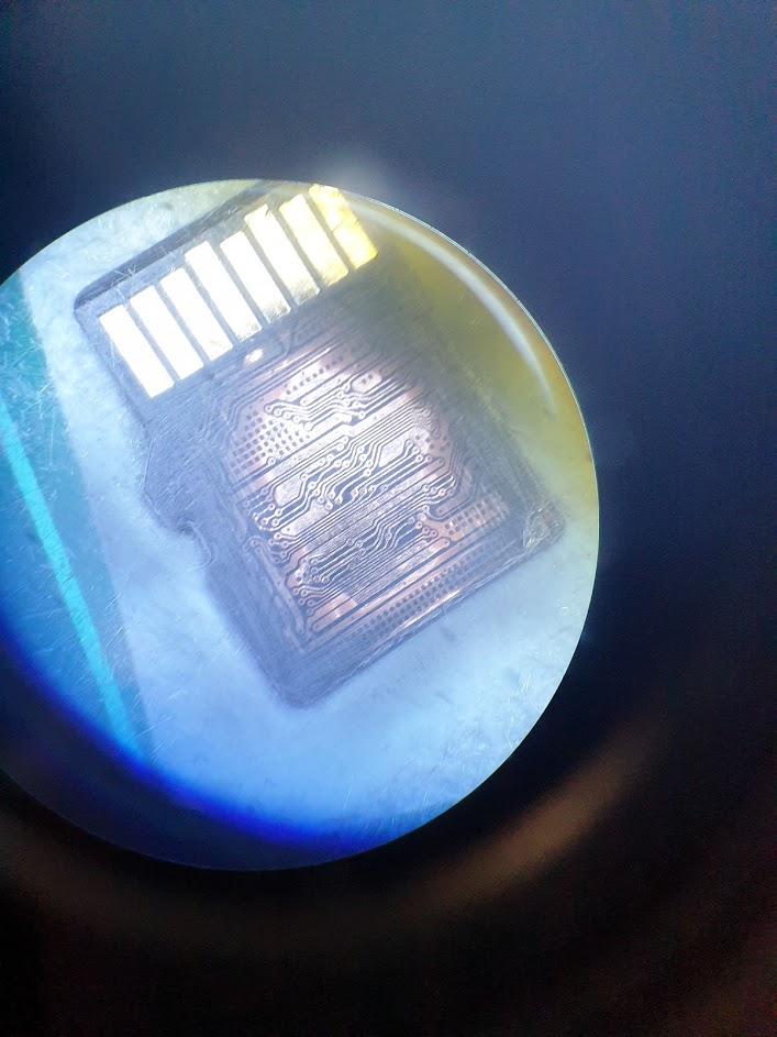

First time poster!
I have an IT repair shop in Adelaide, and a friend of mine has asked me to recover the data from their micro SD card.
I have a bit of experience with Data Recovery. I have a Rapidspar and recently upgraded about 6 months ago to an MRT ultra. We do get the occasional USB / Thumbdrive in etc.
So , two questions.
1. Is a PC3000 Flash worth the investment in time AND learning ? With the way my business is set up, I can just about spend 90% of my time doing what I want.
2. Does anybody have a pinout guide for this micro SD card ?
USER_SCOPED_TEMP_DATA_MSGR_PHOTO_FOR_UPLOAD_1591944915914_6677100928598097635.jpeg [ 447.22 KiB | Viewed 9120 times ]

Is PC-3000 Flash worth it, sure if you get in enough cases to make it worthwhile. The fact that they have a lot of ready-built solutions for some of the most common flash devices can make it one of the easiest systems to use (for some cases). With the spiderboard you may not even have to do any soldering to monoliths such as this.
However, you should know that flash recovery is no walk in the park. It's frustrating and tedious and most people (myself included) just don't have the patience for it. You can easily spend a week working on a case only to finally find that it was a massive waste of time.
There are some drawbacks to the PC-3000 system. For one, the reader hardware doesn't seem to be the best. There have been a number of cases where a cheap flash extractor reader got a better dump than the PC-3000 could even with multiple re-reads. But, generally speaking Ace is a great company that offers excellent support and regularly updates their systems.
Also, don't expect that Ace will provide you with every monolith pinout. That one you show there isn't in their database. In fact, I don't even see it in Arvika's database of ones he's figured out. So there will be no easy path to recovery in this case I suspect.
