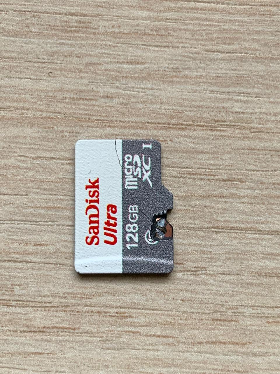

Hello!
Does anyone here do this kind of service? Please PM!

Perhaps you should be looking for a faith healer. :lol:
That thing needs more than an engineer, it needs an actual miracle.

Doable.. with the right tools, which I don't have, whatever data was in the exposed silicon is lost though :-(
I'm saving up for an electron microscope :lol: :lol: :lol: :lol:

Looks NOT doable to me (sorry), and we are recommended by SanDisk globally.

I'm saying we get them from all over the world and that looks unrecoverable.. By us and I believe by anyone. If someone thinks they can recover a MicroSD cracked through the middle like that, and not JUST a small edge chipped off, then please do let me know..
Just doing a hypothetical thought experiment.
NAND memory is non-volatile so I don't think cells outside the damaged area would loose their charge, so they'd retain their data.
I think the issue would be reconnecting the damaged bit lines and pipe gates to the memory stack.

Yes, just would not ID with any NAND readers so no way to get to the data..
