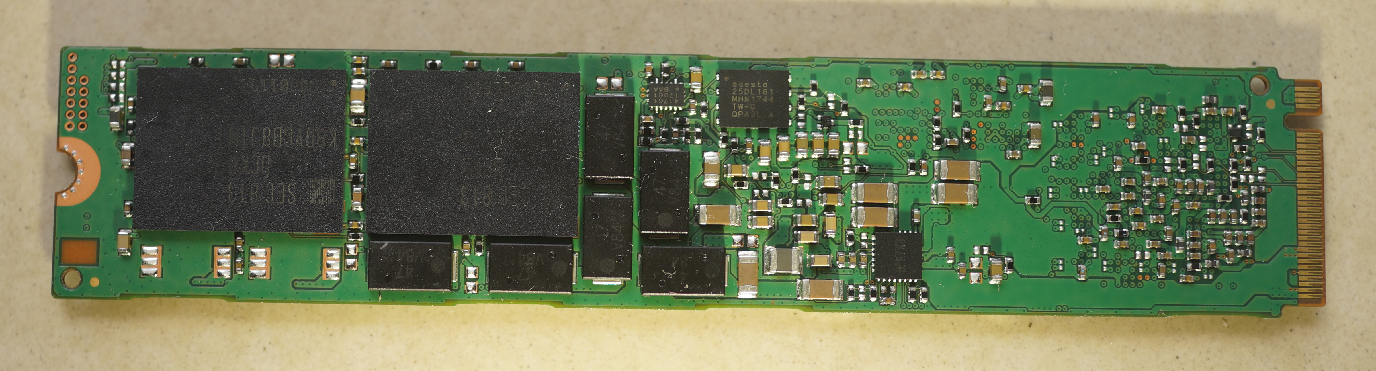

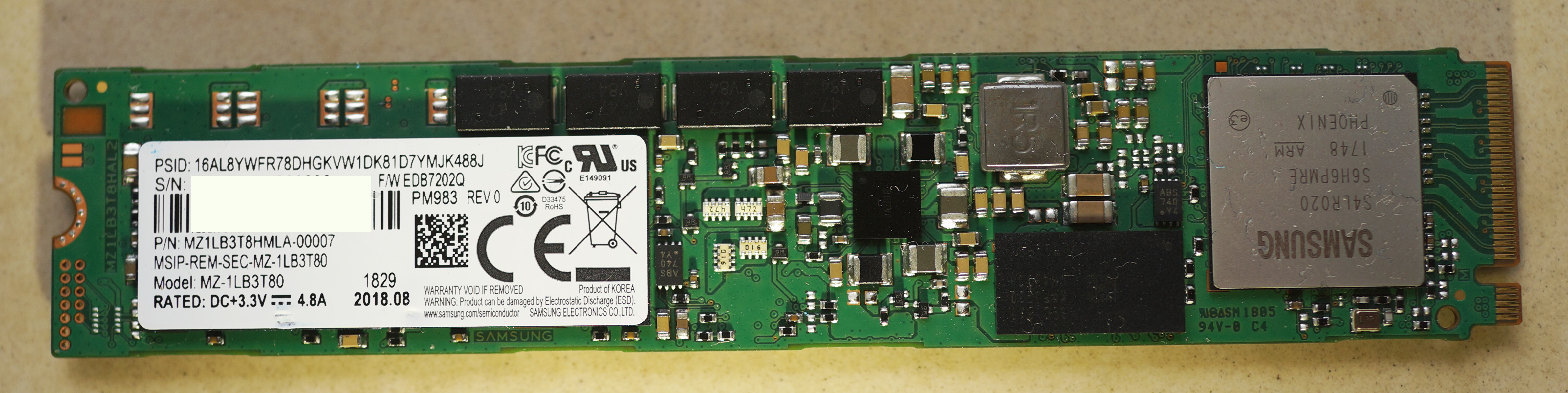

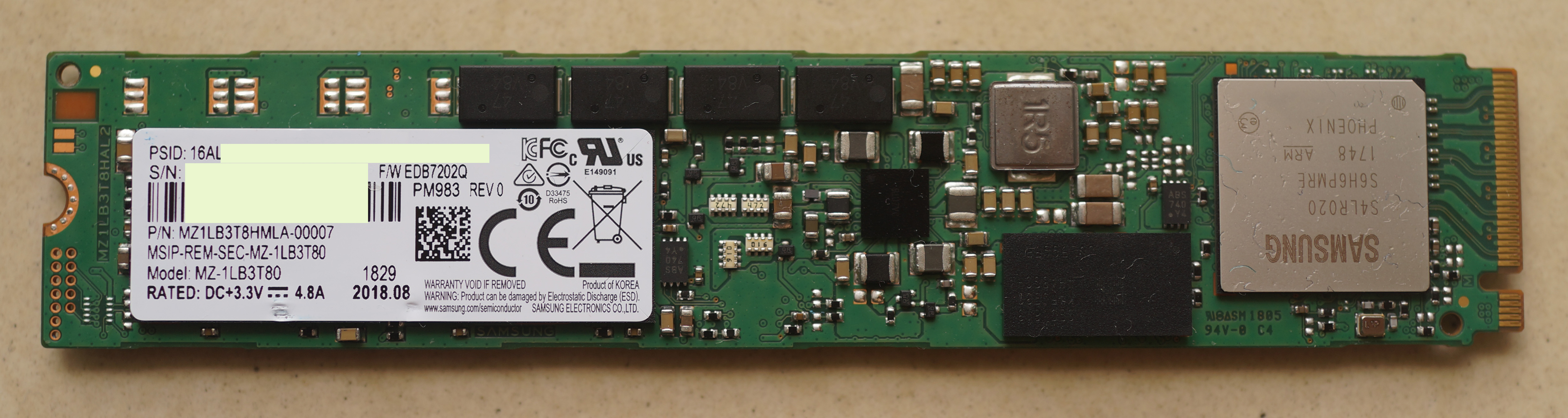

I doubt that there is an electronic failure, but we could at least measure the onboard supply voltages to confirm that they are within spec. Could you upload hi-res photos of each side of the PCB?
The exercise may not help you, but it may help others.
 Post subject: Re: PM983 3.84TB M.2 MZ1LB3T8HMLA-00007 ERRORMOD&1G,how reco
PostPosted: June 5th, 2019, 3:08
Joined: June 1st, 2019, 3:11
Location: Europe
@fzabkar, find attached high res photos of the PM983.

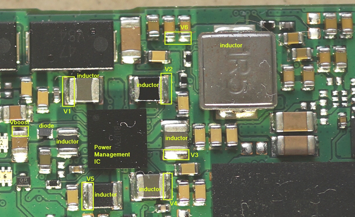

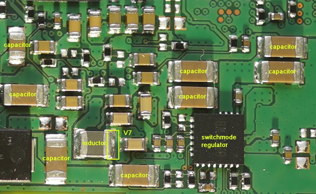

PostPosted: June 5th, 2019, 4:03
Posts: 17231
I would measure the voltages at V1-V7, Vboost, and the voltages across the indicated capacitors. Also measure the voltage across the large array of backup capacitors.
I don't expect that there will be any problem, but it's a relatively easy check.
