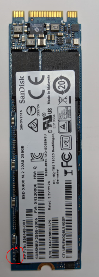

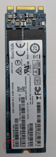

Hi guys,
Any experience with Sandisk SD8SN8U-256-1006 ?
This SSD was in HP Laptop, laptop stop booting, drive not recognized without reason, no water, no drop.
Those aren't supported by ACE
I can imagine debug is what I circle in RED. I've tried to mount with external case, not recognized at all.
Sam

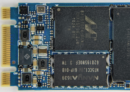

Yesterday i do this model with success. There was some problem with contact on some elements. Try LITTLE heat or frozen.
 Post subject: Re: Sandisk sd8sn8u M2
PostPosted: August 20th, 2020, 15:25
Posts: 17335

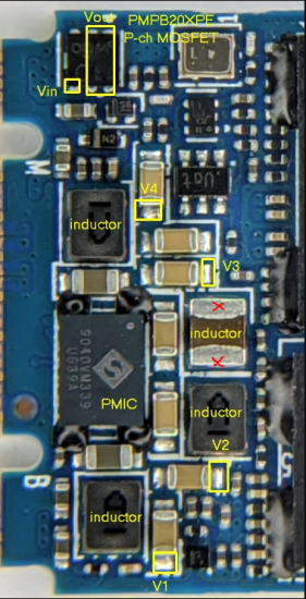

If you can provide a better photo, I can show you the voltage test points. IIRC there is a high-side MOSFET load switch which supplies power to the PCB via the DEV SLEEP pin. This is a common problem, at least on other SanDisk/Apple SSDs.

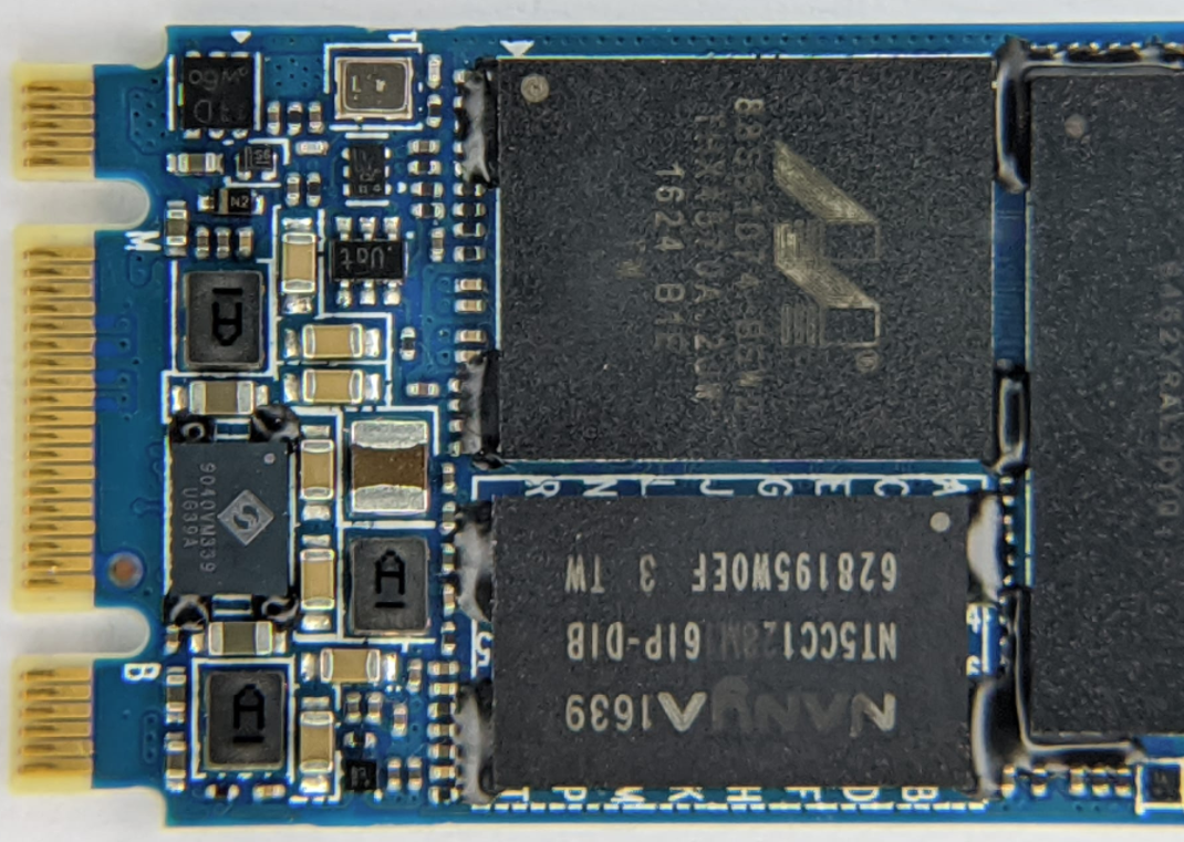

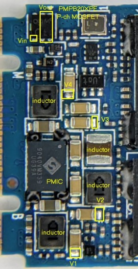

Thank you guys. I've attached a better pics, hope it's good enough.

I have same problem on Asus Zenbook.
I connect drive to my pc3000 and drive was fully identified under DE.
After two weeks I was able to get data back, not 100%, but customer was satisfied with results.
From my observations, there is some problem in FW.

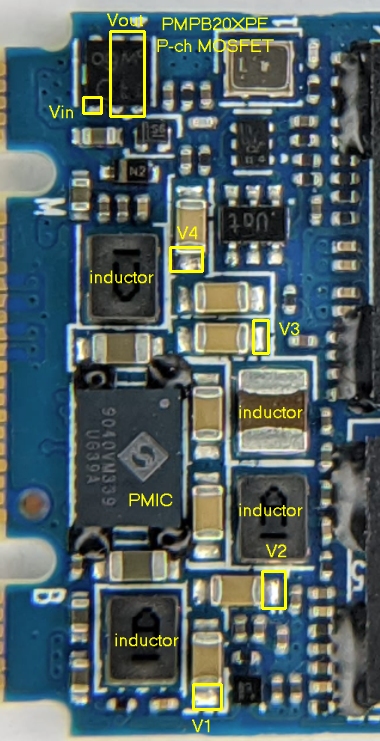

Hopefully I have identified the correct pin on each capacitor. If not, then measure the voltage at the other pin, or the voltage across the capacitor, or at the inductor.
PMPB20XPE, NXP, -20V, -10.3A, P-channel Trench MOSFET, marking 1D, DFN2020MD-6 (SOT1220):
https://assets.nexperia.com/documents/data-sheet/PMPB20XPE.pdf
http://chip.tomsk.ru/chip/chipfile18-x.nsf/all/C3479264BEB2373C46257DC1001E5E49/$File/PMPB20XPE.pdf

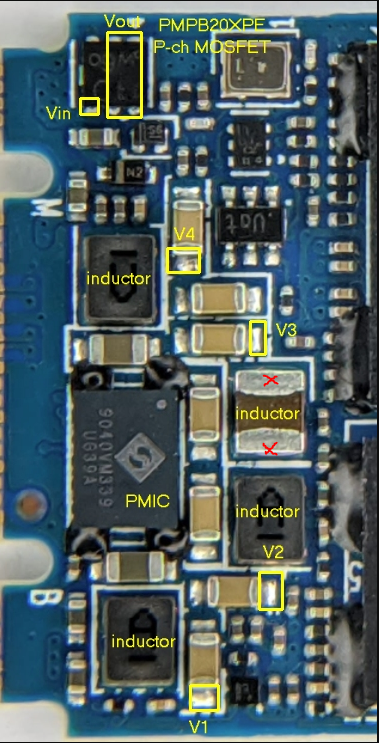

Thank you, that's really helpfull.
I got power accross capacitor
v1 =1.356
v2 =1.052
v3 =2.707
v4 =1.805
Vout=3.257
That doesn't look bad.
I measure 0.0 on the brown inductor, I've put a red cross where I measure it. I don't know how to measure the black inductor.
Sam

Those voltages seem reasonable, although you would need to compare them with a working SSD to be sure.

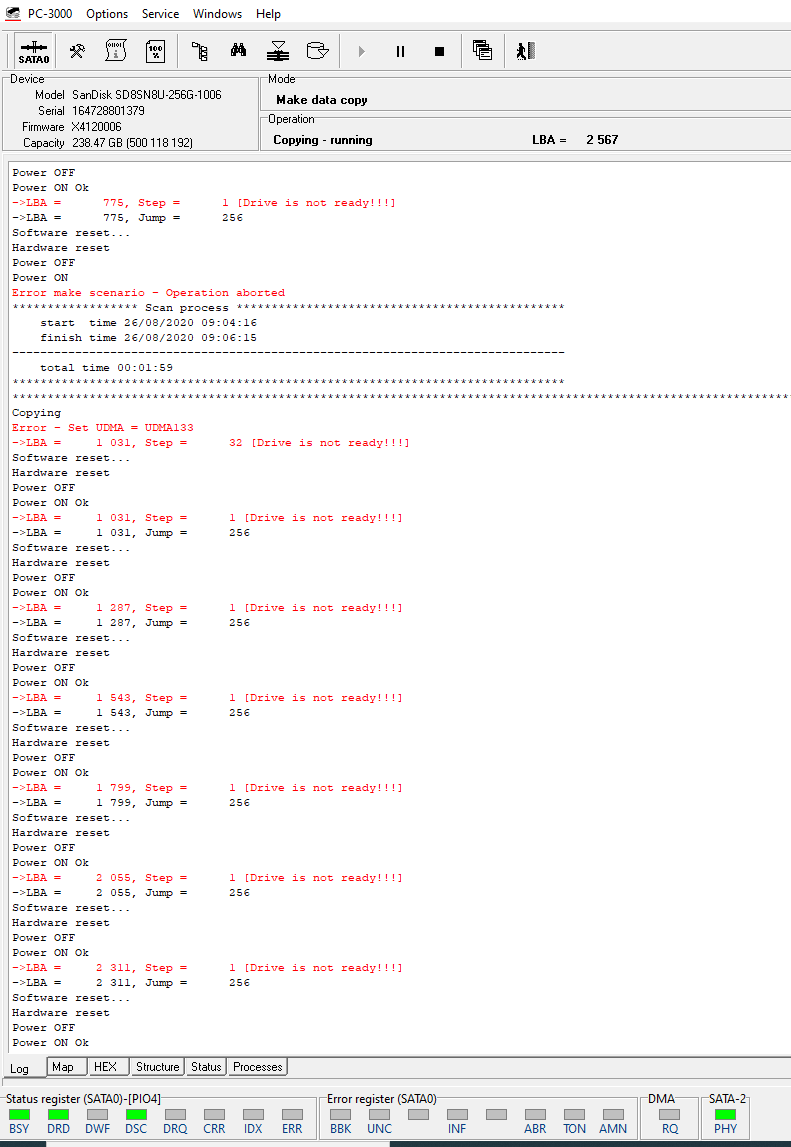

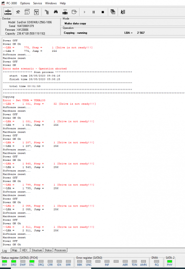

Using freeze spray and heat gun, I get ID now but I wonder if it's worth, Map is 98% yellow others are red and it's going to take forever.

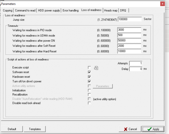

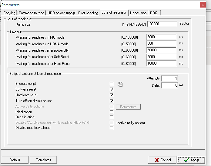

I've changed settings following advice I received.

put also 3000 to UDMA settings instead 500
