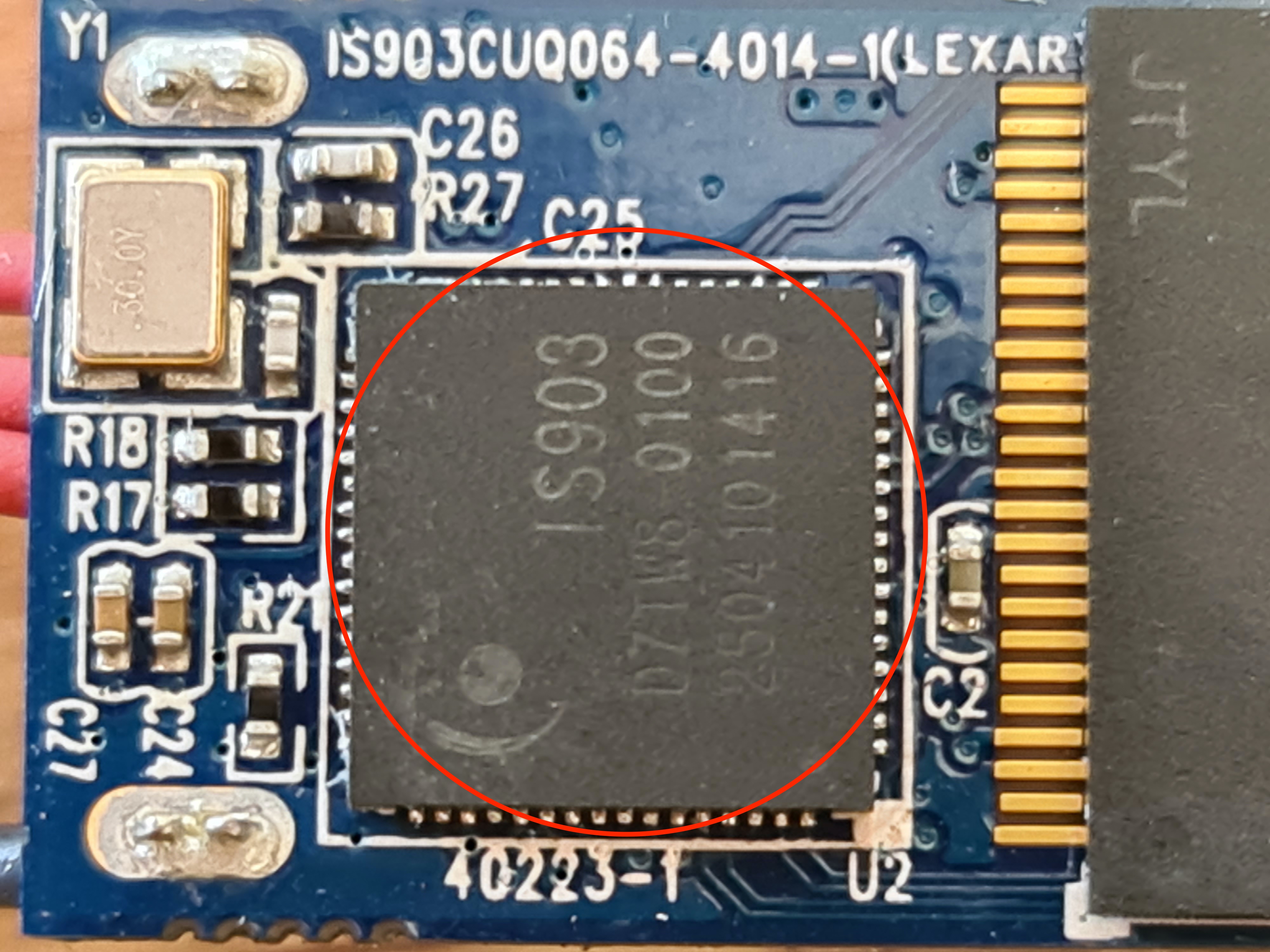

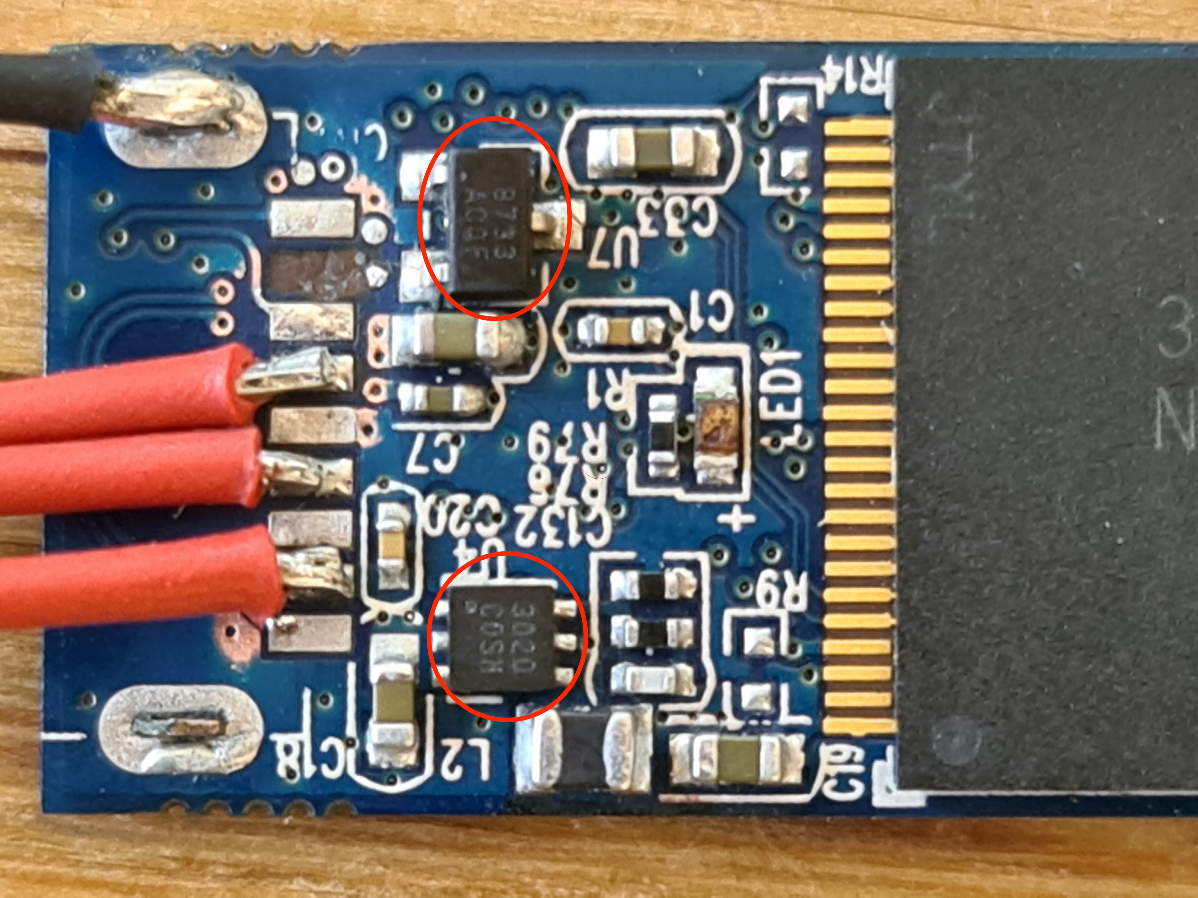

Got this USB-stick with broken contact.
I desoldered the old one and just connected a new through wires.
Now the problem is that the stick is heating up quite qick.
Anyone with experience of this and can help me troubleshoot?
I circled the components thats getting hot.
Many thanks!
PS. I soldered the wires to a USB 2.0 contact instead of 3.0.

you don't say what pinout your wires are connected by (+ GND D- D+)
The PCB could have bent and shorted something if it is a multi layer board, or a component could have failed when the damage occurred.
You are right, sorry. From the top, GND (black), D+, D-, +5VCC.
The PCB was bent.. guess I need to find a new pcb.

is the LED at LED1 burnt?
looks like it, yes

"3020" is probably the Vcore regulator. Check for a short to ground at L2.
EML3020, ESMT/EMP, step down DC/DC converter, Vin = 2.5V - 5.5V, 1A, TDFN-6, marking 3020:
http://www.micro-bridge.com/data/EMP/EML3020.pdf
Datasheets for HDD memory ICs including EEPROM, EPROM, flash:
http://www.users.on.net/~fzabkar/Datasheets/DATAURLS.HTM
"8733" is probably a 3.3V linear LDO regulator. Check its Vout pin for a short to ground.

http://www.innostor.com/file/Innostor_IS903_Specification.pdf

does it show up after you soldered new one?maybe just cool it with fan til you get data recovered?

ESMT/EMP, EMP8733, Fast Ultra High-PSRR, Low-Noise 300mA CMOS LDO, marking 8733, SOT-23:
http://www.micro-bridge.com/data/EMP/EMP8733.pdf
