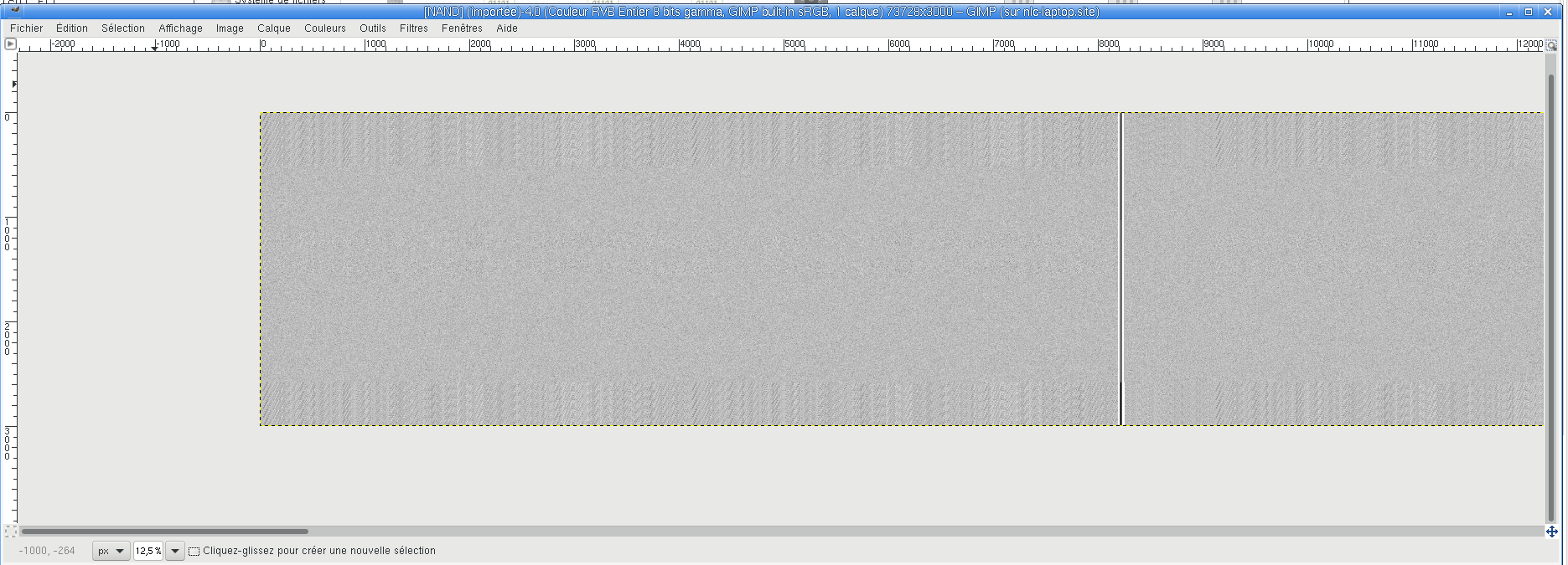

For the first time of my life, I need to recover a memory chip, an eMMC from Hynix
The internal controller is died. I unsoldered the chip from the board, buy a BGA153 adapter and was able to recover 100% of data from 2 partitions.
But on 2 other partitions (128MB and 5.2GB), the eMMC answers 128MB of zeroes and 5.2GB of zeroes.....
After the read of a lot of documentation to understand how eMMC work, I discovered it's possible to directly access the low level Flash Nand memory of the eMMC, because all manufacturer install non documented pad under the BGA chip, probably for test or initial programming purpose ?
Thus I ordered the right BGA adapter to be able to access these specific Nand signal without soldering. I hope it will arrive quickly :)
The first step was to access this nand signal, when I will receive the adapter, it will be okay.
The second step will be to dump the Nand content, and thus to have a Nand flash programmer. I just have one chip to read, I don't want to put a lot of money.
And I love the diy concept :))
I know it's not very difficult to read Nand, because I am an hardware/embedded software developer and already designed board with processor + nand flash.
So I think the best 2 options for low cost Nand reader are :
- FT2232 chip + Linux software (I only work with Linux) : https://spritesmods.com/?art=ftdinand&page=2
- STM32 development board, with custom software.
I bought the 2 boards (should arrive tomorrow), but my preferred solution is the STM32 development board with custom embedded software. I choose the NUCLEO-F446ZE board.
With a 180Mhz and hardware bus natively compatible with Nand signal, the dump will be quicker than the F232 chip + linux software solution.
I am absolutely not worried about this second step
The third step will be to understand the dump. For now I am not worried because I also read a lot of documentation, and I absolutely understood every concept we need to understand.
Of course there are high level software to do that, like Visual Nand Recovery, but for a single flash to recover, it's not possible to buy a licence, that's too expensive :/

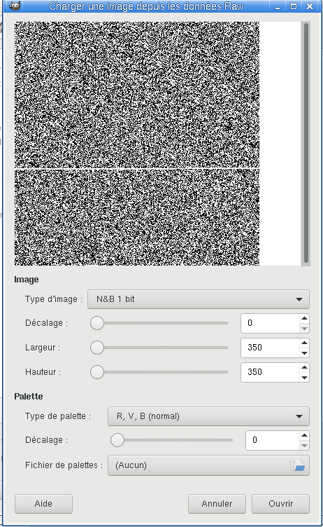

So I played with some raw Nand dump available on internet, and begun to play with them. In all case, was able to understand the nand page formatting, where and how to find bad columns, data zone, spare area zone, etc...
It's very easy to detect this parameters with a Visual view of the dump. No need too have complex software, it's easy to open the raw data as raw image, I use Gimp for example :
On the first one, the repetitive pattern we can see is the XOR key (All the block containing zeroes with XOR key = XOR key), and it's relatively easy to get it graphically and export it to file.
When the internal architecture is understood, I think I will be able to extract and build the logical data with some hours of coding in C or Python

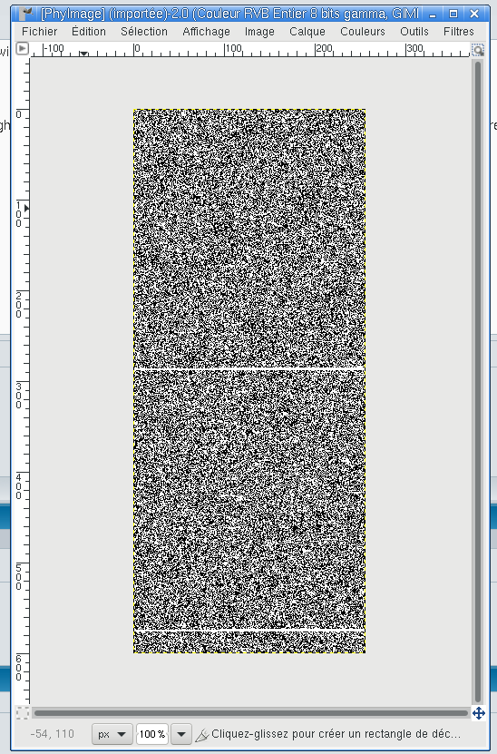

Im interested in how you got the binary dump to display in GIMP like that?
 Post subject: Re: Which NAND flash reader ?
PostPosted: May 19th, 2020, 11:23
Joined: May 12th, 2020, 11:27
Posts: 43
Location: France

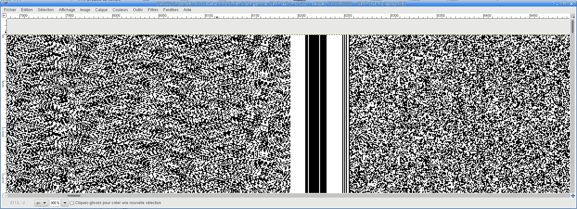

It's really easy, just set .data extension to the file, and open the file with Gimp as "raw data". In the preview windows, you just have to set black and white 1 bit image :
You have have to choose the right width. You can open a first time with 256 pixels width and 600 pixels height, and normally you are able to understand the page size because you will see some repeated pattern like white or black line :
Here the end of white line is on coordinates 256/288, thus 73728 bits. So the Nand has 73728/8 = 9216 bytes per page. 8192 for data and 1024 bytes for spare(s) area(s)
You can after open the raw data with this right width.
Warning if you want to display a lot of page, image will be big. I have 16GB Sdram on my laptop thus it's not a problem ^^

In the Gimp preview page, you can also choose the data offset you want. Thus you can Display any part of the dump, with the number of page you want.
I think it's not needed to display the entire dump file. The goal is to view some blocks, just to understand how the page data are formatted : data zone(s), ecc zone(s), logical page number, logical block number, etc....
When the structure is found, I think all the next steps can be run in a console, without the dump view.
To manipulate the dump file quickly and reorder blocks to build the logical dump, I plan to just use a tmpfs on Linux. Thus all file manipulations will be done in RAM, thus no hard disk access, it's really fast.

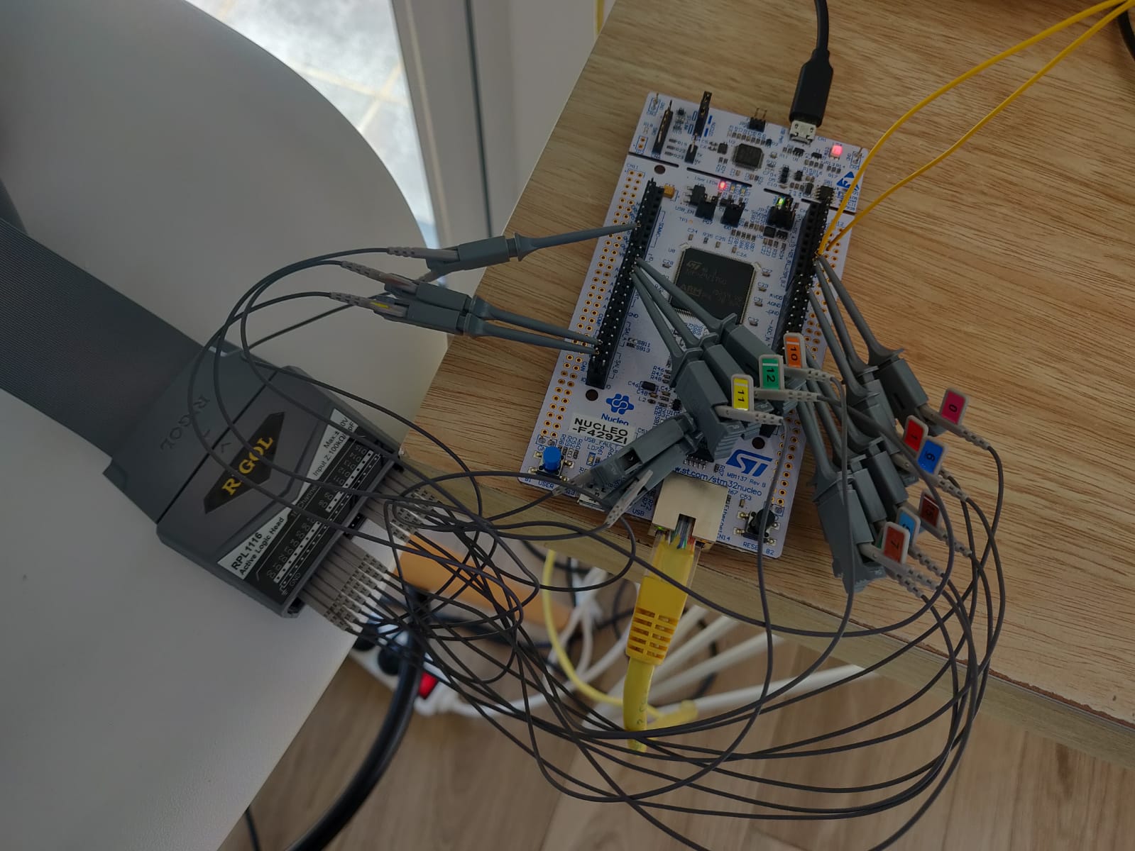

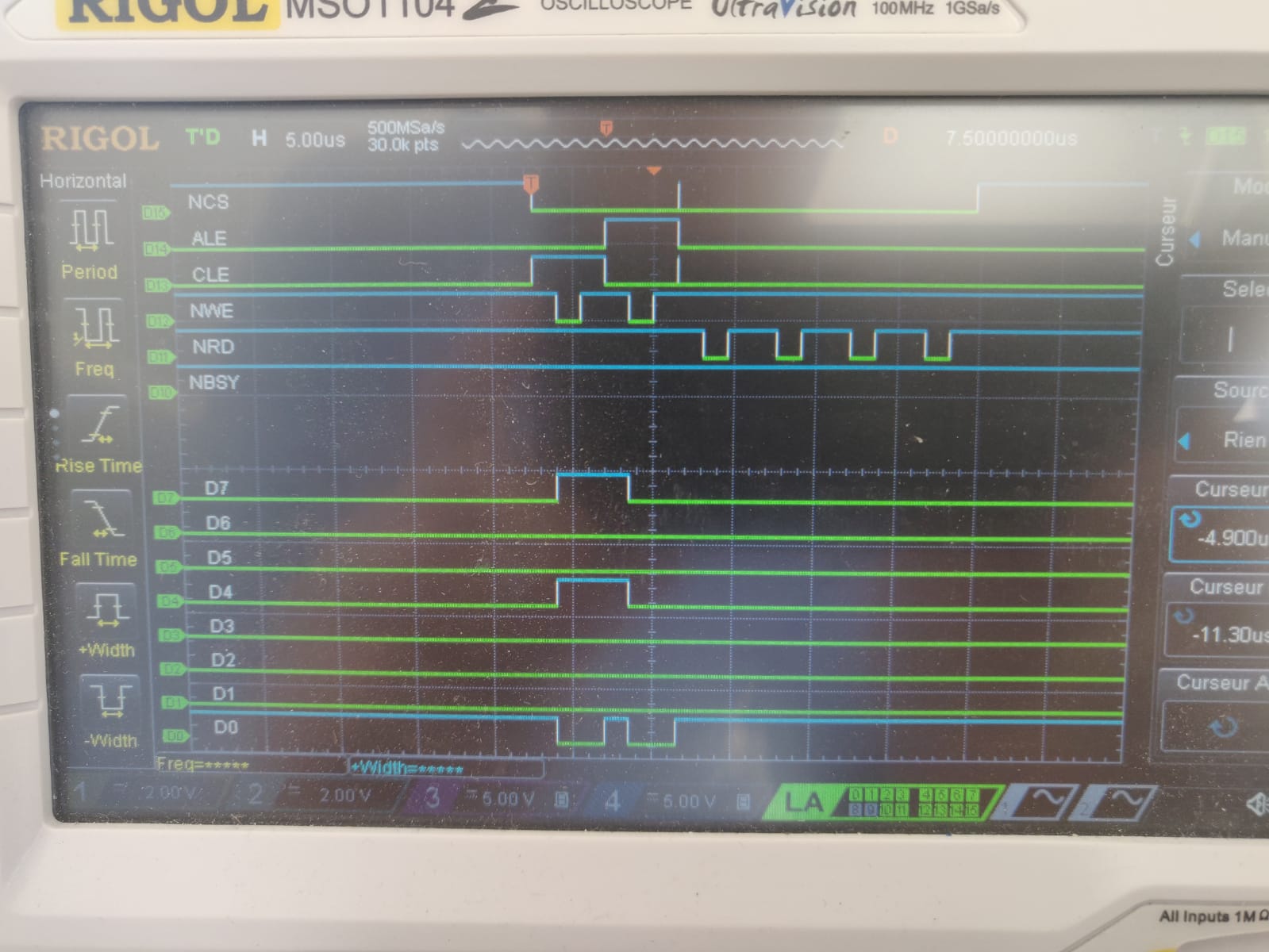

Some news : I wait for my eMMC nand adapter, but my nand reader based on a Nucleo F429ZI dev board is ready :
The board is attached with ethernet to my computer, my linux software sends read page command to the board with the desired address (with a simple UDP based home made protocol), and the board answers with the page data (8832 bytes for the Nand I need to read I think).
I am really happy I can reach ~2.5MB/s read rate :)

Nice work. Are you able to issue an ID command, what is the ID of the NAND?
