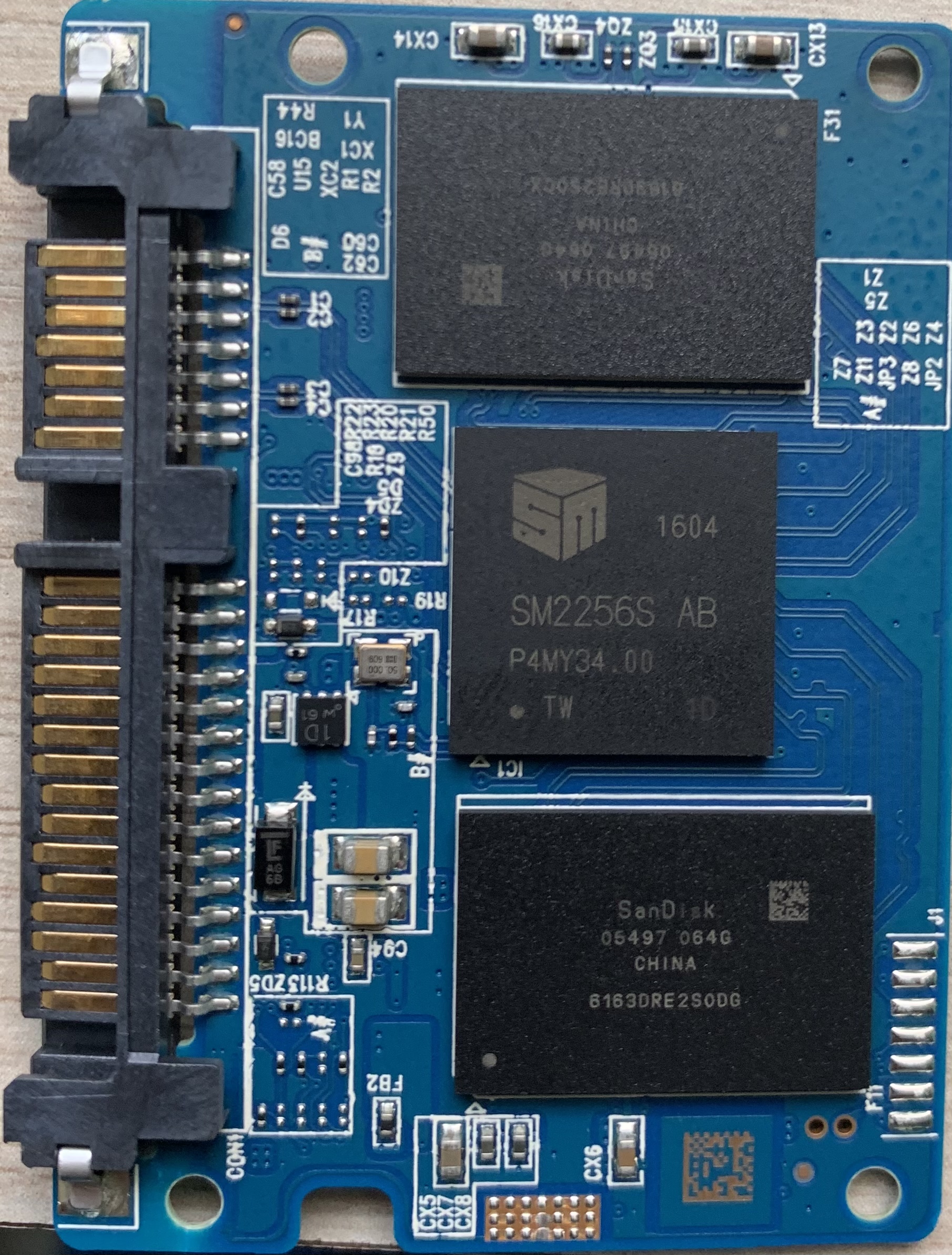

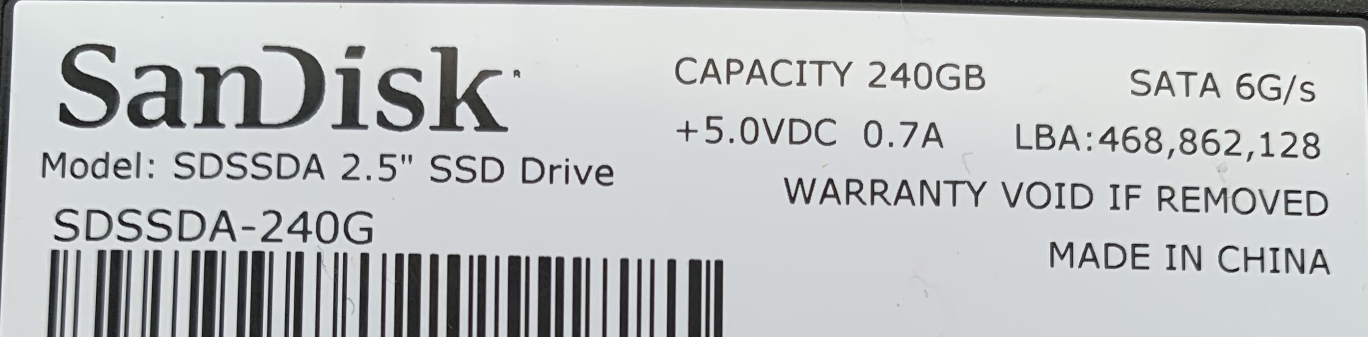

SSD SANDISK 240 gb is busy!
Is pc3k is ssd not suported?

Controller SM2256S AB
Нет ничего невозможного

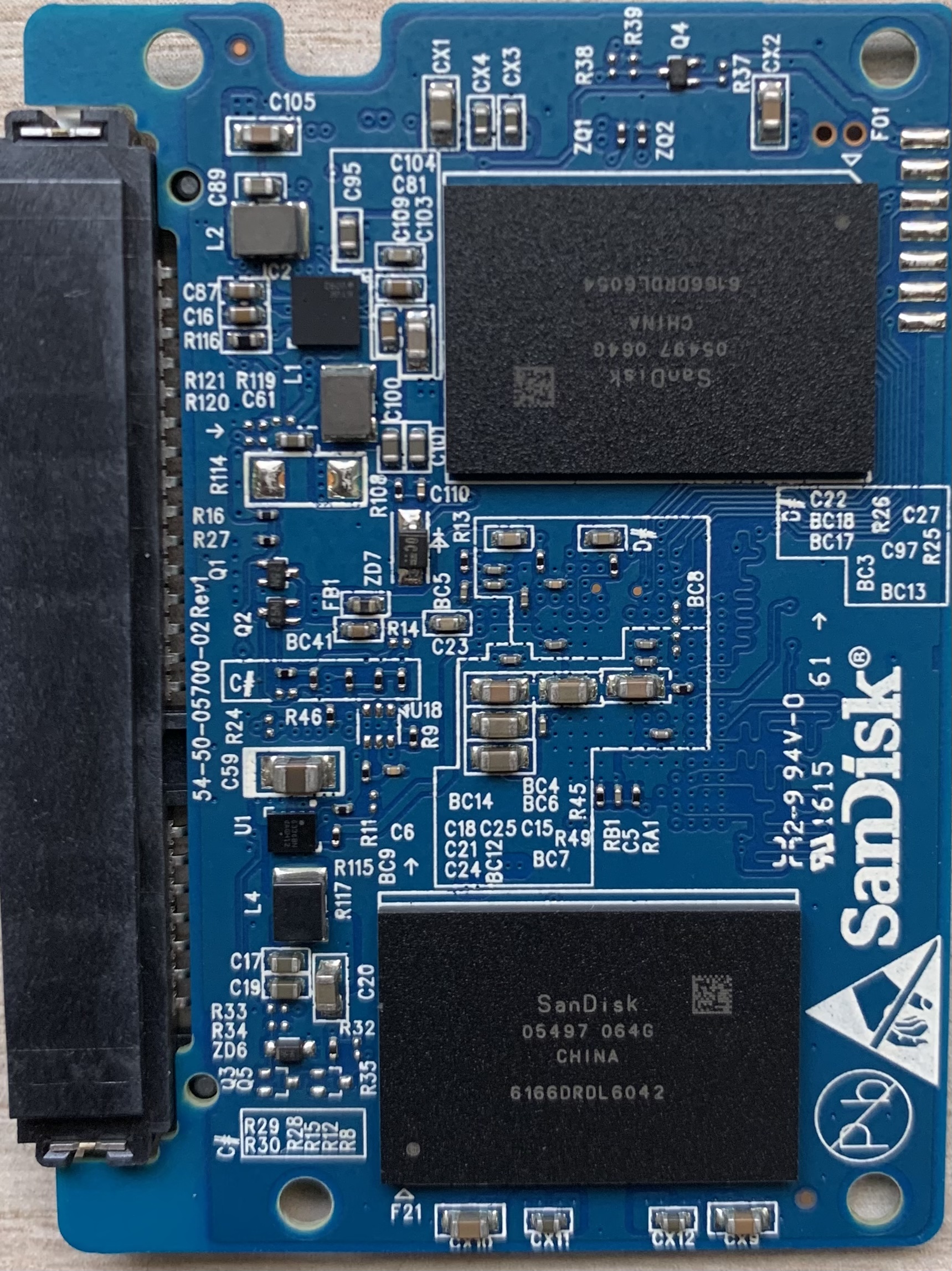

 Post subject: Re: SM2256S AB
PostPosted: December 16th, 2020, 7:58
Posts: 1060
pclab wrote:
Why don't you post more info about the SSD?
Controller, model, etc
Or better yet, a picture!
PostPosted: December 16th, 2020, 14:24
Posts: 1060
sempre wrote:
PostPosted: December 16th, 2020, 15:13
Posts: 17256
FWIW (maybe nothing), I have saved some photos of the same model from the year before yours. It uses an SM2246XT controller.
I suspect that the "ROM mode" shorting points are adjacent to "F01" near one corner of the PCB.

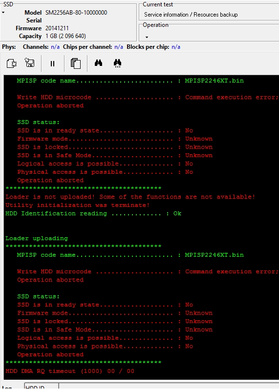

PostPosted: December 16th, 2020, 15:16
Posts: 922
Short the drive, when it goes ready, try LDR.
ok thanks!
PostPosted: December 16th, 2020, 15:57
Posts: 1060
"ROM mode" shorting points are adjacent to "F01" Yes correct!
PostPosted: December 16th, 2020, 16:07
Posts: 1060
Error!
PostPosted: December 17th, 2020, 4:25
Joined: July 12th, 2010, 4:38
Posts: 1455
I don't think it's possible without the proper loader.
You are trying with a loader not for that controller.
PostPosted: December 17th, 2020, 6:46
Posts: 1060
100% correct!
does anyone know where to find a tool that has this loader? PM
.cn .ru tool loader??
PostPosted: December 21st, 2020, 16:48
Posts: 1060
Currently unsolved! :shock:
