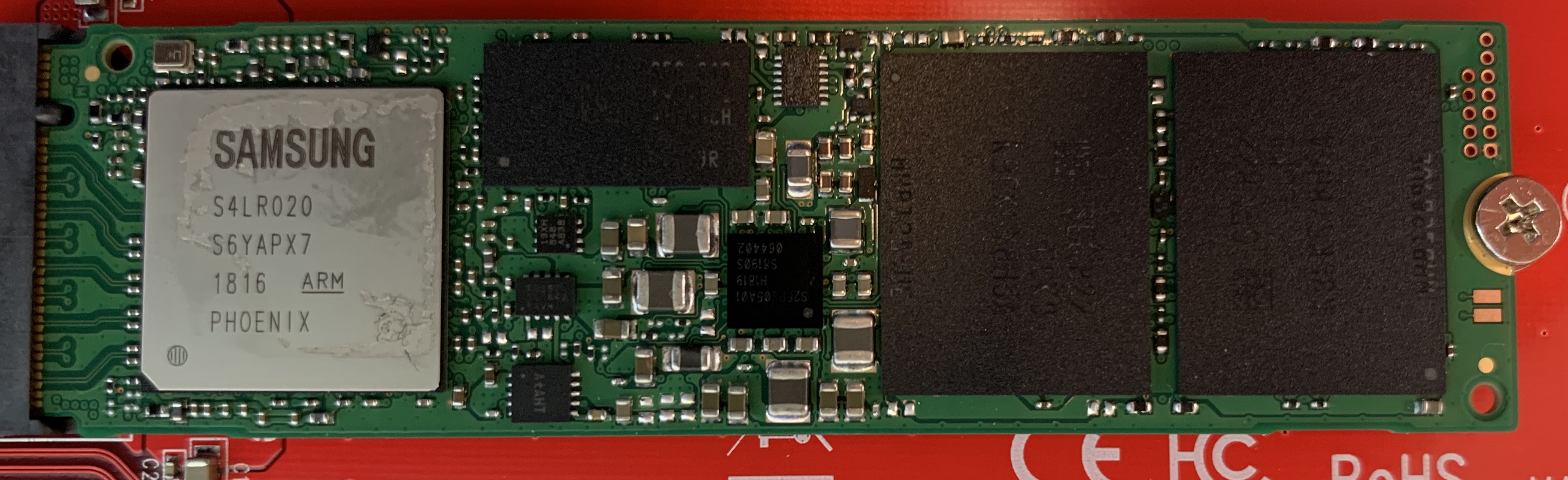

Hi
I have a dead Samsung MZ-VLB2560 , and are wondering if it possible to revive this nvme ssd. It died quite instantly I've been told, a warning from Windows( Dont know what), and then on reboot the controller didnt find the disk.
I have tried connecting the disk to a new nvme controller, but to no avail.
What do you think, it is possible to do some phyiscal debugging on this thing? Can it be a short or dead component?
I noticed that it gets really hot, but I have no benchmark on the temperature, so I really dont know what temperature it runs at while idle, but I doubt it should get _that_ hot while idling. It's the ARM MCU itself that gets really hot, but I'm guessing a physical fault, not a software fault causing overload and that heat.

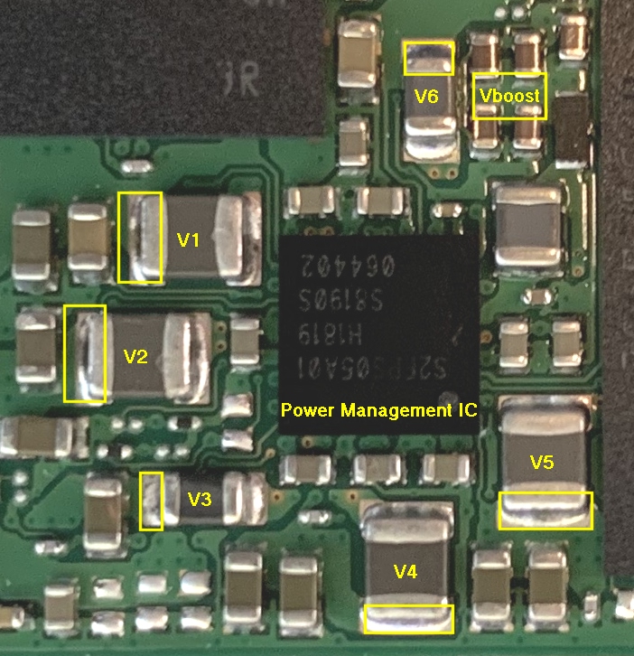

Measure the voltages at V1 - V6 and Vboost.

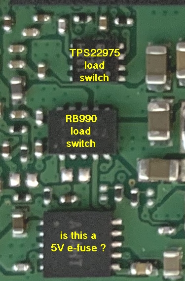

Measure the Vin and Vout pins of each load switch.
TPS22975DSGR, Texas Instruments, 0.6V - 5.7V, 6A, 16mOhm Load Switch, marking 13XH, WSON-8:
http://www.ti.com/lit/ds/symlink/tps22975.pdf
TPS22966, Texas Instruments, 5.5V, 6A, 16-mohm ON-Resistance Dual-Channel Load Switch, marking RB966:
http://www.ti.com/lit/ds/symlink/tps22966.pdf
TPS22990DMLR, Texas Instruments, 0.6V - 5.5V, 10A, 3.9mOhm Load Switch, marking [url]RB990, WSON-10: http://www.ti.com/lit/ds/symlink/tps22990.pdf[/url]

Thanks. What should I use as reference/ground when measuring V1-V6?
 Post subject: Re: Dead Samsung MZ-VLB2560
PostPosted: August 22nd, 2019, 2:40
Posts: 17230
Use the ground pins at the connector.

TechBBG wrote:
Hey-were you able to figure out this issue? I have some machines with the same HD showing the same issue. TechB
No unfortunately not. I sent thisunit to a professional reconstruction company, but they didn't succeed in reconstructing anything.
Was your ssd from a HP laptop as well?
PostPosted: August 31st, 2020, 13:34
Joined: February 18th, 2020, 9:35
Posts: 75
Location: Ukraina
k5k wrote:
Your SSD processor burned down, you can see it by the glue residue from the sticker.
PostPosted: September 1st, 2020, 14:28
Posts: 17230
Measure the resistance between ground and each of the voltage test points. That will tell you if any of the loads are shorted.
