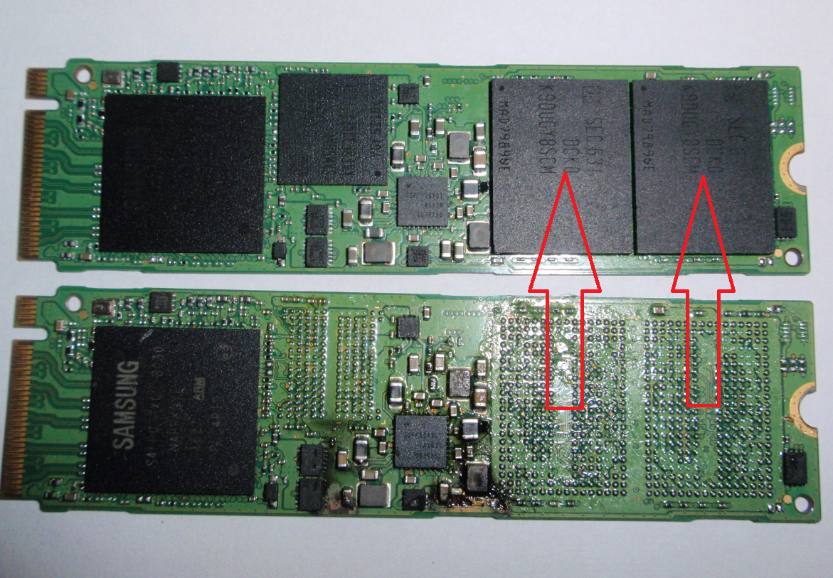

What controller? Due to encryption operation maybe not finish with success.

those controllers encrypt the data
ENCRYPTION SUPPORT
AES 256-bit Encryption (Class 0), TCG/Opal, IEEE1667 (Encrypted drive)

Better fix the drive, if controller is still alive.

frago wrote:
Controller
Samsung
S4LR020
S82BKS4
This controller does not store encryption keys, and it is better to transfer nands

while you have the NANDs off, prudent to dump each chip and store dumps somewhere. At least it may be a possible avenue to recovery after you kill the drive

frago wrote:
gold6565 wrote:
frago wrote:
Controller
Samsung
S4LR020
S82BKS4
So my friend i will order a new nvme ,the same model like this and i will move the nands from the patient nvme to the new one right???
Yes, if the nandas are not damaged by water. This one I made yesterday, the information is in place.

It was a good idea to check that first, glad it worked out too.
