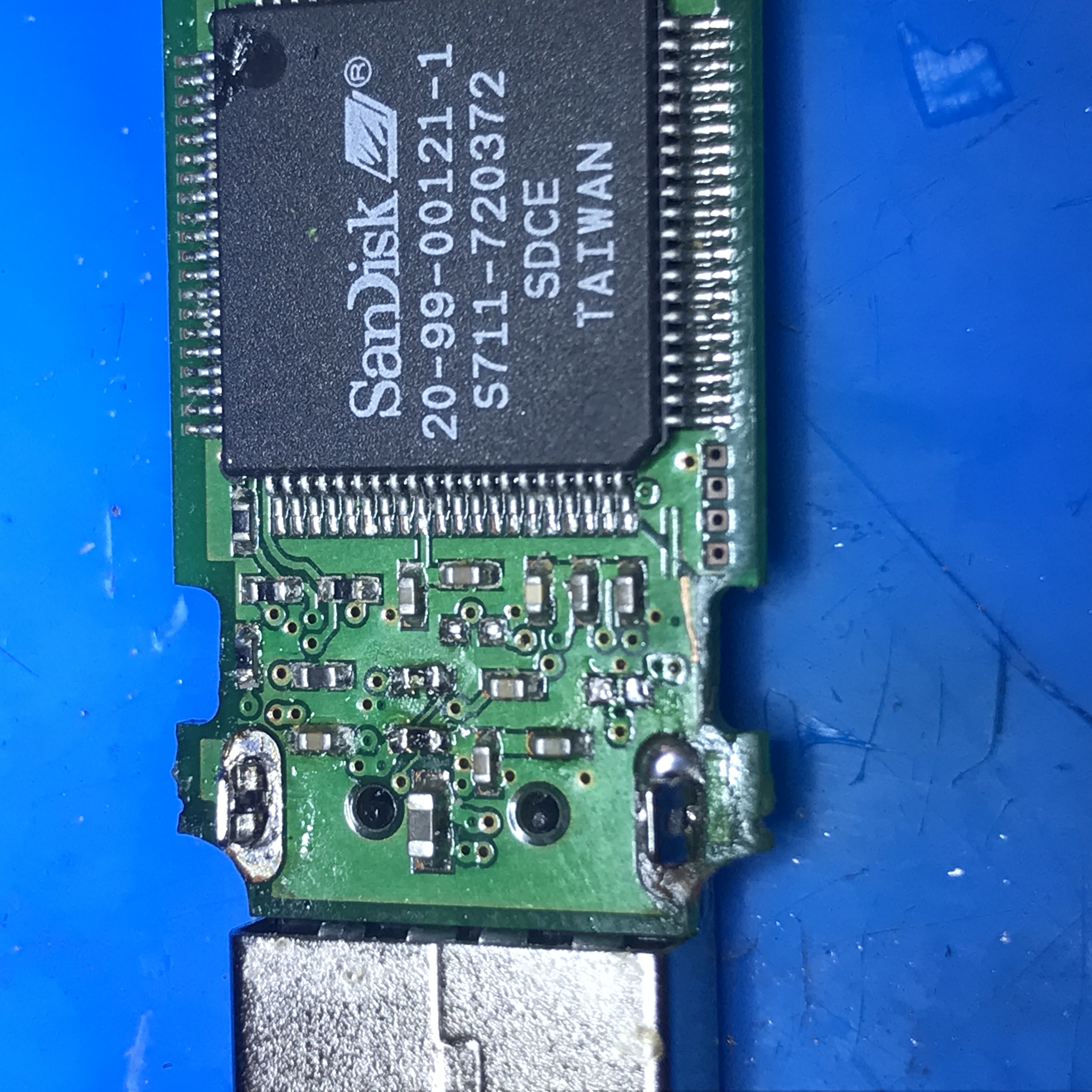

 Post subject: Sandisk 20-99-00121-1 Flash Drive missing component
PostPosted: September 30th, 2020, 14:04
Joined: September 30th, 2020, 13:56
Posts: 5
Location: Alexandria, VA

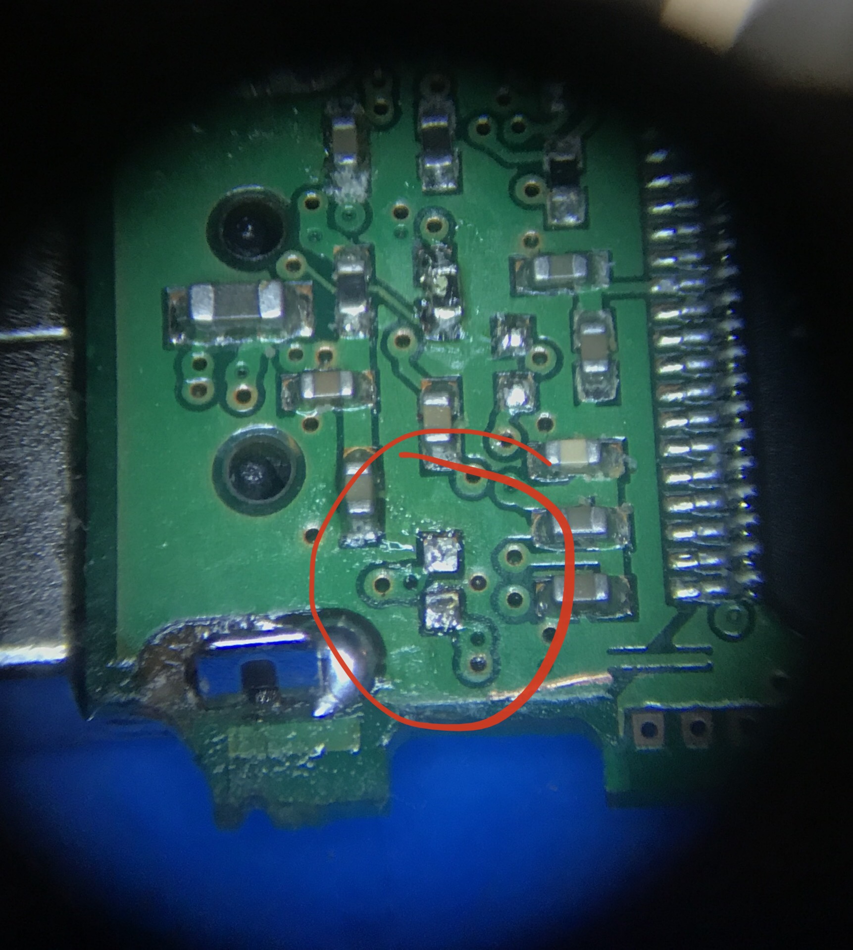

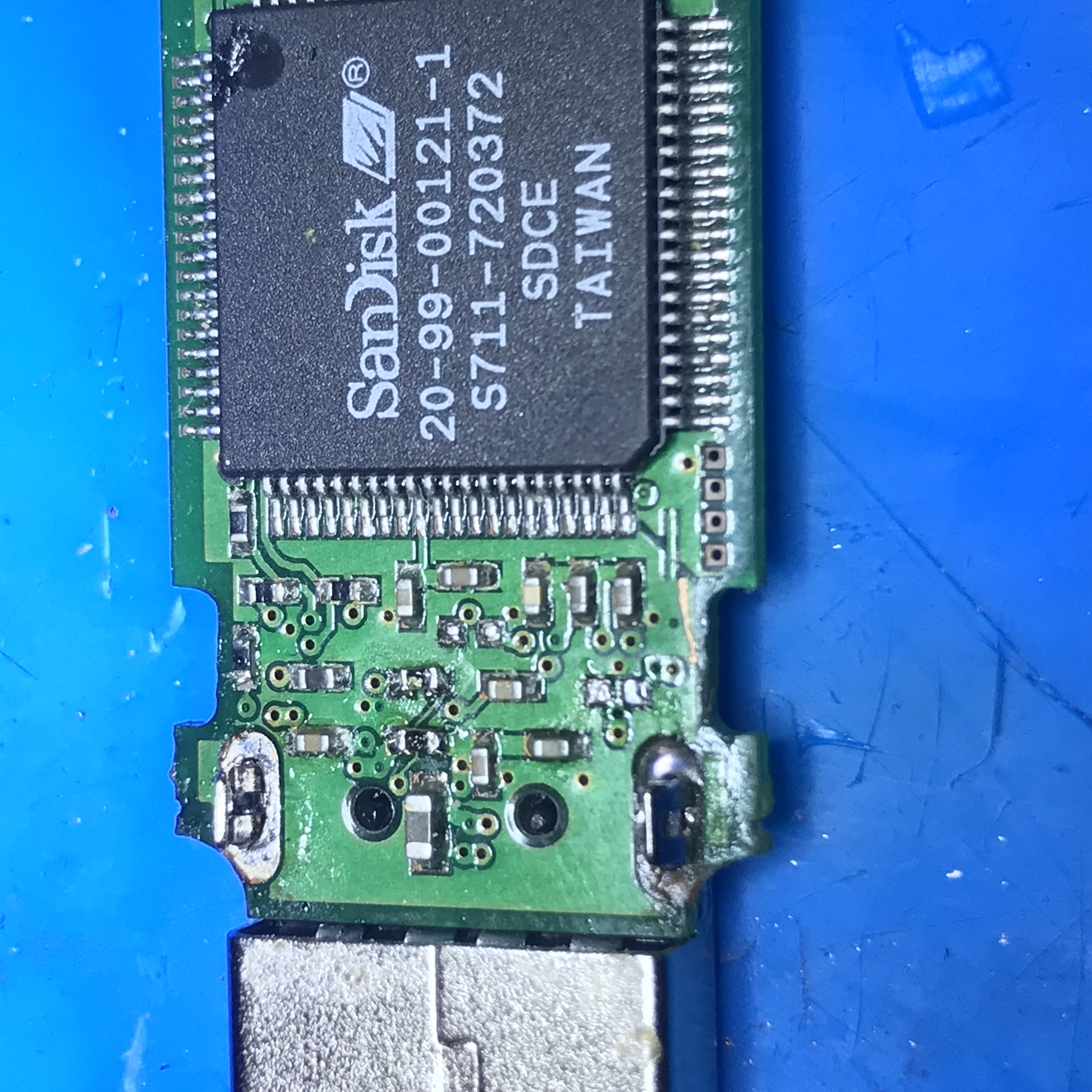

Hi, I'm missing a component on this flash drive, which is preventing the flash drive from working. Right now, the light just blinks once, then no more life from the flash drive. Computers aren't recognizing the drive at all. I suspect that this missing component is the cause. Any help in identifying this component would be much appreciated.
 Post subject: Re: Sandisk 20-99-00121-1 Flash Drive missing component
PostPosted: September 30th, 2020, 19:03
Posts: 1777
Location: Phoenix, AZ USA
Is one side ground and other not?
PostPosted: September 30th, 2020, 19:07
Posts: 5
No, one side is .4V in diode mode and the other is .53V. Looks like one side is connected to pin 1 on the controller chip.
PostPosted: October 1st, 2020, 10:22
Posts: 1777
Are you measuring voltage of diode mode readings?
PostPosted: October 1st, 2020, 10:50
Posts: 5
Diode mode, not voltage with it powered on

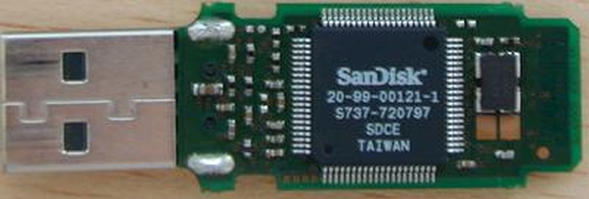

PostPosted: October 1st, 2020, 12:08
Posts: 922
I do not have better photo.
PostPosted: October 1st, 2020, 18:38
Posts: 5
Sorry, but I need the value of the component. Can you help with that?
PostPosted: October 2nd, 2020, 5:29
Posts: 922
I do not have phisically this device in my lab, sorry.
PostPosted: October 6th, 2020, 13:10
Joined: July 30th, 2012, 3:37
Posts: 314
Location: Fairfield, CT USA
I have a few donor boards of that model, its a fixed inductor. I have no idea what the value is though.
PostPosted: October 6th, 2020, 13:37
Posts: 5
Thank you Jeremy. Yeah, I thought that I had tested a filter, but I guess I must not have. Anyways, the inductor did indeed fix the drive. Appreciate your response.
PostPosted: October 6th, 2020, 14:29
Posts: 17256
Measure the voltage on each side of the component.
PostPosted: October 7th, 2020, 10:16
Posts: 314
3.2v on either side of the component
No problem, glad to of helped :-)
Recover My Flash Drive
PostPosted: October 7th, 2020, 15:07
Posts: 17256
It looks like the inductor may be filtering the Vcc supply for the NAND. Measuring the voltages with the inductor removed would tell you whether the voltage was being generated internally or externally.
