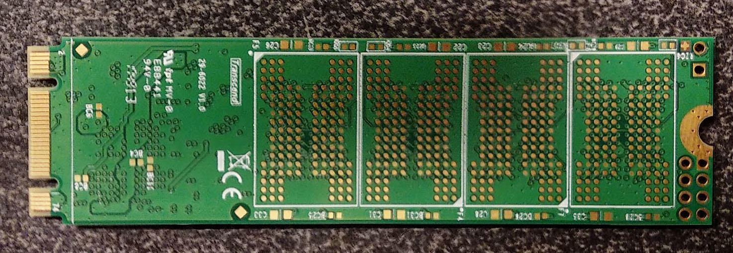

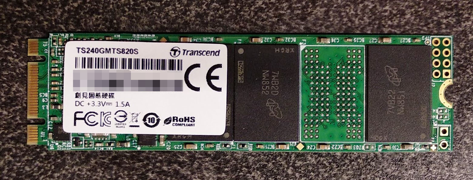

Hi guys!
I have a 240GB Transcend M.2 SSD (SATA interface), model TS240GMTS820S ( https://www.transcend-info.com/Products/No-749 ) mounted in M.2_2 slot (the one designed for SATA 3 M.2's) in an Asrock AB350m Pro4 motherboard (updated to most recent bios).

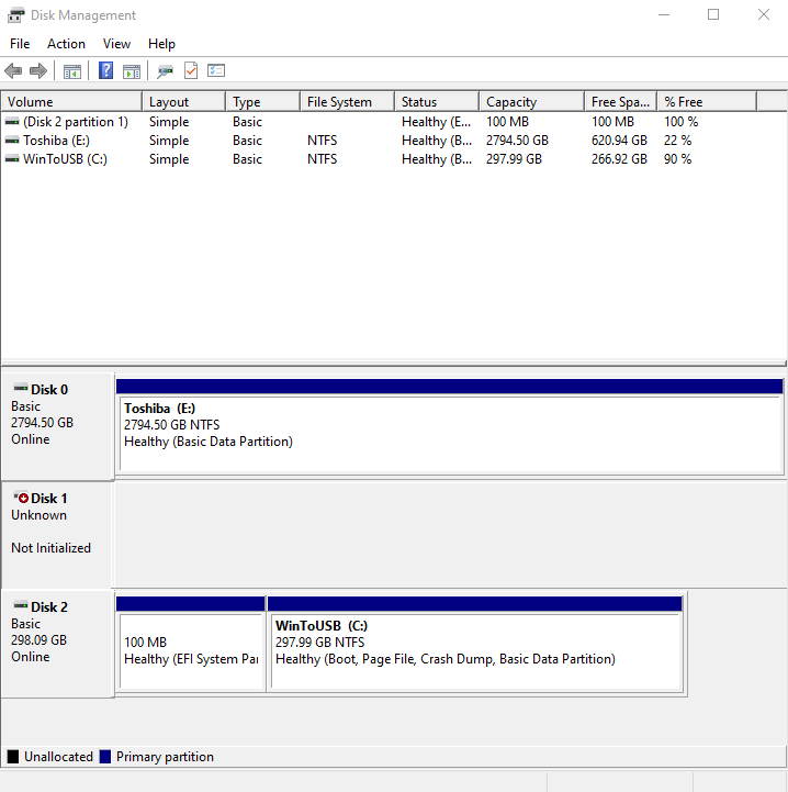

After I managed to put in another drive with a boot partition and boot from it, it seems that Windows still does detect a drive (kind of). In "Disk Management" it shows Disk 1, Unknown, Not initialized, but can't initialize it (it shows "A device which does not exist was specified")
In "Device manager" it shows as an "Unknown device" drive.

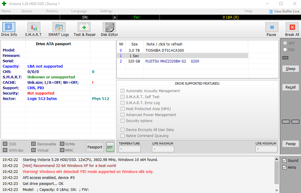

The only tools I tried that can see a drive there are Victoria and HDDScan, but as size 0. Transcend's own recovery app "RecoveRx" doesn't see it.

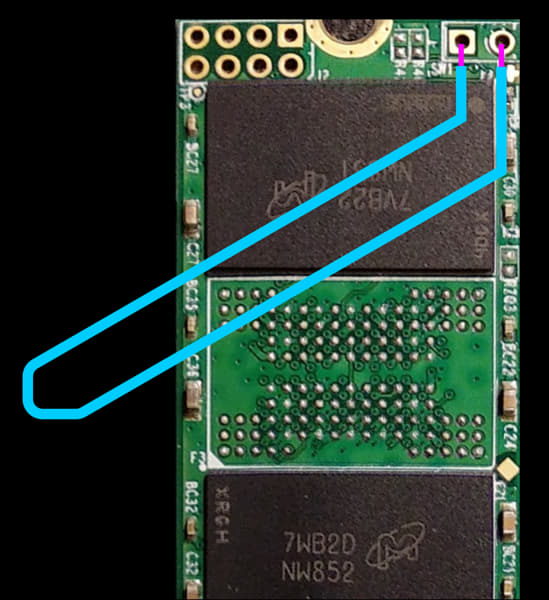

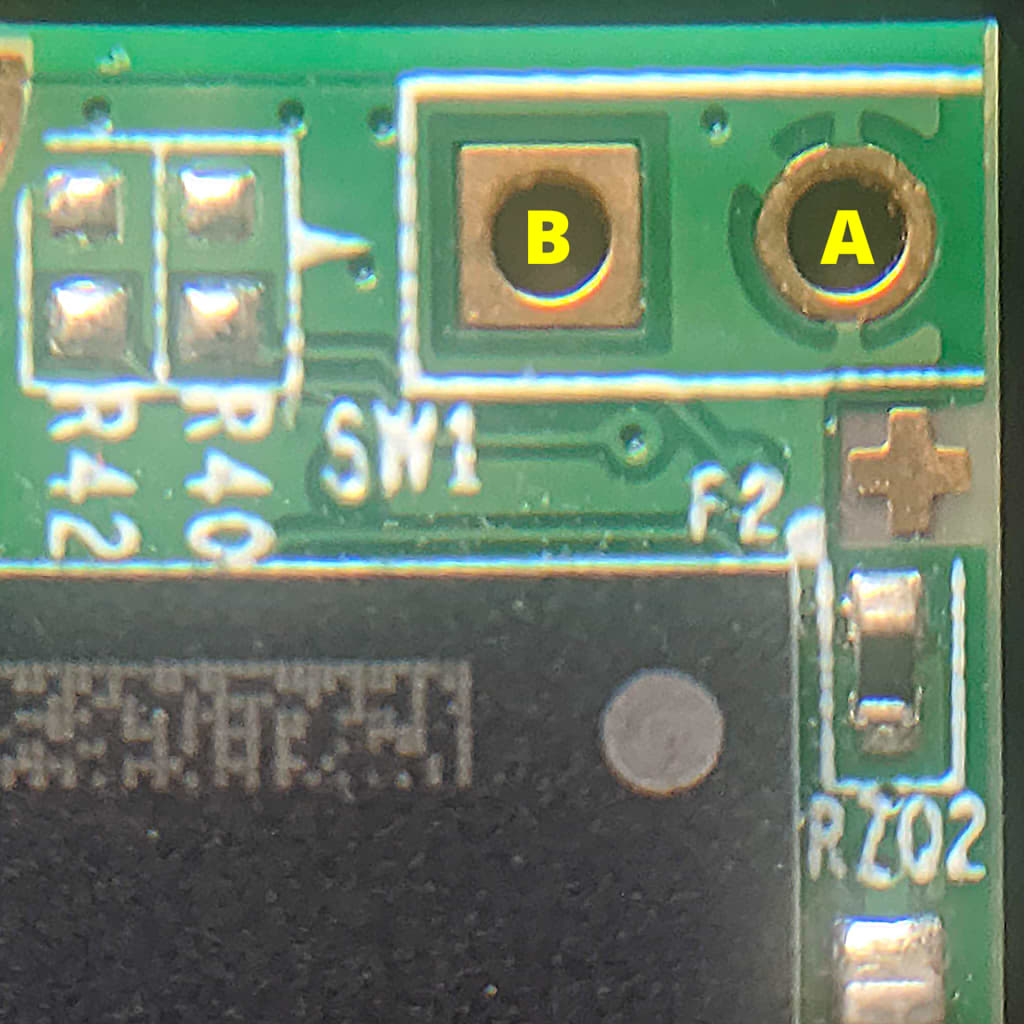

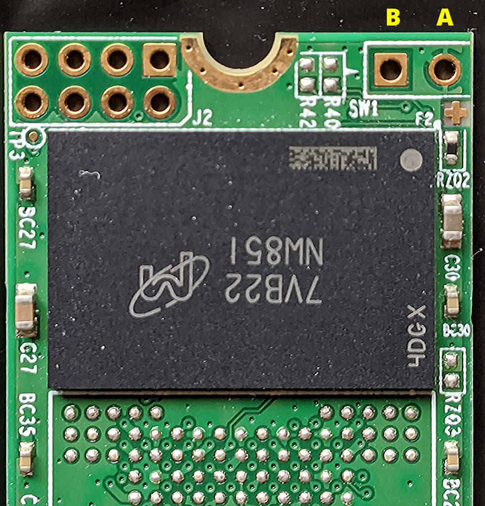

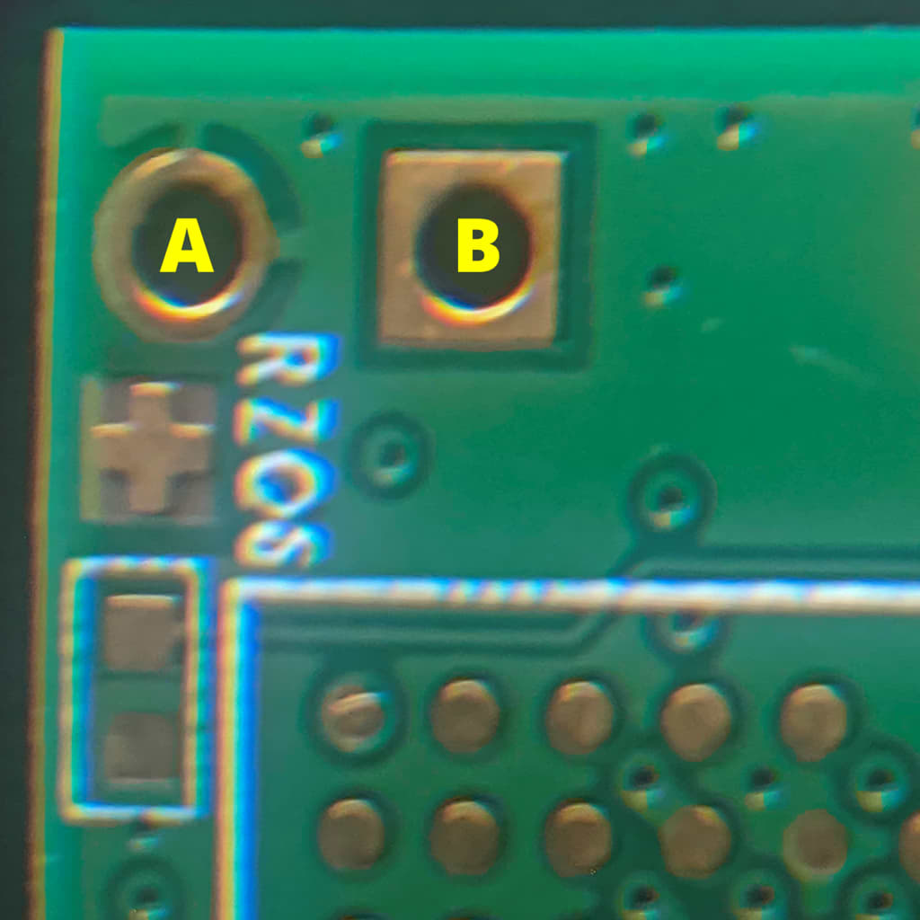

If you short the two locations marked "SW1" at power-on, I expect that the SSD will enter safe mode or "ROM mode".
https://www.wootware.co.za/media/catalog/product/cache/1/image/9df78eab33525d08d6e5fb8d27136e95/1/2/120.jpg
https://www.wootware.co.za/media/catalog/product/cache/1/image/9df78eab33525d08d6e5fb8d27136e95/2/4/240.jpg
https://www.wootware.co.za/media/catalog/product/cache/1/image/9df78eab33525d08d6e5fb8d27136e95/4/8/480.jpg
I can't tell you whether this is OK to try. The SSDs in the photos are not the same model, so it is unclear as to whether this area (bottom right corner) has the same function in all examples.
This location, a short between A and B? Shorting at power-on means I have to release the short after is done powering on or I can leave there whatever I put to make a short?
If this works for my drive what would it mean to be in "ROM mode"? What would I achieve with that? (Probably a stupid question but my knowledge is limited.)
And what is the risk, if it goes wrong?
From what I can see looking at the photos taken with my phone A is ground but B seems not connected to anything?
 Post subject: Re: Dead Transcend 240GB M.2 SATA SSD
PostPosted: October 13th, 2020, 18:02
Posts: 17373
I suspect that the PCB is multilayer. "SW1" suggests "switch" or maybe "software" (?). Shorting this "switch" at power-on (with tweezers?) and then releasing it after power-up would normally enter "ROM mode" on other SSDs. That's the mode in which the SSD is prepared to accept factory firmware.
See http://vlo.name:3000/hw/ssd/rommode/

Shorting the contacts worked! I'm making progress thanks to you. :D
The M.2 slot is right under the video card, I have no access with tweezers. I improvised with an insulated wire, something like this:
I left the short in place for the duration of investigations bellow because is dificult to put it back, requires complete unmounting the drive from the slot and mounting it back. As far as I understand it needs to be removed only when I'm ready to write a firmware to the device, am I right? I plan to pull out the shorting wire when I'm ready to actually flash something.
Starting the computer and entering in UEFI/Bios - the device is detected. (As something else, not original Transcend name)
I booted from the firmware updating stick - the Transcend flashing program doesn't detect it.
Booting in Windows - the disk is detected by the OS as SM2258AB-80-10000000, 1 GB capacity.

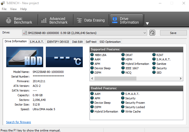

I searched for the program in the screenshots from your link, TxBench, and this is what it shows
Model name: SM2258AB-80-10000000
Firmware: 20141211
Now I don't know how to proceed further, Transcend's tool doesn't detect it. Searching the internet I figured out that I need to use a tool named MPTool but are many versions and I don't know which and how they work.

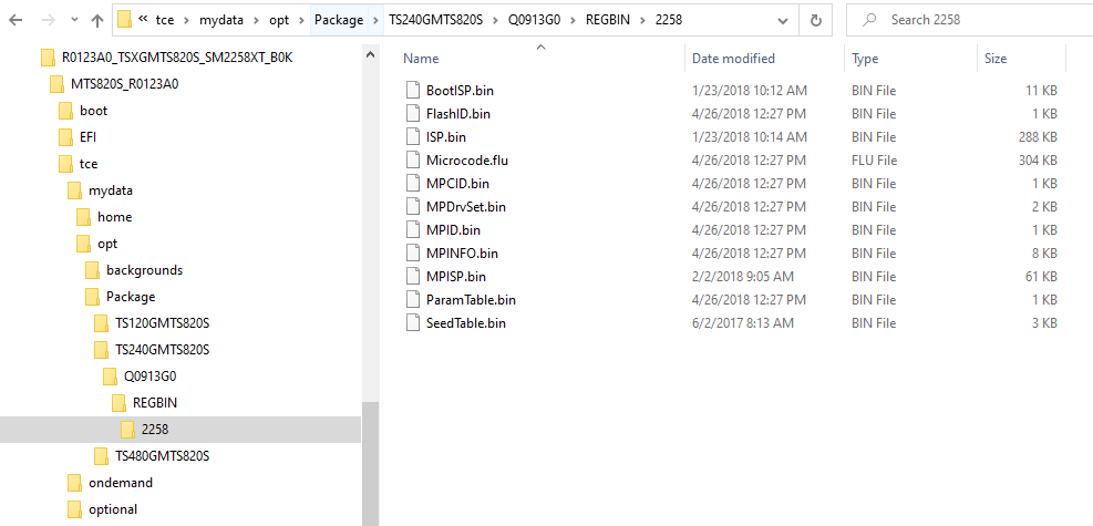

I looked at the firmware package that was downloaded by Transcend's app "SSD Scope" when it offered to update my drive and it looks like this:
Archive name is "R0123A0_TSXGMTS820S_SM2258XT_B0K.zip". Inside is "MTS820S_R0123A0.iso". Unpacking de .iso, inside there is a file named "mydata.tgz" which have, inside a folder named like my drive (TS240GMTS820S), these files:
What I figured out is that I need something in relation to SM2258AB or SM2258XT. Searching for SM2258XT took me to this site: https://flashboot.ru/files/ which has several tools related to SM2258XT but I'm not sure which is the right one (if any), how those tools work and what files should be flashed on the device.

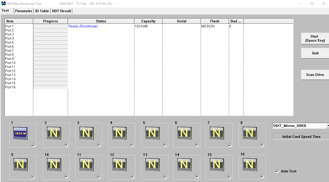

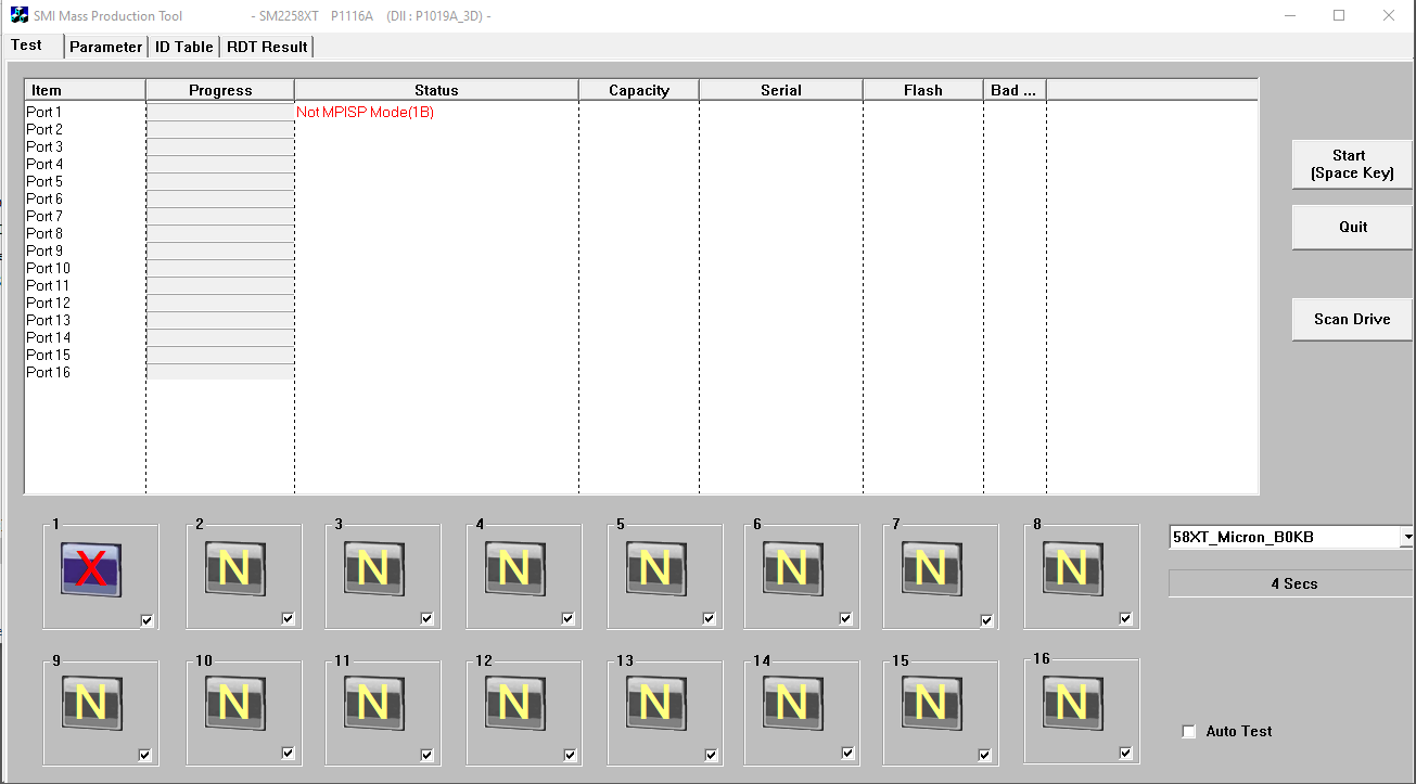

I made some more progress but I got stuck. My drive enters ROM mode but doesn't become writable by SMI MPTool when I remove the short.

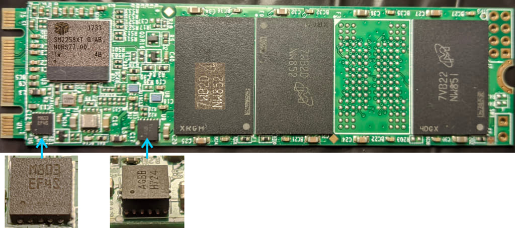

I removed the label in order to better identify controller and memory modules.
Controller: SM2258XT-G-AB
Memory: Micron 7WB2D NW852 (2 modules), 7VB22 NW851 (1 module)
Checking for human readable strings in binary files that came in Trascend's firmware .iso i got this string in file "MPINFO.bin": Micron,384Gbit,MT29F384G08EBCBB(B0KB)(78)(SM2258XT)
Based on all those informations I chose from this page https://www.usbdev.ru/files/smi/sm2258xtmptool/ the file "SMI MPTool SM2258XT Micron_B0KB P1116A". It recognizes my drive as "Ready(ROMmode)"
AfterI edit the configuration in Parameter tab to match my memory, when I try to write to SSD, I get this error: "Not MPISP mode". Although I removed the short from contacts.
I tried some other versions of SMI MPTool SM2258XT but with the same result.
I don't know what to do to get rid of this error. Searching google for this error I found that some people resolved it by connecting the drive to a SATA->USB adapter. I wonder why would that be the case, what difference does it make connecting the drive internally vs. to an USB adapter? Would make sense to buy a M.2->SATA adapter? (I already have a SATA->USB 2.0, I'm thinking to connect M.2->SATA->USB->PC)

NW851 = MT29F384G08EBHBBJ4-3R:B = 46GiB
https://www.micron.com/support/tools-and-utilities/fbga?fbga=nw851#pnlFBGA
NW852 = MT29F768G08EEHBBJ4-3R:B = 96GiB
https://www.micron.com/support/tools-and-utilities/fbga?fbga=nw852#pnlFBGA
"EF4S" = STEF4S = 3.3V/5V electronic fuse
PostPosted: October 17th, 2020, 0:08
Posts: 17373
EP53A7HQI, Altera/Enpirion, 1A PowerSoC DC-DC Step-Down Converter with integrated inductor & MOSFET, 2.4V - 5.5Vin, 3-pin VID, marking AGxx, QFN16:
https://www.altera.com/content/dam/altera-www/global/en_US/pdfs/literature/ds/ep53a7xqi_015432.pdf
STEF4S, STMicroelectronics, Electronic fuse for 3.3 V and 5 V lines, Output clamp voltage 5.7V in 5V mode, Protection trip current 5A, marking EF4S, DFN 3x3 - 10L:
http://www.st.com/web/en/resource/technical/document/datasheet/DM00095426.pdf
http://www.users.on.net/~fzabkar/Datasheets/DATAURLS.HTM

did you select AHCI mode in BIOS? M.2->SATA likely the best bet. I am going by translation from here: https://www.usbdev.ru/files/smi/sm2258xtmptool/
