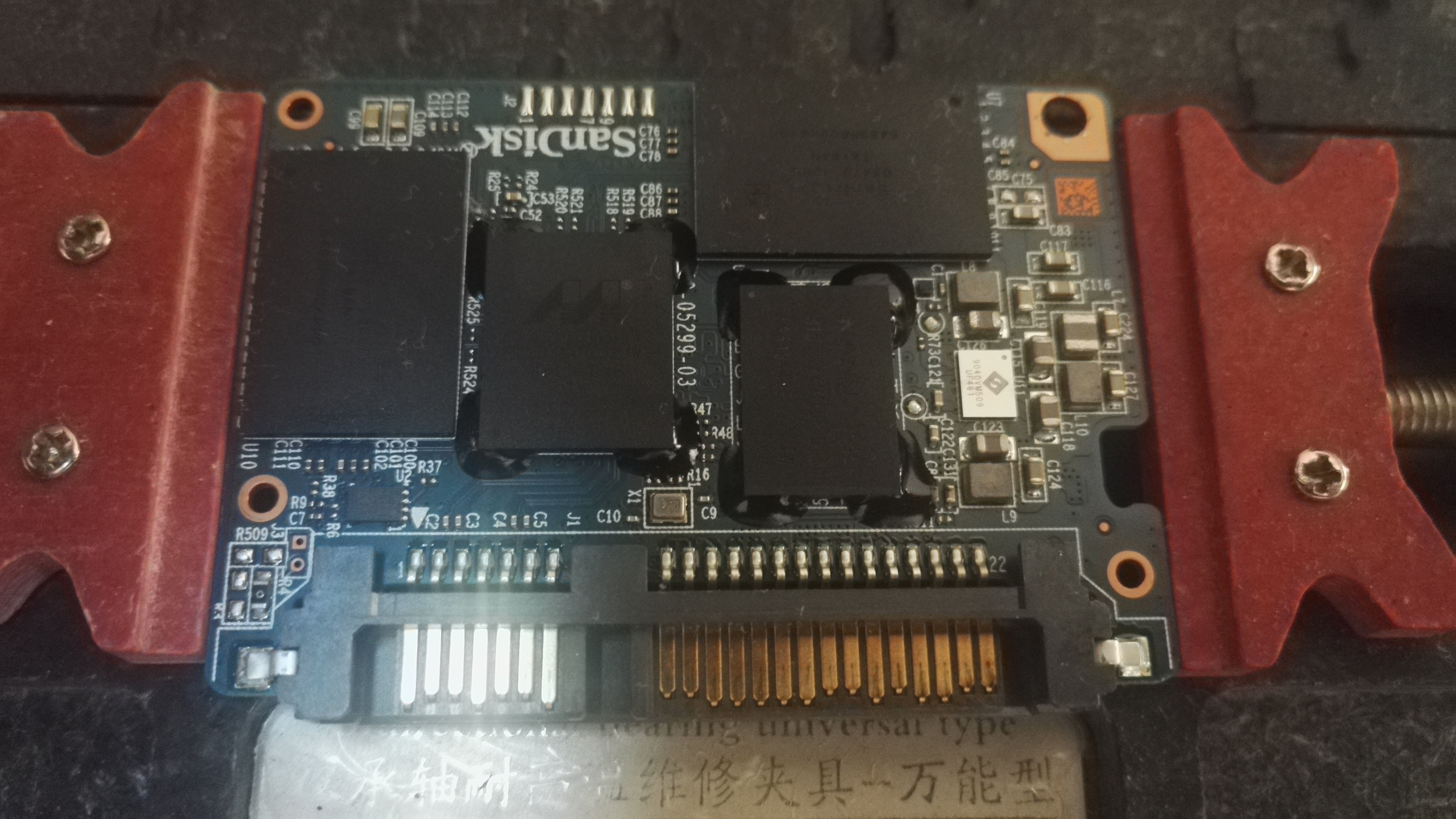

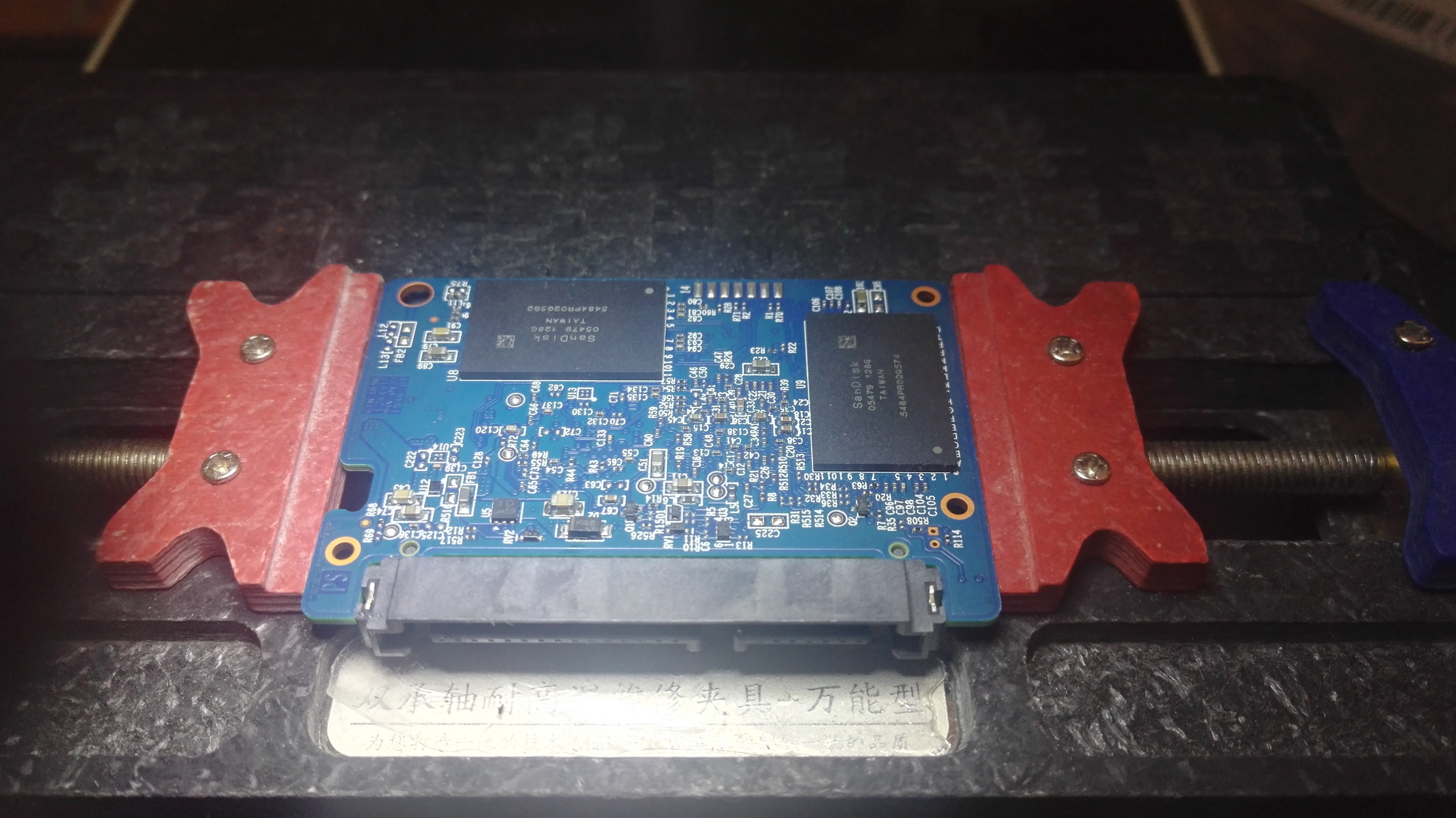

Hello everyone,
i've this 480GB Sandisk Ultra II SSD which doesn't power on.

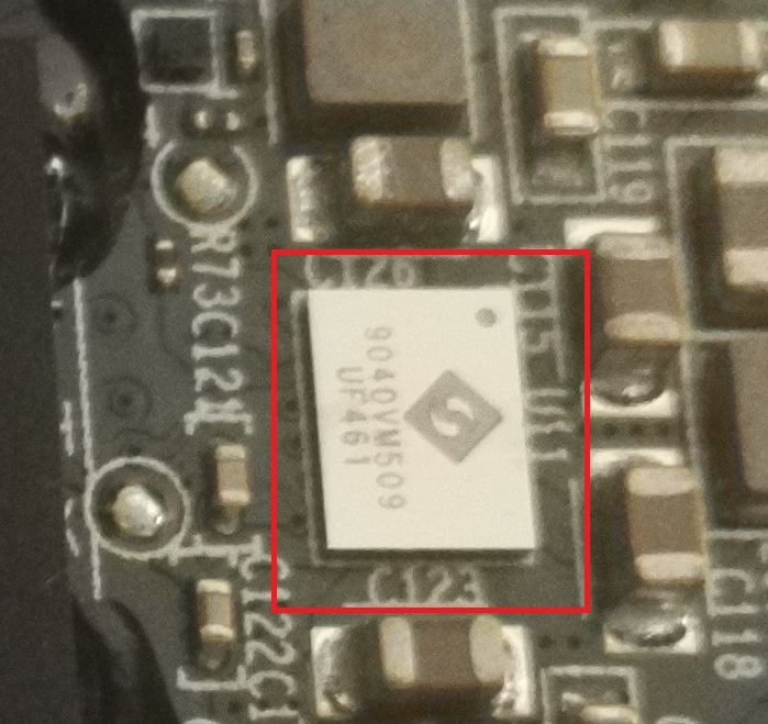

I've found a lot of shorts on caps around 9040VM509 chip (glass package), or with very low resistance (as 4 or 10 ohms).
This chip (located on U11 position) gets pretty hot, i also did the isopropyl alcohol test which evaporates faster on that chip, this means that most likely 9040VM509 chip is shorted.
Problem is that i can't find this chip anywhere, even if i search ACT9040VM509-T as product number. :(
Do you know where can i find it?
Maybe the only way how to get it is buying donor ssd, but if i do so i will need to reball all those very tiny bga pads :?
P.S.
I've also found cracked KG8 diode located on D2!

KG8 looks like a 5V TVS diode, so it appears that the SSD was clobbered by an overvoltage. Since you have voltage at the PMIC, then the diode must have been blown open circuit. The overvoltage would then have hit the PMIC.
If the shorts at the PMIC are on the output side (ie between inductors and ground), then one would have to be concerned about the main ICs (controller and NAND). Be aware that the Vcore supply normally measures in the low ohms range.

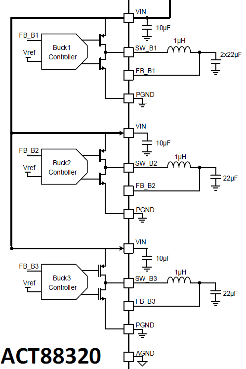

Your measurements indicate that the outputs of each of the buck converters is shorted to ground inside the IC. The loads are probably also shorted, although it is not clear if this could be due to an internal short to ground via the FB (feedback) pin.
Since the PMIC is bad, you have nothing to lose by removing it. I would then retest the capacitors. If the shorts remain, then I would put my bets on the other ICs being bad rather than the capacitors.

I thought since when i started the diagnostic the PMIC was faulty.
PMIC is a wafer-scale ic, they're very sensitive. The alcohol drying test near to never fails indicating where is the short (it is a simple and inexpensive test in the absence of a thermal cam).
