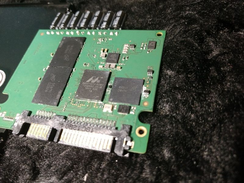

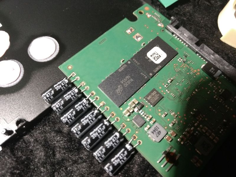

I would like to know how much cache-RAM this drive have. Micron support will not tell me.
These are the chips which I tried to lookup on Google without any hits :-(
BACK:
2 x 9XB2D / NW955
1 x 88SS1074-BSW2 / TX3B980.05JW / 1944 B3E / TW (Marvell controller)
1 x 9XB47 / D9XFR
FRONT:
2 X Micron 9UB2D / NW956
Capacitors:
8 X 35V 47nF
File comment: back
File comment: Front

 Post subject: Re: Micron 5300 Pro SSD SDRAM??
PostPosted: October 26th, 2020, 11:34
Posts: 17373
NW955 = MT29F1T08EEHBFJ4-T:B = 1Tbit 3D NAND flash
https://www.micron.com/products/nand-flash/3d-nand/part-catalog/mt29f1t08eehbfj4-t
https://www.micron.com/support/tools-and-utilities/fbga?fbga=NW955#pnlFBGA
NW956 = MT29F2T08EMHBFJ4-T:B = 2Tbit 3D NAND flash
https://www.micron.com/products/nand-flash/3d-nand/part-catalog/mt29f2t08emhbfj4-t
https://www.micron.com/support/tools-and-utilities/fbga?fbga=NW956#pnlFBGA
D9XFR = MT52L512M16D1PF-093 WT:B = SDRAM - Mobile LPDDR3 Memory IC 16Gb (512M x 32) 1067MHz 178-FBGA
https://www.micron.com/support/tools-and-utilities/fbga?fbga=D9XFR
