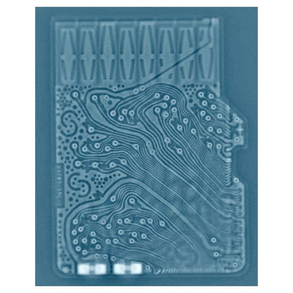

We can offer you much much lower price for such photos as below (sample on 3x7 SanDisk) but need to be send to us ;(
Animated GIf - http://mc1234.webd.pl/recovery/Multi-COM%203D%20Xray.gif
Conact me priv for more details
P.S
Shiping via DHL Express from US takes 24 hours ;)

You need someone with a microfocus x-ray source to do this -- regular dental/medical x-ray tubes won't show you much of anything useful.
Also, I wouldn't be too worried about these x-ray sources causing any data problems with the flash. You typically need higher than 150-175KV x-rays before you'd start getting up into the range where it's likely to cause issues. Most microfocus tubes don't run that high, nor would you need to.
In terms of getting 3D, do you need actual 3D reconstructed views, or do you just need a handful of views from different angles (or parallax)? There are machines from Agilent and Nordson DAGE that can do real 3D reconstructed X-ray images, but you may get charged a bit for time on those.
