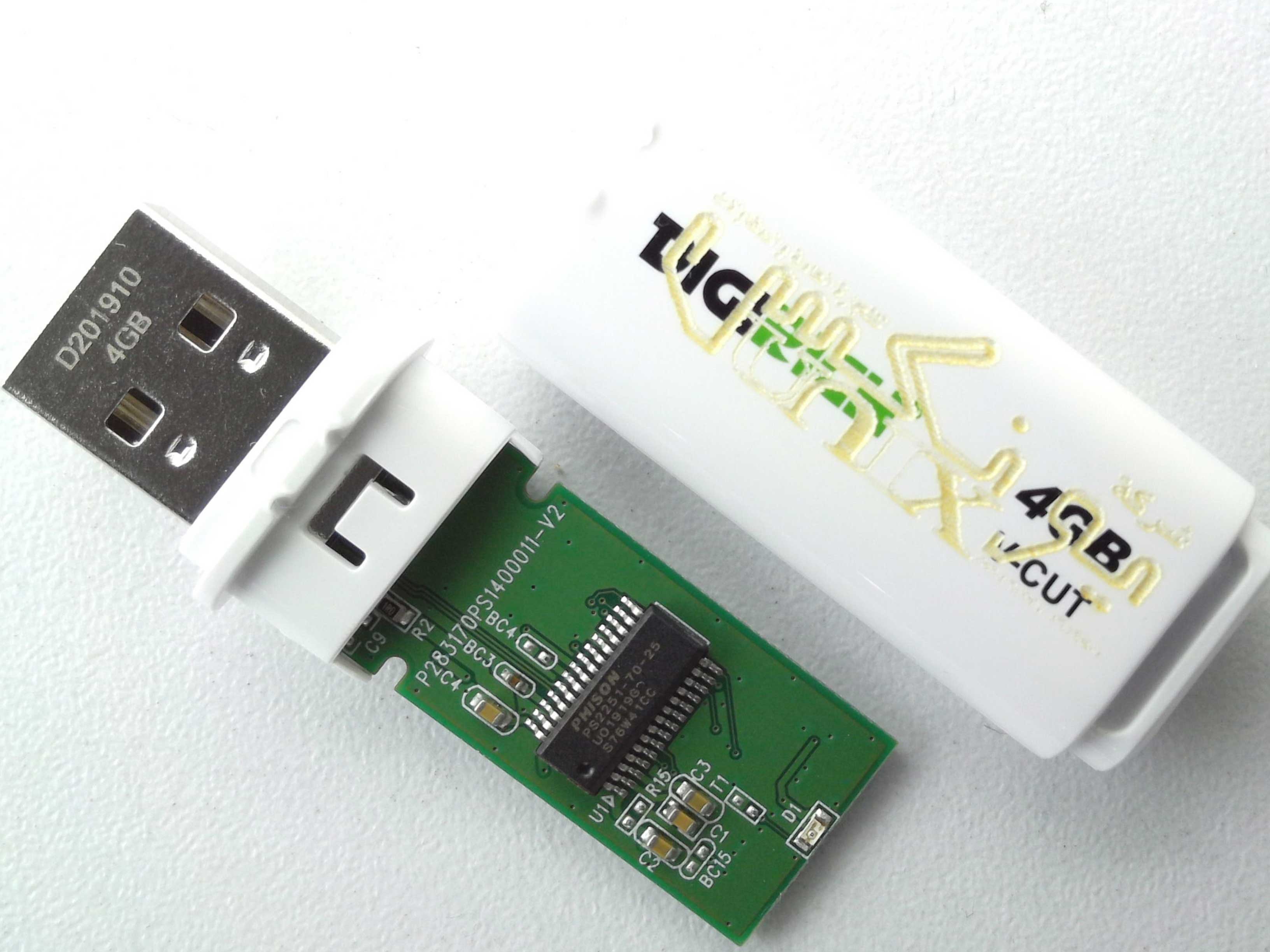

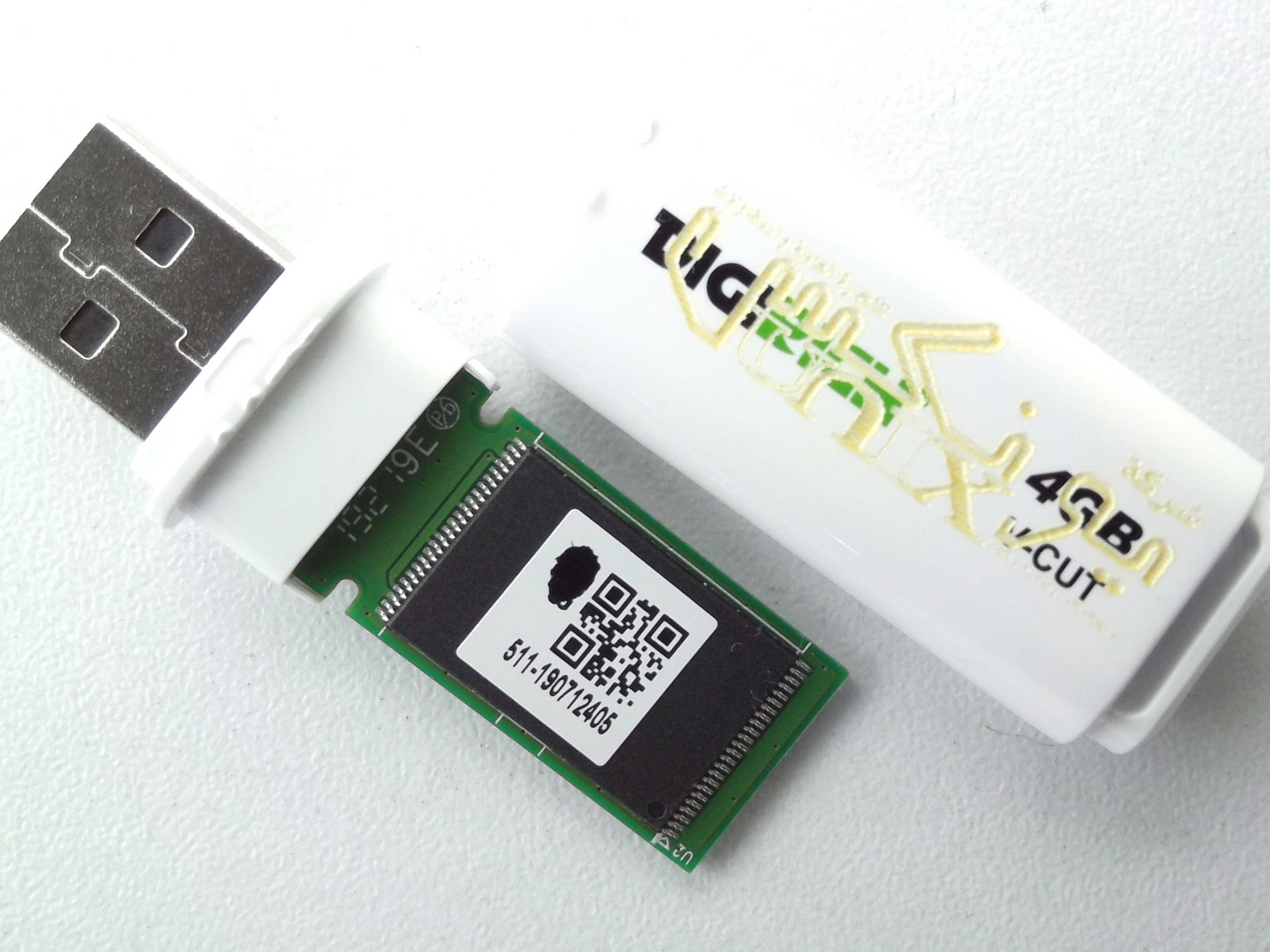

Some time ago i bought Qty of those cheap flashes for Ads campaigns i never opened one of those till today
when one of them came to us for DR :lol: :lol: :lol:
When i opened it i saw this controller as in attached images below :shock:
Conclusion: You throw the bait and WAIT :buhaha: :buhaha:

I have seen these controllers on legit drives. I think they are real Phison.

NAND flash is a funny industry. It can be the really cheap NAND chips that make these drives cheap, or some strange business thing.. possibly fake controllers or just a company that is making 0.1% profit margin.

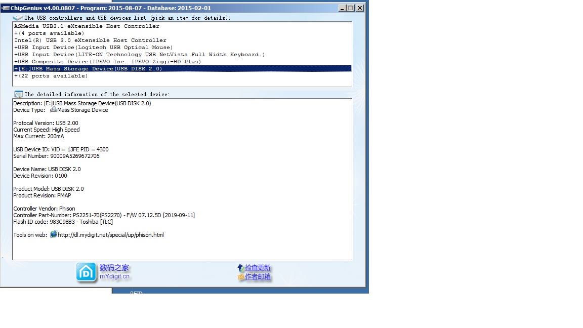

@einstein9 Have you run any tools against the drive to see what it reports? such as Chip Genius, GetFlashInfo.exe, Phison GetInfo (https://www.usbdev.ru/files/phison/getinfo/) or H2Testw for checking integrity?

Flash now is detected but asking to format (partition gone by itself :shock: ) trying to access data not possible
chipG_info.txt [549 Bytes]
