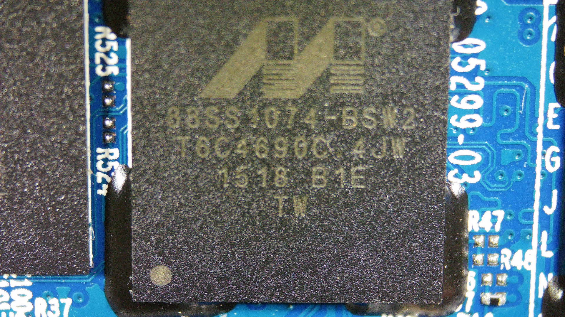

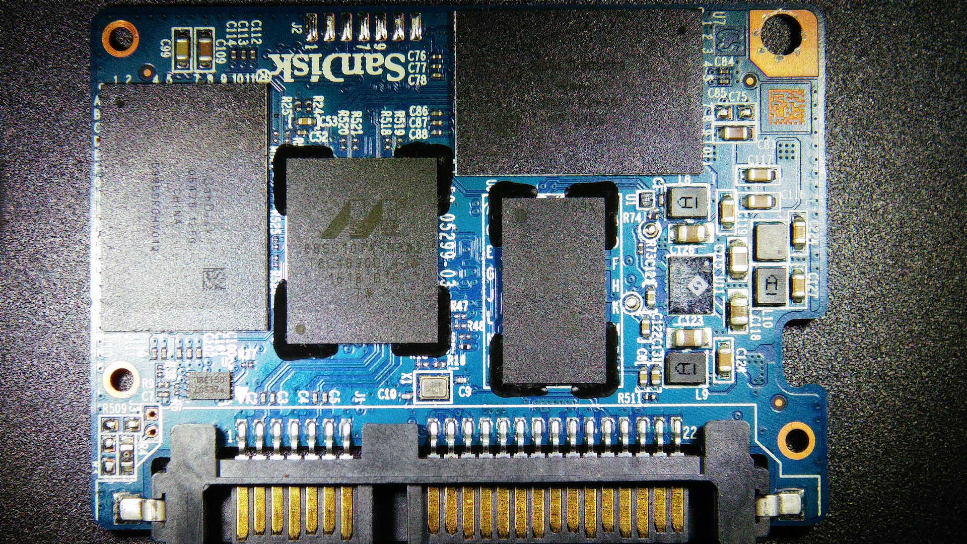

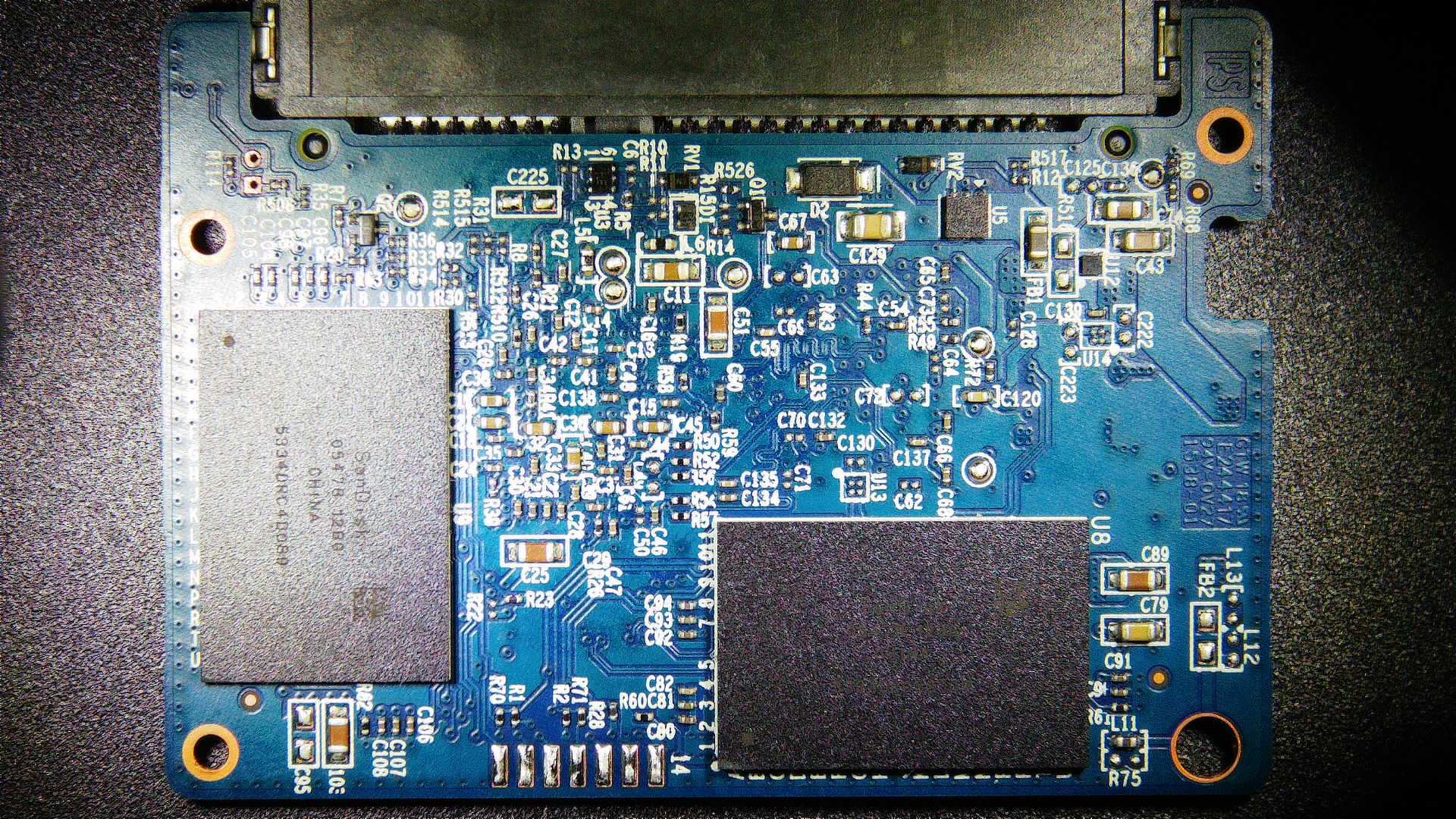

Hi, I need to recover data from a SanDisk Ultra II with a Marvell 88SS1074-BSW2 controller.
Unfortunately, the drive shows no signs of life. I've tested all the capacitors and they seem fine.

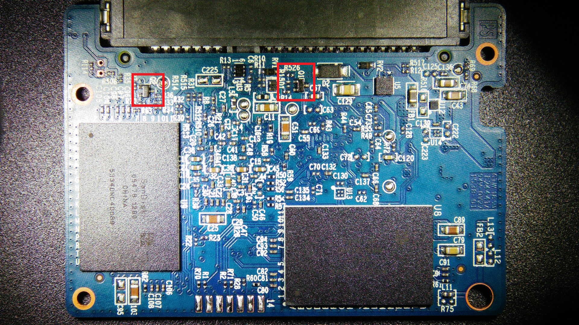

I think the next step should be measuring the MOSFET.
I found two components in a SOT23 package (marked in red).
My question is: is this a good approach, or should I try something else?

 Post subject: Re: SanDisk Ultra II - 480 GB - 88SS1074-BSW2 - No Life Sing
PostPosted: September 28th, 2025, 14:31
Joined: September 13th, 2023, 5:53
Posts: 90
Yes, I tried, but the disk is not detected by the BIOS or any software.
PostPosted: September 28th, 2025, 14:55
Posts: 17323

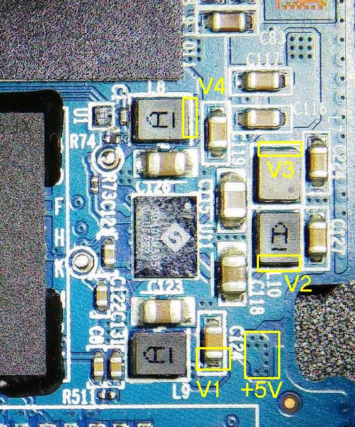

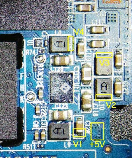

Start by measuring the voltages at each of the 4 inductors surrounding the Active Semi PMIC.
PostPosted: September 28th, 2025, 15:17
Posts: 17323

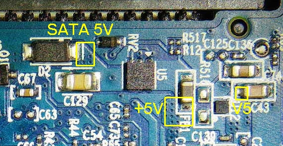

Measure these test points.
PostPosted: September 30th, 2025, 10:44
Posts: 90
ok
D2 5.1v
FB1 5.1v
C43 1.0v but on the right side of cap.
v1 1.3v
V2 1.0v
v3 2.7v
V4 1.8v
PostPosted: September 30th, 2025, 14:55
Posts: 17323
Those voltages are probably OK, in which case you may have a firmware problem.
PostPosted: September 30th, 2025, 15:06
Posts: 165
I didn't ask if the drive was detected, just about the status of the work log. I agree with the opinion about corrupted firmware.
PostPosted: October 1st, 2025, 8:36
Posts: 90
Okay, so gentlemen, what are the chances of fixing this without a PC3K? Unfortunately, MRT didn't reveal the carrier. The pins at the bottom of the carrier look like JTAG. The question is, can I achieve anything with them? Or is there another method?
PostPosted: October 1st, 2025, 8:42
Posts: 165
The pins are for connecting the terminal:
https://blog.acelab.eu.com/pc-3000-ssd- ... l-cpu.html
The problem with these drives is usually memory degradation, which, even with the use of appropriate tools, does not allow for satisfactory data recovery.
