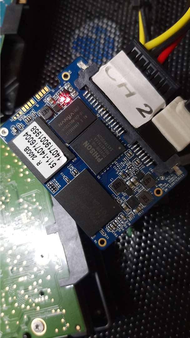

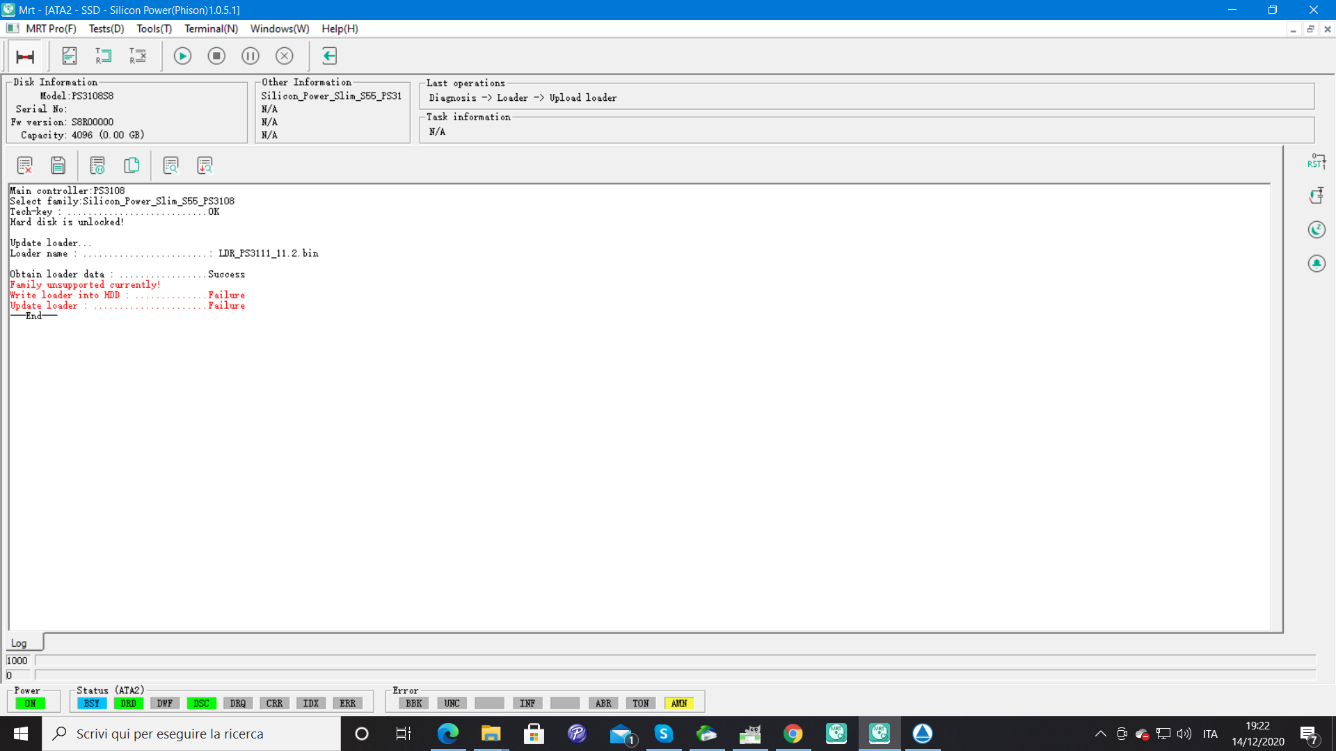

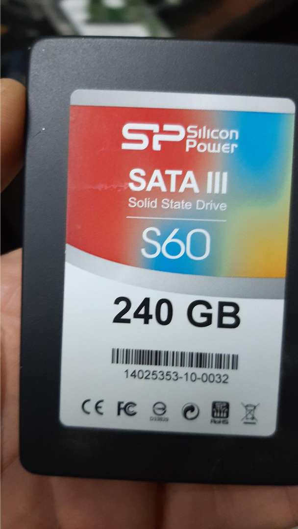

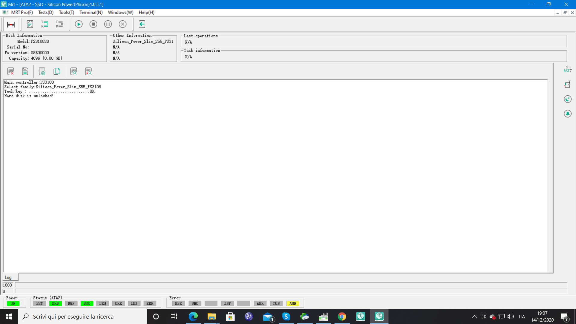

hello guys, this ssd arrived last night and it is not recognized, in mrt I see 0 Gb. I have performed the procedure to load a loader but while selecting the right controller mrt returns an error, as if the chip was incompatible. If I select start safe mode mrt says it is already in safe mode so I don't understand why it doesn't load loader. I tried to do some shortpin but nothing changes. Has anyone had experience with this model before? Thank you all

Loader name: LDR_PS3111_11.2.bin
I have never worked with an MRT. But you definitely chose the loader incorrectly.

That's probably because you're trying to kickstart a 3108 with loader for 3111.

i pointed this out to mrt but they say the loader is universal. I'm disoriented

How can it be universal? 3108 and 3111 have significant differences in their fw functions.
Also how do they explain this?
I think they're talking nonsense.
If you wish, send me the drive and I'll have a look.
