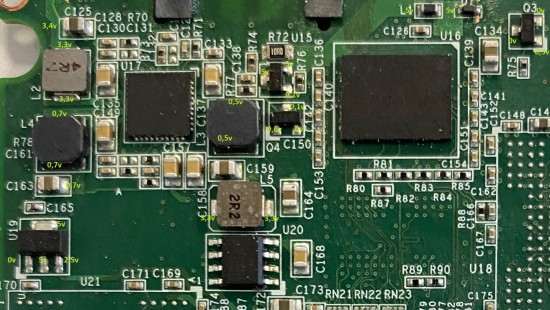

thanks for your reply.
Below a photo with some measurements:
 Post subject: Re: Help with OCZ ARC100 120GB ssd water damaged
PostPosted: September 16th, 2024, 10:30
Posts: 1305
Things look in general, low by about 0.2v , but I doubt that's your issue. What the current draw like ?
PostPosted: September 16th, 2024, 14:42
Posts: 17096
R72 (10R0) has 5V on one side and 1.6V on the other. This means that it would be dissipating 1W. Also, the resistance between ground and the 1.6V side of the resistor would be 5 ohms. Clearly something is amiss here. I would measure the resistance of R72, and check for 5 ohms to ground.

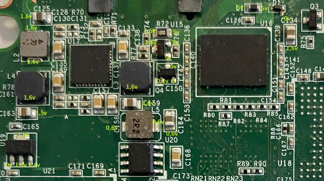

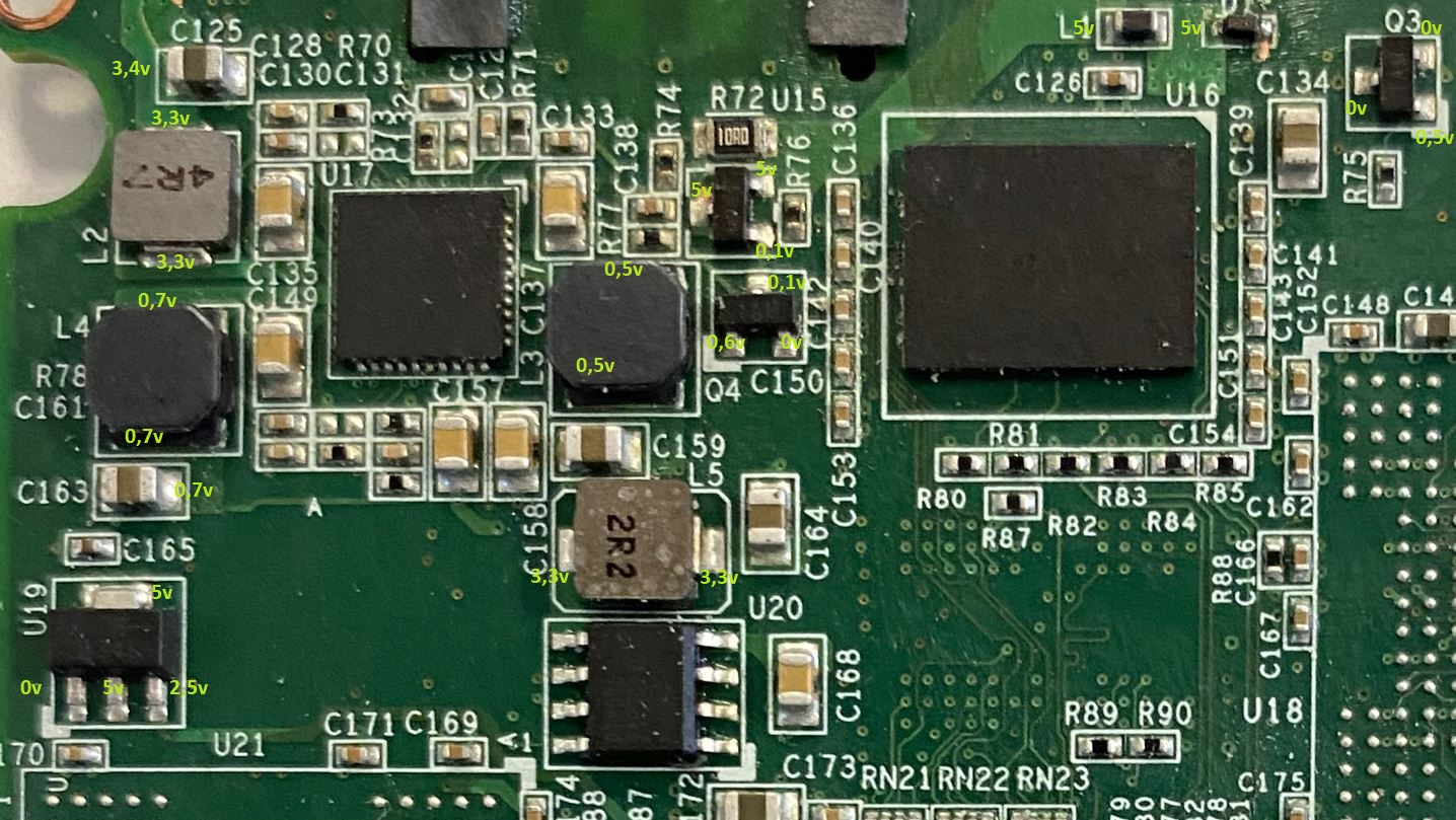

PostPosted: September 17th, 2024, 5:14
Joined: September 9th, 2020, 8:51
Posts: 44
first of all thanks for your reply.
Lardman wrote:
Check the caps around the nand for voltage
The caps seem to be good
This is my theory, but ICBW.
I believe that Q24, U15 and R72 constitute a soft-start circuit. Initially after power-on, the SSD receives its 5V supply via R72. This 10-ohm resistor provides inrush current limiting.
The 3 DC-DC converters (U17, U19, U20) then power up partially, providing some power to the flash controller's IO section. A signal from this section then switches on the base of Q24, which then switches on U15, which in turn shunts R72. The 3 converters then receive a full 5V supply via U15 and then begin regulating at their specified voltages.
In the present case Q24 is not being switched on, so this would suggest that the flash controller may be dead.
If you wish to bypass the soft start, replace R72 with a shorting link, or flow a blob of solder over it. Of course, test for shorts before considering this approach.
I tried to bypass the soft start as your suggestion and this is the situation:
PostPosted: September 17th, 2024, 5:25
Posts: 17096
L3 and L4 don't seem right. At least one of them must be Vcore. What resistance do you measure between ground and each of L3 and L4?
PostPosted: September 17th, 2024, 13:13
Posts: 17096

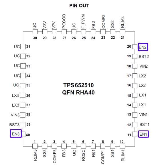

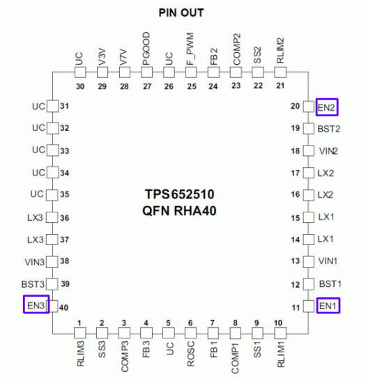

Check the EN1, EN2 and EN3 pins. They should all be high.
https://www.ti.com/lit/ds/symlink/tps652510.pdf

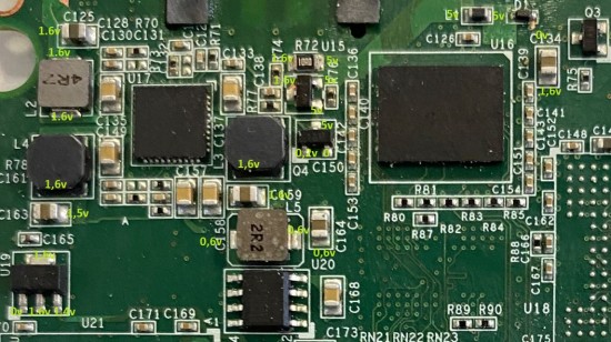

PostPosted: September 18th, 2024, 4:18
Posts: 44
EN1 -> 2,5V
EN2 -> 0,09V
EN3 -> 2,1V
PostPosted: September 18th, 2024, 5:35
Posts: 17096
It appears that buck regulator #2 is not being turned on. One of the other regulators (L3) is enabled but has no output or an output which is too low, so it is either faulty or overloaded.
