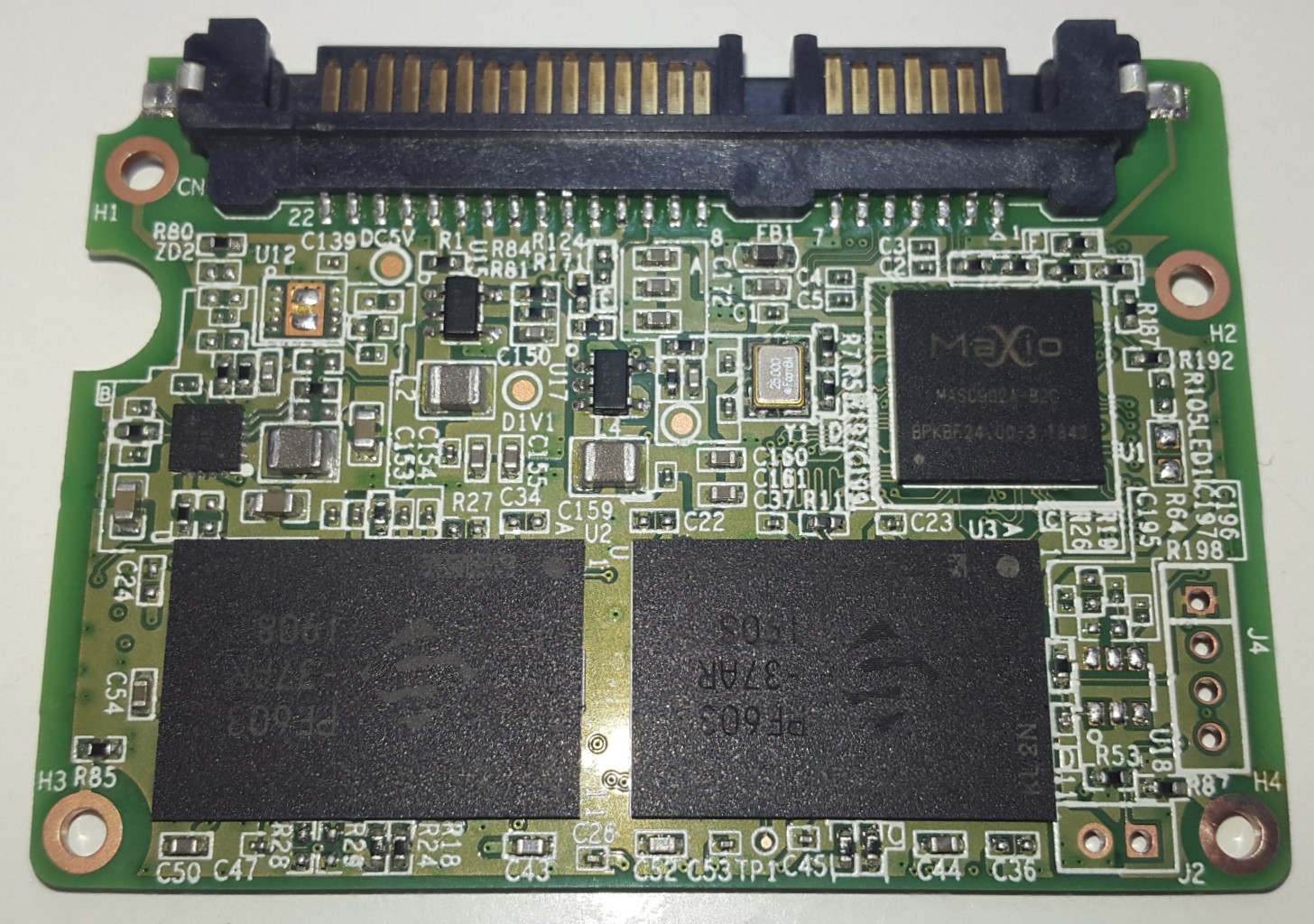

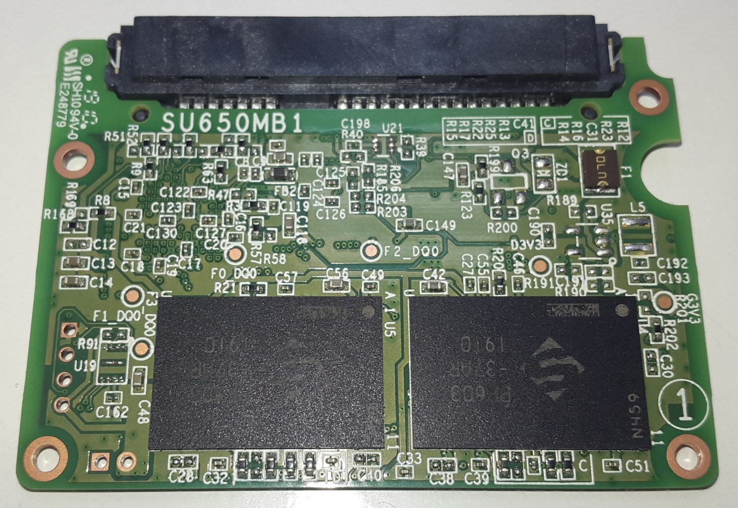

Right now i have an Adata SU650 with Maxio MAS0902A-B2C. Normal mode gets BSY. Can enter safe mode either by shorting point or lowering voltage on NAND but it's unsupported by acelab.
Also it's different from the one here: https://forum.acelaboratory.com/viewtopic.php?t=10173

Here are the ssd pictures.

If all you want to do is to reach safe mode, then you can probably get there by disabling the NAND Vcc regulator via its Enable pin. Otherwise you could ground the NAND R/B* pin, if you can locate it.
