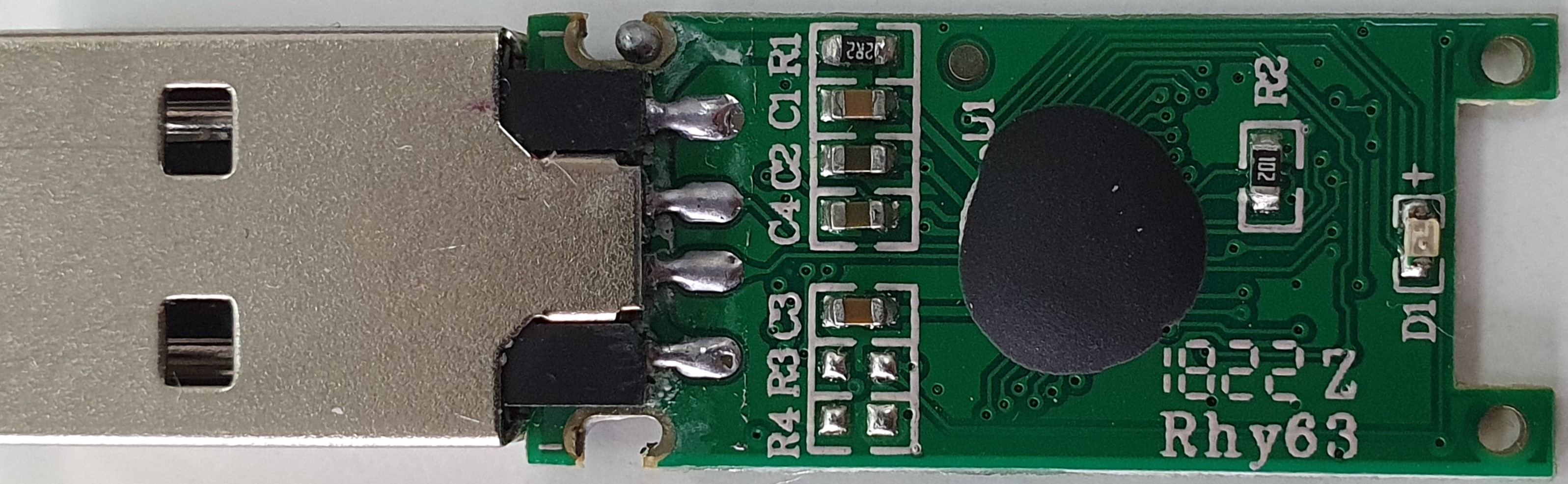

Does anyone know pinout for this chip?
Thank you.

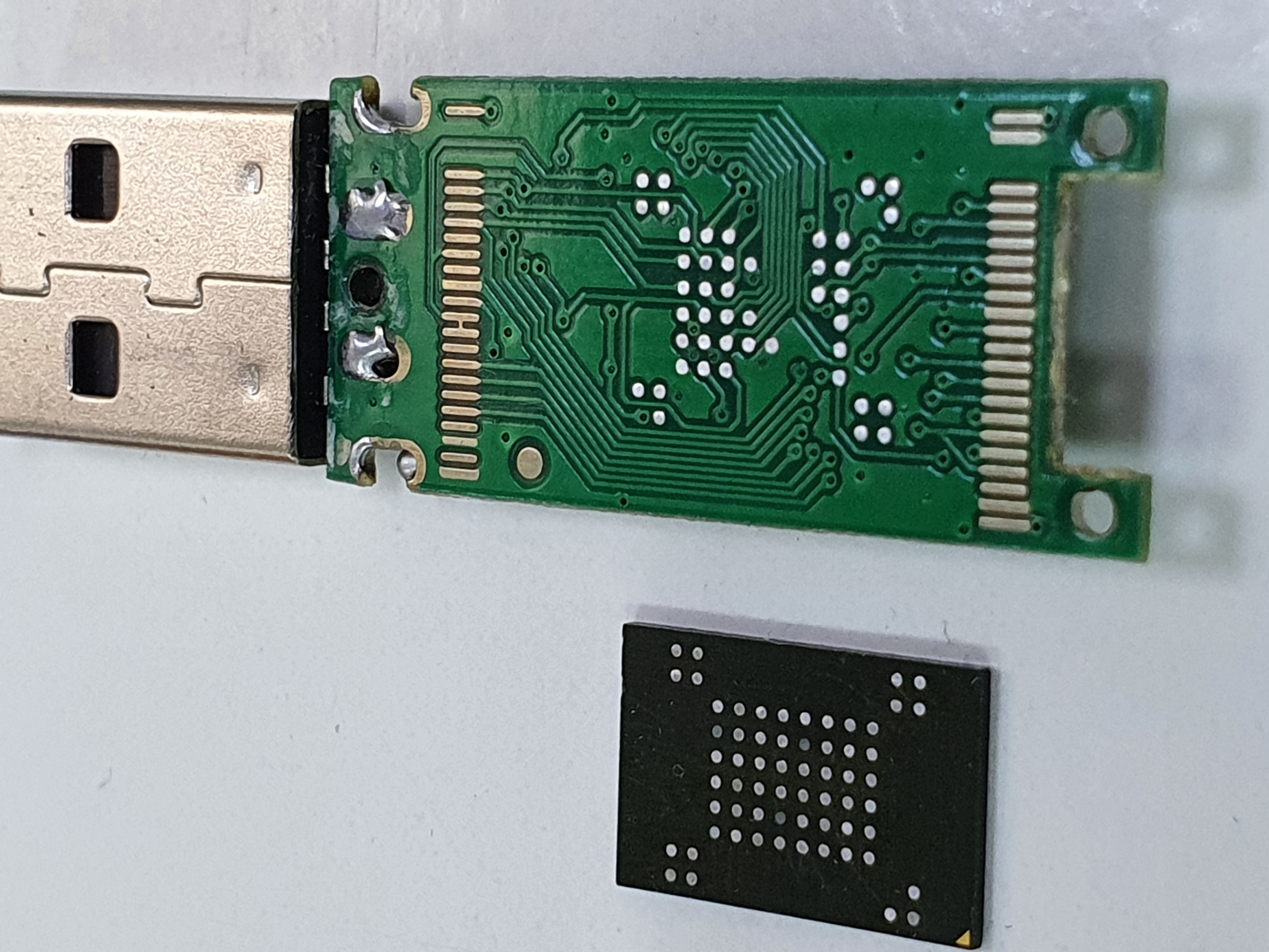

Can't you work it out from the TSOP-48 pinout, assuming it follows the ONFI standard?
Wouldn't it have been better to leave the chip in place and wire up a TSOP-48 adapter?
 Post subject: Re: NoName USB drive.
PostPosted: January 26th, 2021, 16:28
Posts: 925
Its' BGA-63. 10 seconds search at google for pinout.

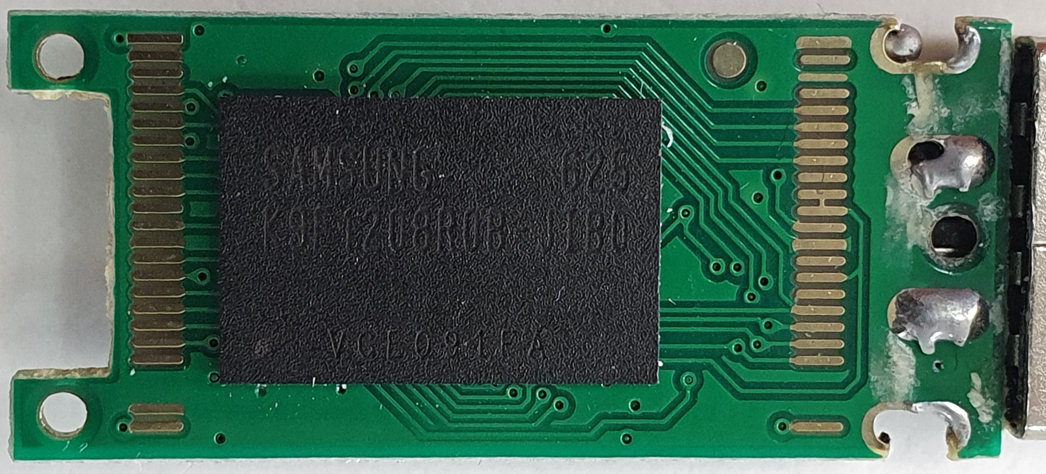

you would usually add a pic of the other side of the chip as well. or at least the Mark Code

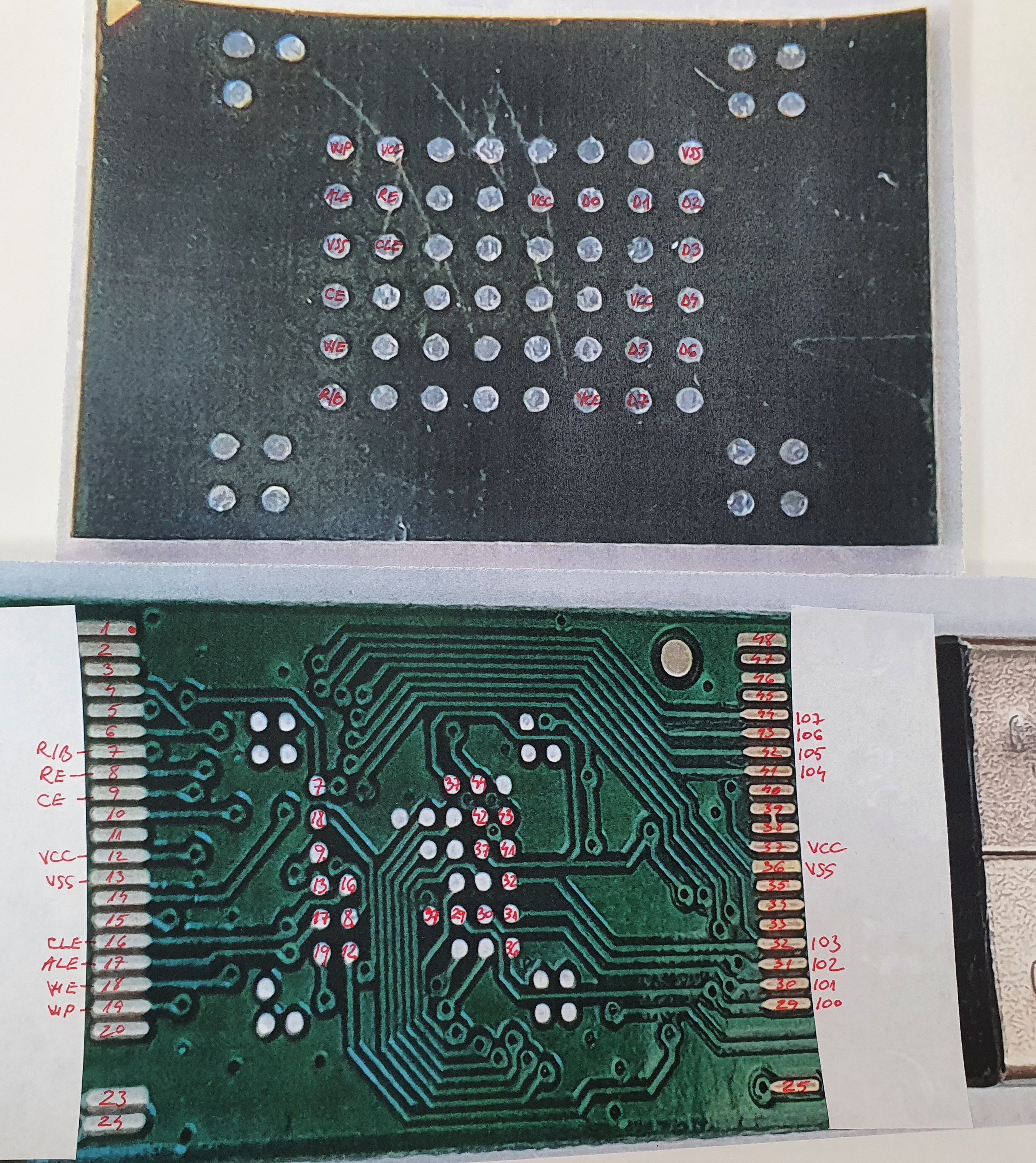

Yes I worked it out of TSOP-48 pinout. Here is it:
No because it has a COB controller. Picture bellow.
Thank you arvika. I never had BGA-63. I found pinout in ONFI file but pinout is upside down which kind of confused me.

that's useful too, but I really meant the NAND chip. Sometimes with unfamiliar chips, if you search the part number/mark Code, you will find a datasheet or other info.
Anyway, looks like you are on the way now. Good Luck with the recovery. Please post back with the NAND ID, and what the controller turns out to be if possible!
Chip is Samsung K9F1208R0B.
Datasheet: https://datasheetspdf.com/pdf-file/2648 ... F1208R0B/1

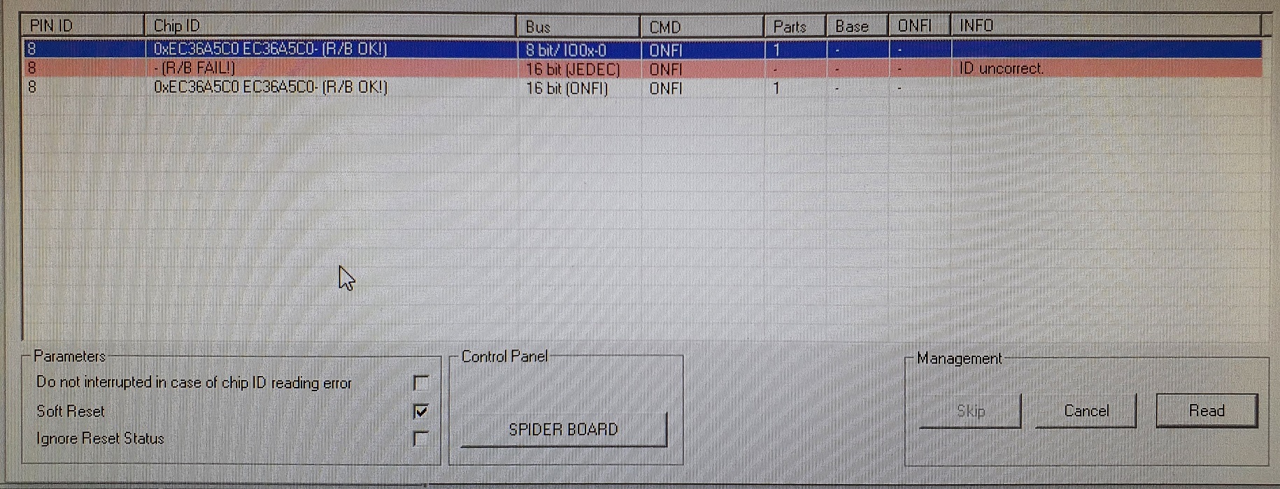

Chip ID is: EC 36 A5 C0
Pretty much game over, because Acelab does not have this chip and I don't know how to add it.

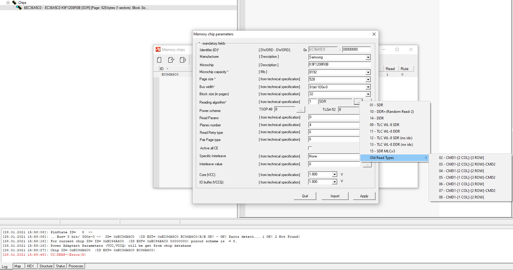

also this is a 1.8v chip (ace may have sorted this out for you - I don't know their reader)
you should be able to read it by using this as a starting point:

I tried to add the chip myself with the help of the chip config print screen you attached and the datasheet. All It reads is FF FF. I'm not sure what reading algorithm should i use. Or I did something wrong.
Roman at Acelab said:
"Well, it's not a ONFI chip, and not a JDEC.
It's internal Samsung development. This chip is very-very tricky - it reads all sectors by 3 commands;
Command 00 read first 256 bytes
Command 01 read second 256 bytes
Command 50 reads the rest 16 bytes
Command 00 - is a basic command for NAND reading, while commands 01 and 50 are optional and belongs only for this chip. They are not in used and usually you can meet them in very old flash drive where the memory chip was even not a classic NAND Flash (something between NOR and NAND technology)
I'm afraid, existing tools can't read it."
