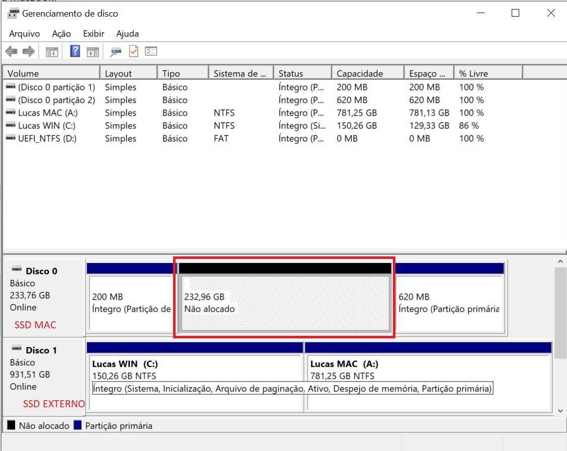

I have an early 2013 macbook pro, with 256ssd, and I'm running windows through an external drive too. I accidentaly deleted the main volume of my macbook in windows disk manager.

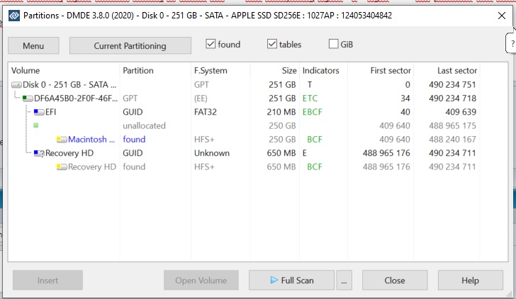

The partition was in HFS+ because of macOS, so I'm using DMDE to recover the files. DMDE is showing the partition as found and unallocated. Just opening the volume seems to show me all my files so I copied everything to the external drive, got a little naming problem with some "/" but it's ok.
I had 220gb used in the 256gb drive, DMDE is showing me 199gb of recovered files. I've looked in the folders and all my important files seems to be there, should I run a Full Scan?
My main question: Can I get the partition working again without having to install the OS and everything again? if I right click the partition and choose "Insert the Partition (Undelete)" will it work?
Here's a picture of my partitions screen:
and my disk manager screen:

Hi. Yes insert the Macintosh found partition and apply the changes. Also make sure you keep a copy of the current partitioning on a second device and you should be good to go.
